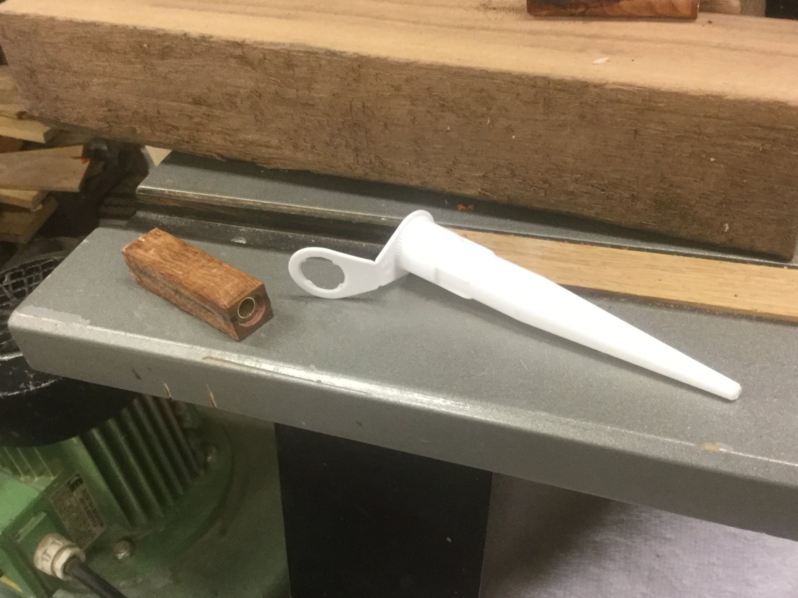

Just a quick idea that occurred to me tonight. I made a tapered tool from HDPE to make inserting tubes into blanks easier but then was looking at a mastic gun and realised the nozzle wou"d be perfect for the job.

I made a brass one and use nail and centre punches as well as the tube you use. Depending on the pen kit I am using and I refer to the Slimline with Streamline Centre band it allows me to use a close fitting one as a go no go guage that i then chuck those brasses that are too tight.

if you,chuck a piece of hdpe it will turn with SHARP roughing gouge and the. skew chisel. That's how I made mine. Never thought of putting steps on it but could do that using a parting tool. The nozzle just pushes in and covers upto about 15mm internal diameter, might even hold 5/8 internal, haven't any tubes that big !

I use a large tapered chopstick for 7mm and 8mm, and a pair of the shorter disposable ones (that come attached at the end) for larger tubes.

Sorry, forgot to check for replies. Thank you Gentlemen. I believe I can make my own from HDPE. Does not to be made from metal.
My desire for wanting the steps is to get away from the taper to eliminate any possible flaring of the tube resulting in an ill fit.

the HDPE shouldn't flare the tube as it's fairly malleable. With stepped tool i would be worried about it not gripping any slightly out of spec tubes as I like to rotate the tubes on insertion and work them back and forth to ensure good glue coverage. Big plus of HDPE is it will grip slightly in the tube and it is easy wipe as epoxy, CA even polyurethane glues don't stick to it.
