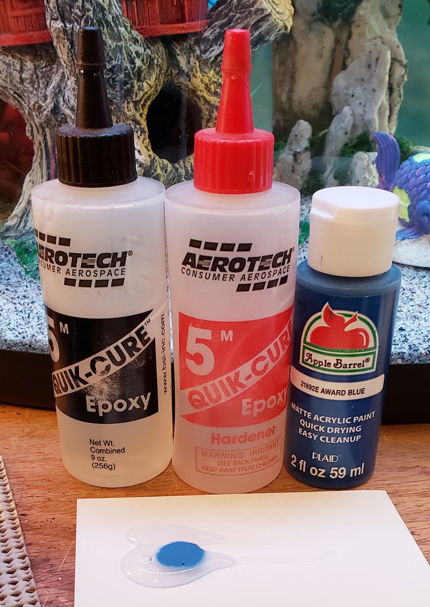

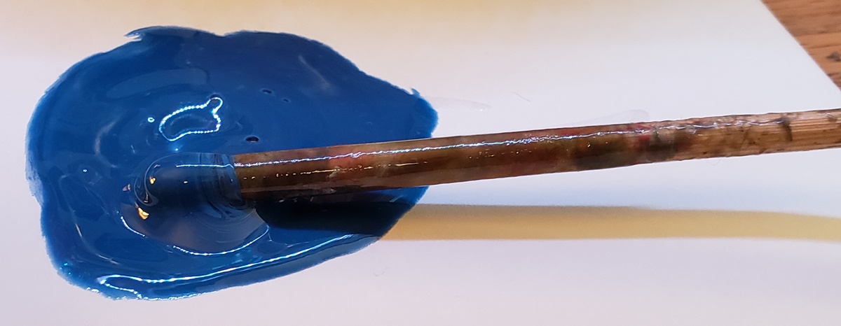

I use acrylic artist paint for coloring epoxy. 50 cents at Walmart.
Not to hijack this, but I've wondered about tinting like this and haven't asked about it yet since I don't work with a lot of "plastic" blanks. I would guess it's still recommended to paint the tubes, too? Does the acrylic paint work well for the tubes and stay put when glueing?

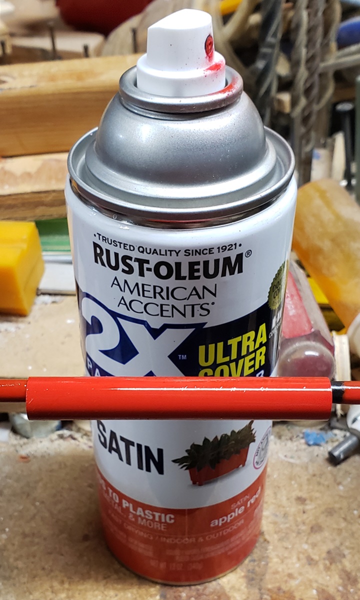

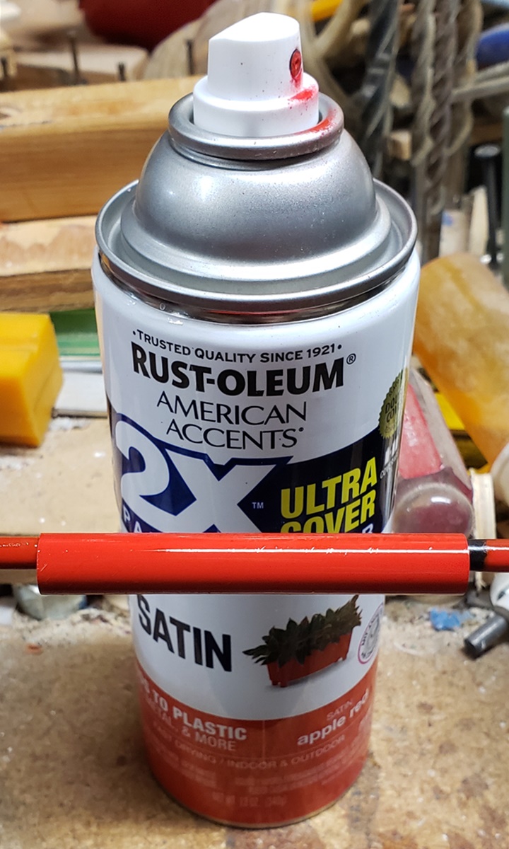

I use spray enamel for the tubes.
