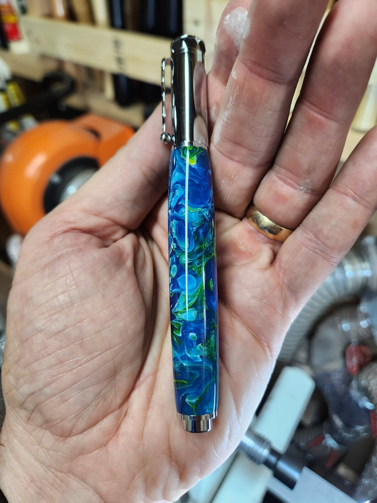

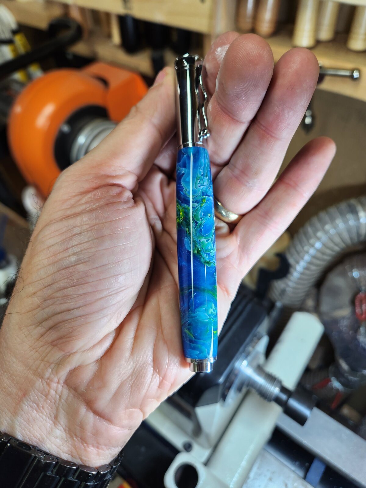

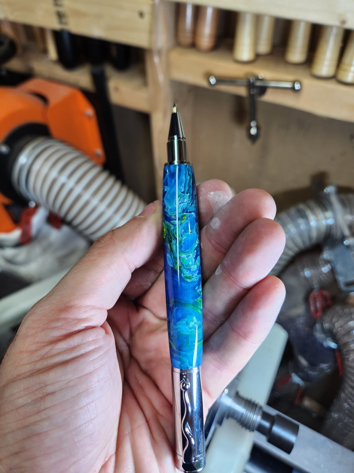

Never tried this material before, so why not give it a go. It definitely has a funky smell to it, not necessarily in a bad way, more of a hmm, what am I getting dosed with way. Ocean Mist blank from woodturningz, magnetic rollerball from Crooked Mill.
I read quite a few posts here on the forum with several suggestions, and it went pretty well using a round reverse rake carbide canted at 45 or so degrees and going at a high speed with very little pressure. Painted the inside of the blank with blue india ink just in case. Pardon the reflection of the overhead shop light.
That's beautiful! I'm going to say that your choice of paint worked since the narrower ends don't appear lighter/thinner than the rest of the barrel. Great finish, too.
