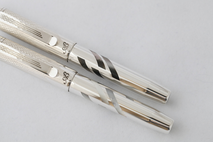

This post is a long time coming and rather than wait another couple months I hazard to show the half-way done part. My caveat here is that the "fit" is good but the "finish" will improve when I get finished. Getting this far with this new process took months in itself.
I have long been wanting to do some more exotic inlay work and to do that I settled on the EDM process. The reason is that I wanted to create sharp inside corners - sharper than what can be done with even the very smallest end mills. Die sinking EDM is the ticket to this goal. Another possible method would be using a shaper or adapting the slotting head I have for the mill but shaping requires secure workholding (read "clamping") because there is pressure put on the workpiece. I have small and thin pieces I want to work with downstream and and clamping these things down to enable mechanical metal removal could very well be problematic. EDM does not put pressure on the workpiece and it's easier; you just make the electrode and then make the hole. Well, not always quite that easy.

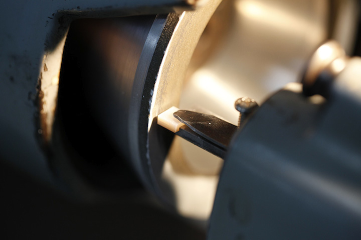

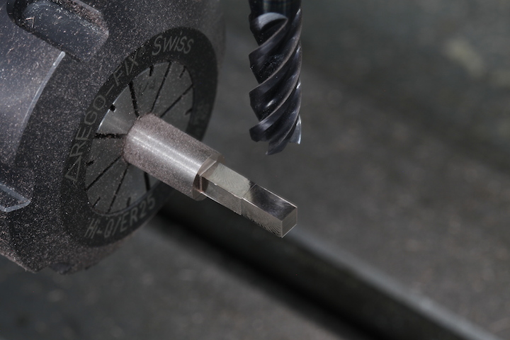

In order to make these holes I needed to make an electrode in the shape I needed - a square. Electrodes can be made from just about conductive material but the common materials are copper, copper-tungsten, and graphite. My teacher eschews graphite so I used some scrap copper-tungsten (WCu) to make my square electrode.
Making EDM electrodes is a challenge in itself because of the accuracy and precision required. It was required that I make a square accurate to ±.0005 of my declared dimension which was a 6mm square (yeah, I'm mixing units). The precision of the milling needed to be about half of that; in other words no excursion while milling. On top of that I needed to make two different sized squares - one for the "roughing" operation which would make my square hole slightly undersized and with slightly rounded corners and then a "finishing" square which would take off a tiny bit more to get my final 6mm dimension and to square up the corners.

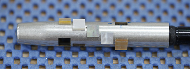

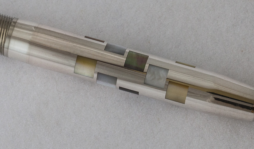

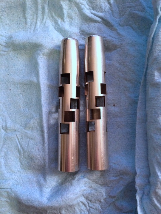

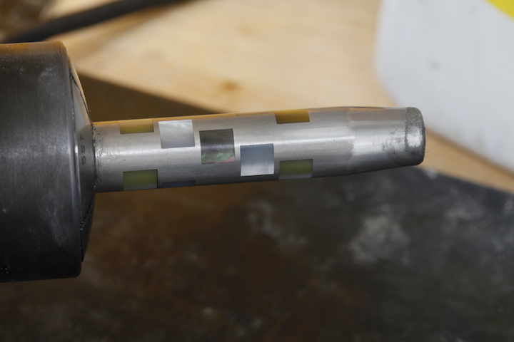

OK, electrodes made so now to burn the holes. I lightly clamped the barrel in a dividing head and set that up in the EDM tank so that the electrode would meet it at the right angle. The dividing head was used to get the spirals evenly spaced aroung the circumference. Actually a simple spin indexer would have been easier to deal with. Each hole took about 15 minutes to do.

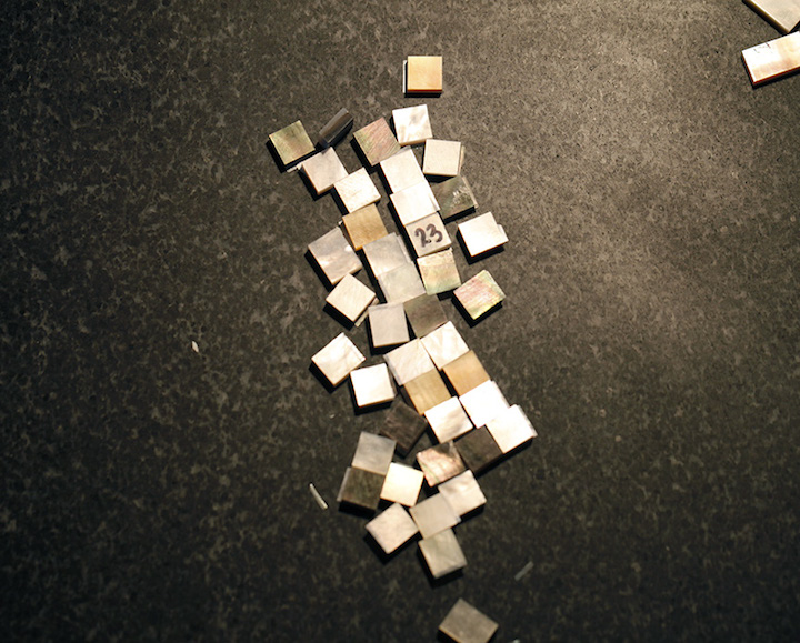

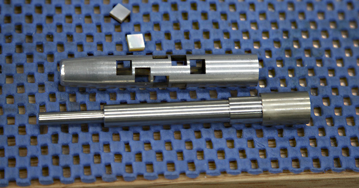

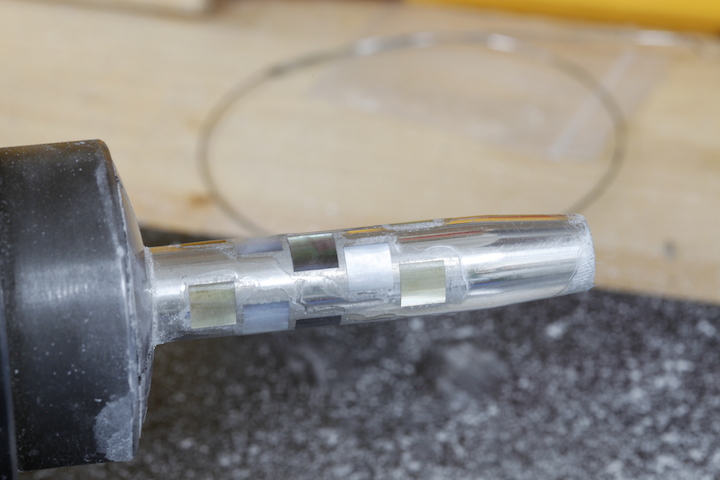

Barrels made - returned back home from Texas. Now I need to make the square inlays and I did that out of my current favorite inly material: mother of pearl (MOP). I got three colors of that from knifehandles.com - white, black-lip, and gold-lip. I used a tool and cutter grinder to cut rough squares and I used a different version of the same to grind them precisely to size. I had to make a special tool to hold each square so that the grind would be square on all three axes. he tool shown has a precise 5mm square recess to hold the rough MOP square and you can see the spring used to hold it down. By the way, I fashioned the spring out of a scrap piece of 1095 steel that I had to initially anneal, then shape, then heat to critical temp, quench, and finally temper to spring hardness.

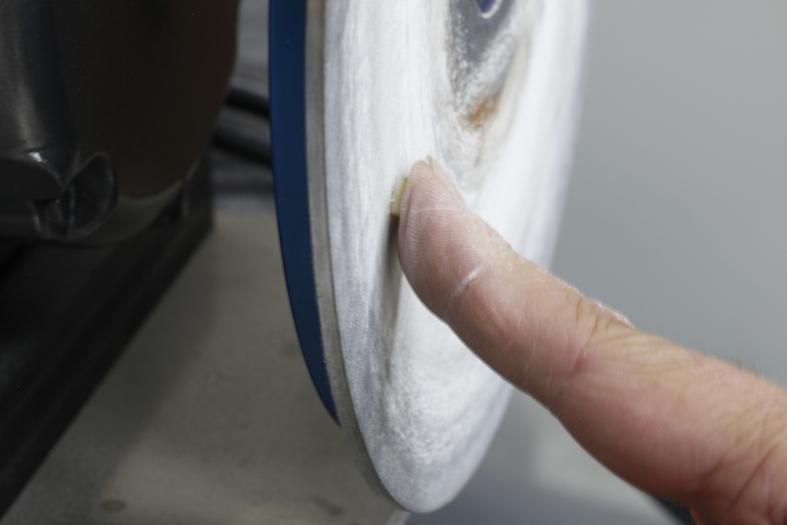

Most of the MOP pieces were too thick so you can see the manual method of thinning them down using my finger to hold them agains a slow spinning flat sanding wheel. Each piece was then fit into one of the holes in the barrel, glued in, and then the high parts were filed and sanded off to be flush with the silver surface. Another tool I had to make was a mandrel that would just slip inside the barrel that had a surface to prevent the MOP squares from just falling through.

Pic 1: machining the WCu electrode

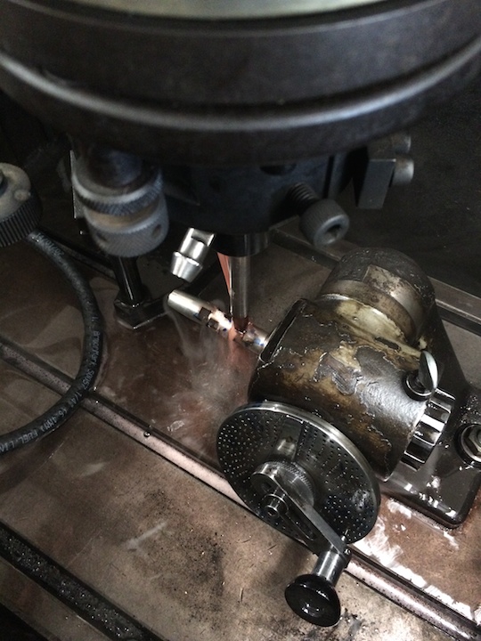

Pic 2: "sinking" the square holes. Typically EDM work is done submerged in a dielectric fluid (oil) but for fun and picture taking this setup just kept a flood of the fluid going so the spark erosion could happen.
Pic 3: the two barrels with nice square holes in them
Pic 4: a bunch of rough square MOP pieces

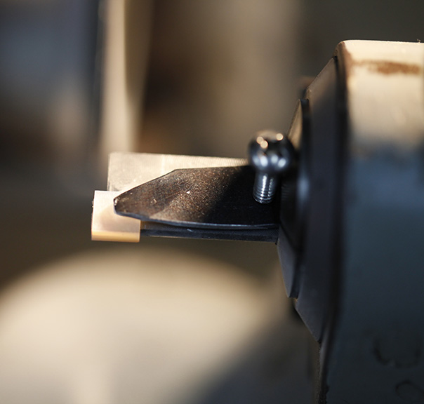

Pic 5: the MOP square special custom holder tool
Pic 6: using a diamond wheel on a tool and cutter grinder to square and size up the MOP squares. Too many "squares."
Pic 7: "finger" grinding to thin the MOP squares

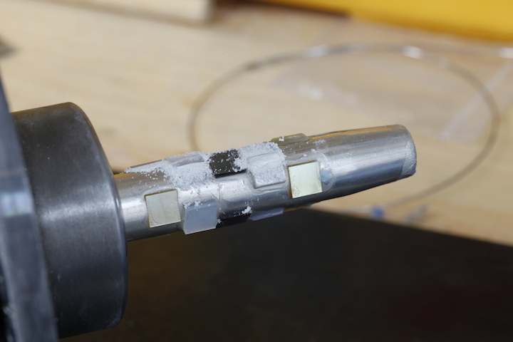

Pic 8: Mandrel used to position (for depth) the squares in the holes
Pic 9: trial layout
Pic 10: all glued in
Pic 11: filing off high points
Pic 12: finish sanding

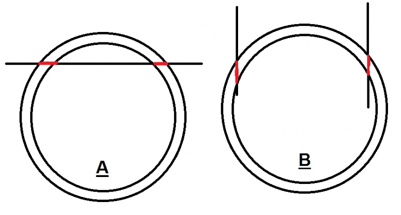

Rich, please can I ask a couple of (probably) daft questions?
Looking at my quick sketch, a milled cut across the blank could create something like the left image (A). But I assume that your method is sort of a 'plunge' cut like (B)?
The red lines plus the arc of the tube would be your glue surface?
By my logic, a milled cut glue line won't allow the inlay to be accidently pressed into the barrel. The glue is really just holding the inlay in place and the horizontal flat is providing the mechanical strength. If the glue line is completely vertical ( as in B ) are you relying on the glue for mechanical strength?
I can see that a horizontal milled cut may allow the 'flat' of the barrel to be seen through the very thing layer of MOP though.
Using either method, unless you curve the inside of the MOP, is there enough space down the tube to take the ink reservoir / converter once the inlays have been glued in?:confused:

Thanks for the questions!

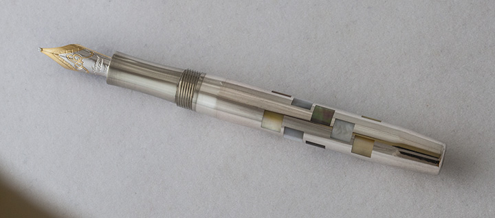

They are plunge cuts to minimize the thinness (maximize thickness?) of the MOP edge. To make a 6mm square inlay on a 1/2 inch (mixing units again, but those are the sizes I'm dealing with) diameter barrel would produce, in my opinion, edges that would be too thin and prone to chipping. With a plunge cut the edges are 90º perpendicular to the axis and greater than that parallel to the axis.
The pen in this picture has inlays done with a milled cut but the depth is significant thus keeping the edge not so thin.
The 6mm squares don't go in so far to prevent the converter from entering the barrel but I do a bit more "reaming" just to keep the inside cleaner. That was the purpose of the mandrel to limit inlay depth. I also fill the inside with epoxy and then drill out the excess leaving a layer of resin to help with the mechanical support you suggest.
One approach I thought I might try but discarded is to not burn quite all the way through thus leaving a thin but substantial enough shelf on two sides to provide backside support for the inlay. The difficulty in that is multiple finishing burns would be necessary to get the internal bottom angle of a semi-blind hole square enough to make the effort worthwhile. That was a time and effort vs expediency/impatience decision. Plus I've not had a problem with inlays coming out with my methods that include the internal epoxy.
