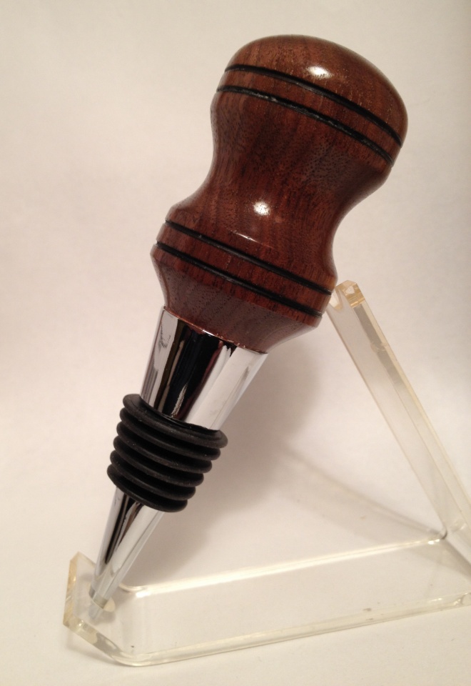

Trying out my wire burners for the first time

Walnut on a chrome stopper

Bob...Super nice stopper!!! Great finish and nice wire burnt detail lines!!! Will make a wonderful stopper to show off your nice bottle of wine or olive oil... Give us a few details on how you made your 'wire burner' so we tooo may profit from your handiwork!!! Thanks for sharing and safe turning to you!

That looks good. I haven't tried veneer. I have some piano wire with scraps of blanks on each end. Kinda like what was used on Luca Brasi in the Godfather.
