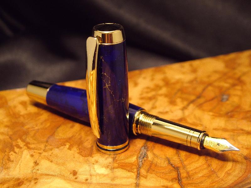

Had some trouble with assembly, the harder TruStone blanks
need a gentle hand when press fitting the parts or they can
get stress marks. But they cut nice with sharp tools and polish
up like a dream.
Nothing special about the pen, simple lines and inexpensive kit.
But I couldn't wait to try out the blanks. I immediately ordered
ten more.
Kudos to Richard (randbcrafts) for great blanks, fast turnaround,
excellent communication and great prices.
Yeah, this was a shameless plug, but I was treated right.

Charlie; Excellent work; I have made a few of these in a Sierra. Very hard!
With hard / brittle material I sometimes "expand" the blank ends so they are a slip fit for the fittings and then CA or Epoxy the fittings in. Use a Transfer Punch set and put the end of the punch just inside the tube. Twist sideways (gently) until the fittings just slide in. Check bushings and make up any difference with thin shim stock. I just hate that "pop" sound when pressing in the fittings.

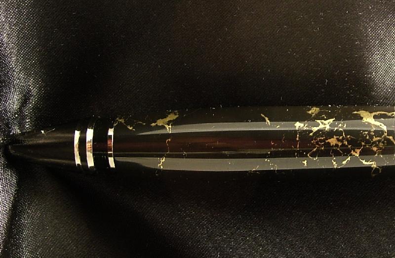

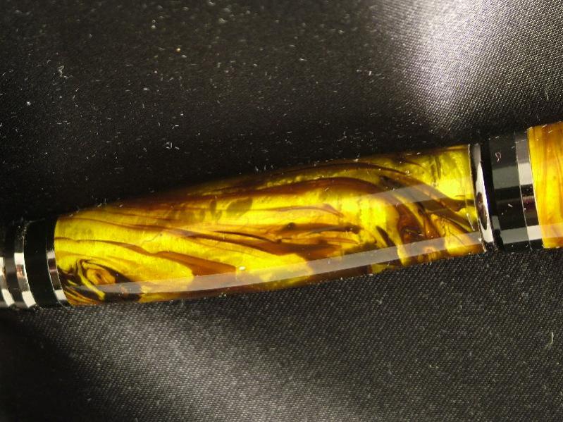

Here's a couple more I've tried today. Just realized how dusty the
cubelite was .. the pens need some Cling Free :biggrin:
Both are Tru-Stone
The tortoise needs some work. I'm not sure if I should color the tubes
white or black. White might ruin the look, and black might make them
too dark to see. I'm not sure yet.
You can see the glue behind the gold areas, and you can see the
sanding scratches on the tubes.
The other one is black with gold matrix.
