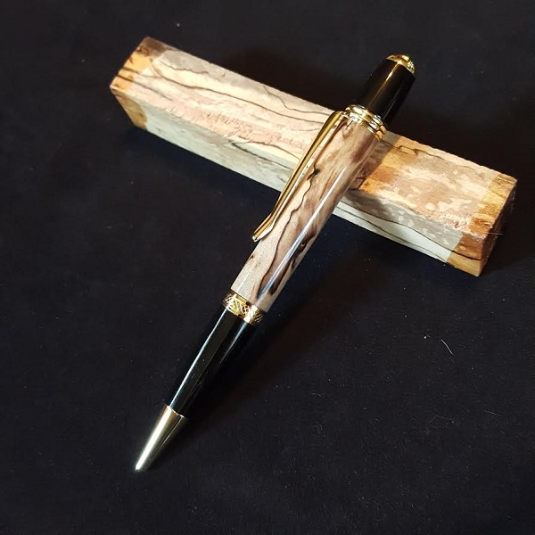

I tried pen turning awhile back and just couldn't get the hang of it or at least couldn't make mine look anything like you guys. I gave up for awhile but decided to go back and practice some of the pointers on this site and watched a bunch of videos. Practiced on scrap wood with the skew and im trying to get my finish to improve. This is my best so far. Thanks for all the information

James, from the photo you have spent some valuable time reading, watching and absorbing information and now it is transforming into a professional looking product. I like the shape of the barrel for that kit. The finish looks very good. The fitting of the parts look very good. I say you are well on your way.
Now with that said there still will be those off days and we all have them no matter how long you do this. Shake it off and use it as another learning tool. Run into problems just jump on here and someone will help you through it. It is a fun hobby but can also be humbling. But when others start liking what you are doing is a great feeling. keep up the great work and look forward to seeing more.
Great looking pen, James. I turn on a daily basis and still haven't mastered the skew. It's getting better. Practice makes perfect right. keep up the good work.
Pen looks great James! As John said above, your reading & watching has paid off. Pen looks professional--fit & finish all look very good.
VERY NICE! I have been at this for almost 2 years and still have a lot to learn. Don't let a mistake or a difficult project discourage you. Learn from it and keep trying. I had one today chip out at the end when I was taking it off the lathe. Now I'm trying to figure out how to save it....
Looks good to me and too a lot of other people from reading the replies. This fit looks spot on, you picked a nice blank and the finish is great. Good job.
James, you know that practice improves performance. You can't learn from a "lucky" success. The frustrations and problems, and solutions, and lessons that we learn from mistakes and disaster makes us all more skilled as craftsman and artists. We see that you can do beautiful work...now go out and take risks.
I'll definitely say that practicing with the skew is a great idea, but I had much more success early on by using a half-inch bowl gouge and the round nosed scraper, as those were the tools that I was able to keep the sharpest, at first, and they were the easiest for me to learn how to master. The fit and finish on that pen are excellent, so it looks like you are most definitely getting the hang of it! :)

Thanks again everyone. I may have been a little misleading in my original post when I said I have practiced on scrap wood with the skew. While this is true i'm still not accomplished enough to actually turn a pen blank with it and get the results I would like. I use a roughing gouge to get it round then switch to my Harbor Freight scraper and complete it with that. In short I bought a set of 8 tools and use two LOL
