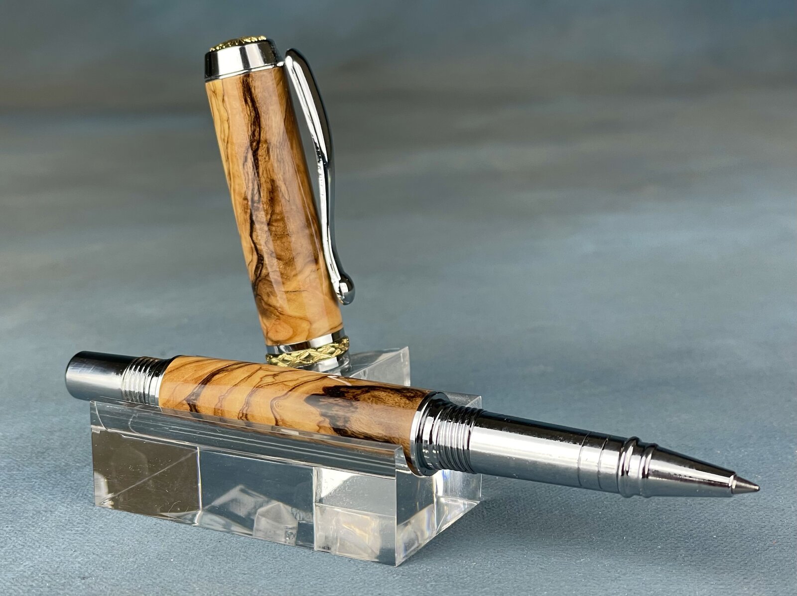

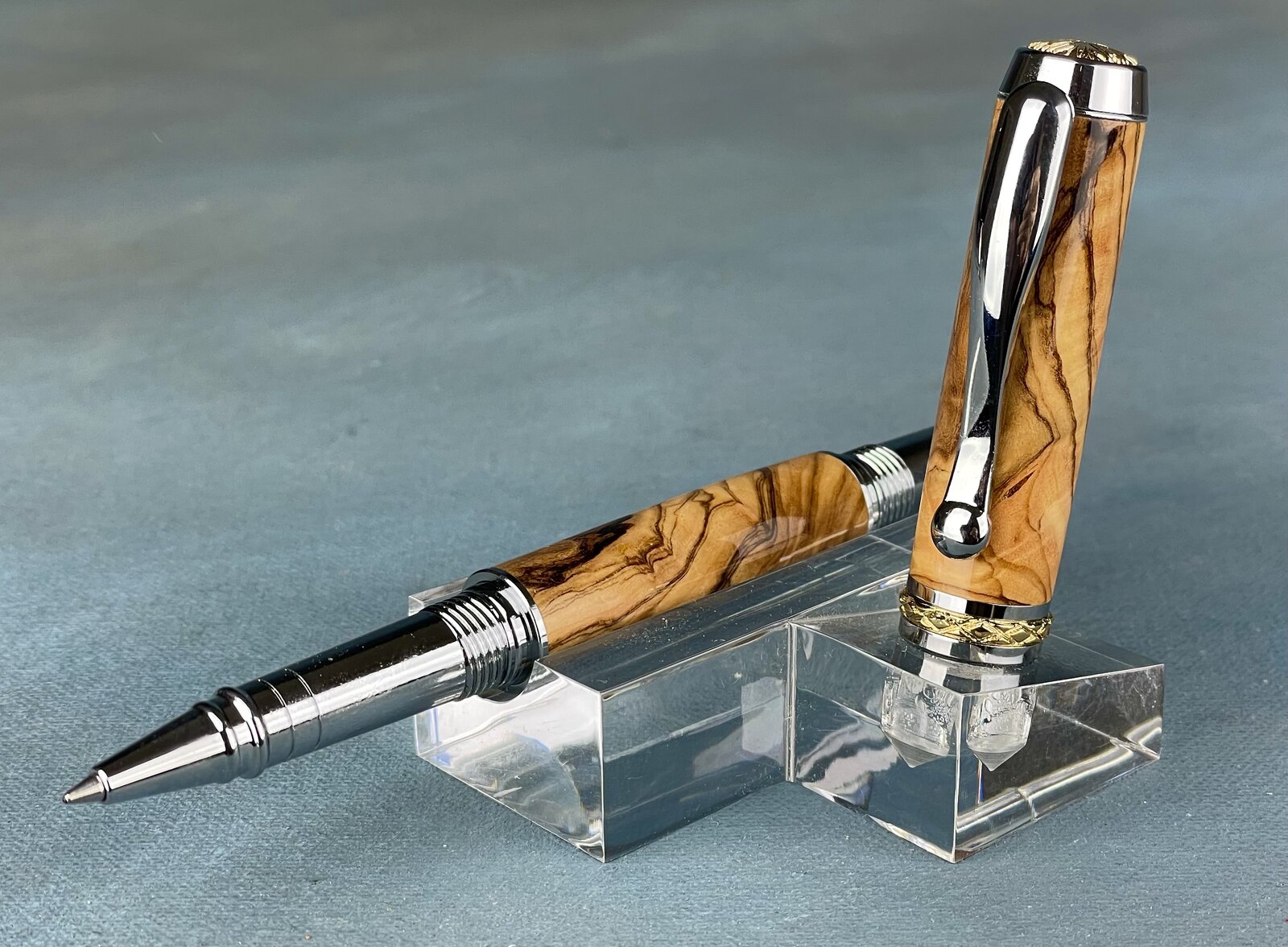

Here is a pen called a Triton made with exhibition quality Bethlehem olive wood. Blanks can be purchased from WoodTurningz.
