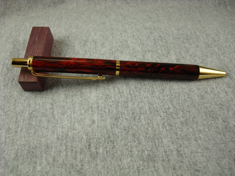

While I was waiting for a few things to come in for one of my projects I thought I would try a shot at making a blank that looks like ebonite but doesn't cost like it. It's made with alumilite clear with paint pigment cast in a PVC pipe. Please tell me what you think. I haven't seen a lot of the real stuff to have a good frame of reference. Thank you for looking.

Good looking blank,Ebonite is nice but I don't think it looks any better than your blank.
I'm kind of partial to home made stuff (shows imagination) and this is a fine example of
a pen blank thats very attractive and interesting,alot going on.
Nice work. PVC pipe??
Mark
I used PVC pipe as a mold because I had some and if you use a round mold you use about 1/3 less resin. I let it sit overnight then set it in hot water for about 30 seconds to remove the blank.
That's a really good simulation of the look. The big pro in my opinion is the improved smell. Ebonite is horrible to turn. The big con (again IMO) would be the feel of it. Ebonite has more "give" in your hand than acrylic - being rubber based it just feels different than your typical acrylic.
It is true. Ebonite does still have a softer feel and with my limited experience I think ebonite is still better for kitless work. I think it is a little less prone to breaking when dropped.
I think you did a really good job. It's impossible to match the pattern, but it's still a cool blank. And since it's alumilite, it would work well for kitless pens.
