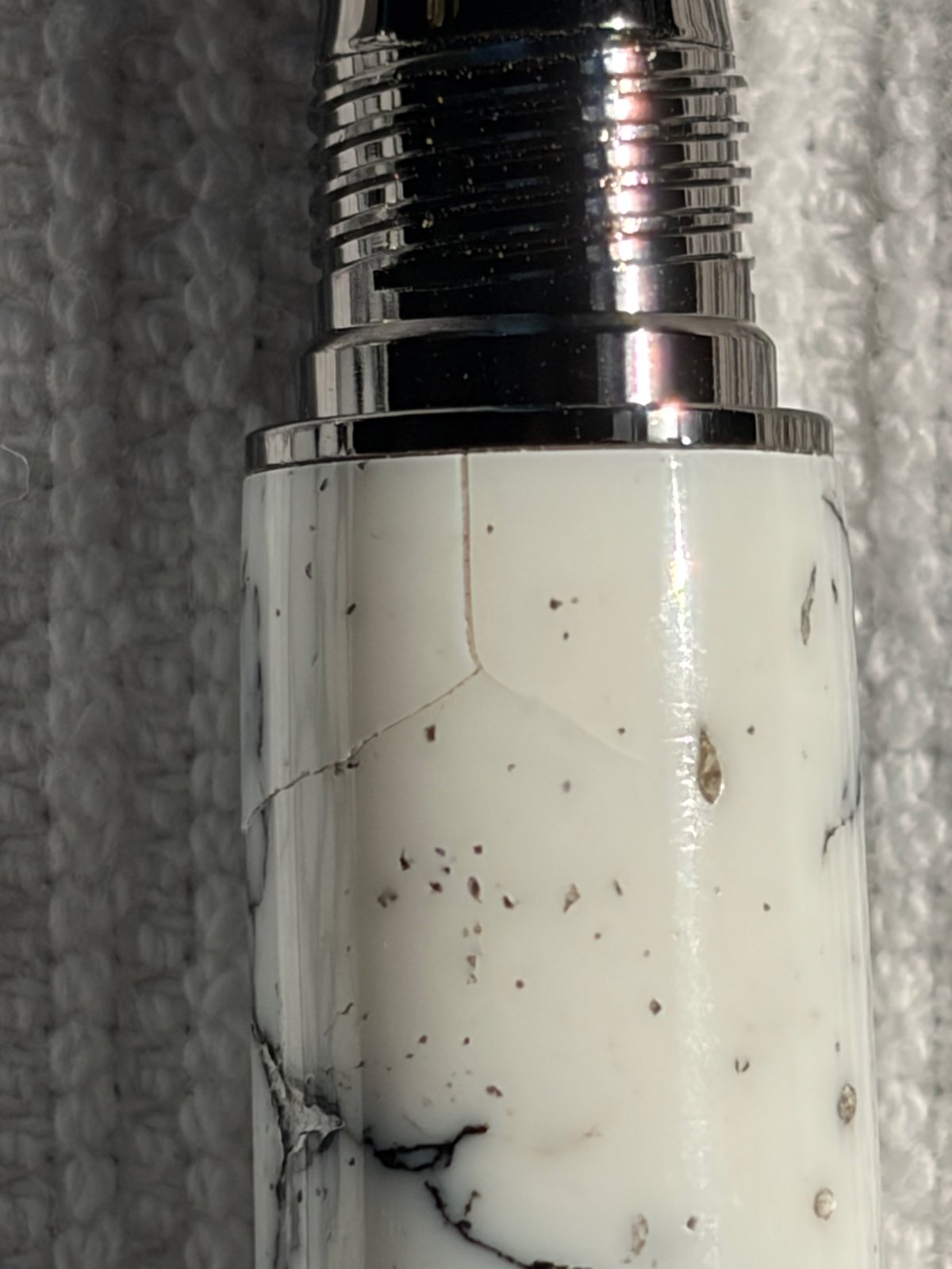

  6. Assembled the pen, the rollerball. This went fine until I saw that the material on the ends of each blank had cracked from inserting the components. Both ends of both blanks. I have one of the hand press rigs (from PSI) and have not had this issue before. Again, I was not expecting this behavior from the material. The bushings fit into the tubes just fine so I figured the couplers/cap would fit as well. Ruined the blank, the pen now goes into my 'wounded' collection to see what I can do with it later on.
Is trustone always this finicky? Small voids in the material? 'Dust/imperfections' in the open areas? Cracking when inserting components?

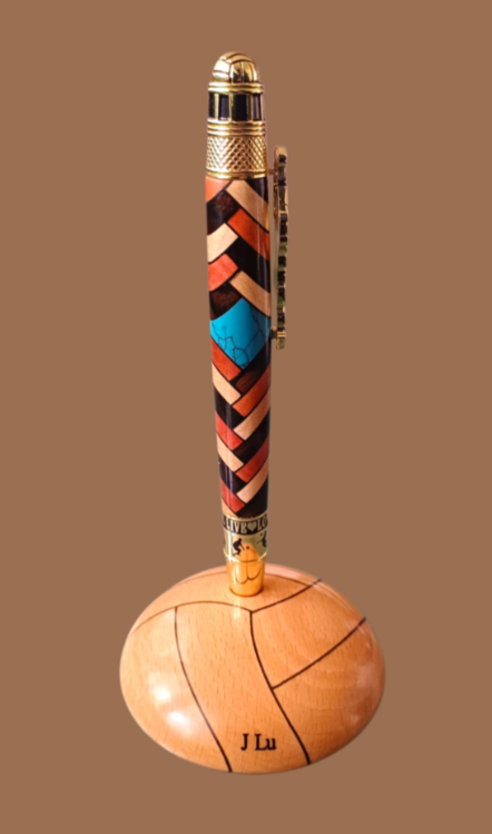

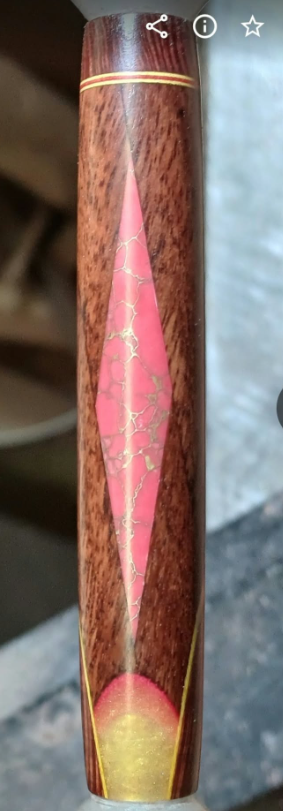

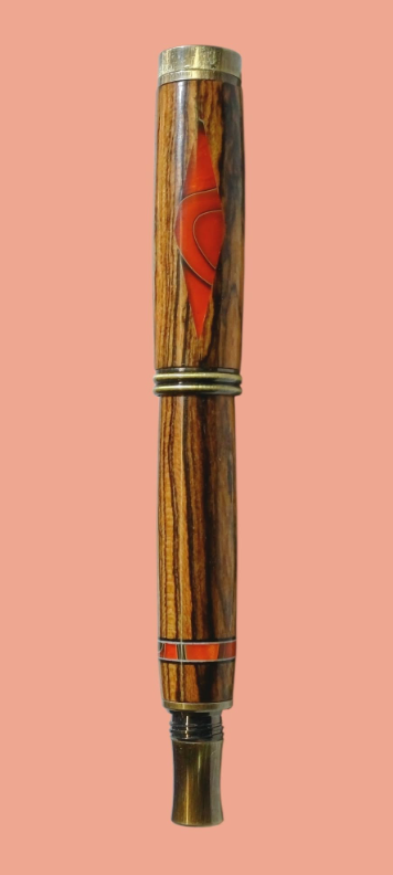

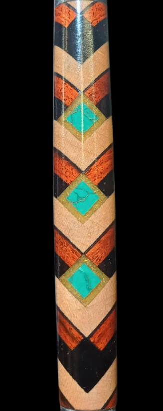

I like segmenting, so this is how I keep tru-stone away from the ends (orange is resin, just for ideas)

Round 2 - Failure.
I turned the 2nd set of Trustone blanks, that went well, finished them, and then assembled them using the PSI press. Went very slowly and gently and it all seemed to be fine. No issues anywhere. Went to get tea and come back and there is a crack at the top of the tip blank. Same as before, 1/4" vertical with a similar horizontal crack. Good news is that there weren't 4 cracks on each end of the blanks like before. Bad news is that the pen is wounded and has to be redone.
So I'm taking a break from the Trustone world. I redid the blanks (I bought an extra set of tubes when I got the kits thinking I might have issues) in amboyna and they turned out really nice. I completed the fountain pen since I hadn't done that one and as much of the rollerball as I could. I have to buy new center bands for the two rollerball kits so I can complete those kits. But, at the end of the day I will still end up with 3 Sceptre kits that will be in amboyna rather than Trustone.
