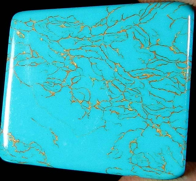

Folks,
Has anyone come up with a formula they would be willing to share for true turquoise using Alumilite white as the casting agent? I have tried a few different things, and can't get that color I'm looking for and have a banksia pod I would like to fill.
Mike B
hahaha, I was just about to post that.....
I think, its been a while, I use the white still then 2 drops of blue to one drop of yellow and cut out the green. The green was so dark it made it hard to get it right w/out adding just a touch at a time. Yellow made it a lot easier to hit my color. I keep piece of Turquoise to match up to. Just adjust it till you get what you are looking for.
