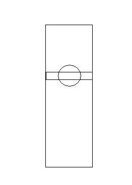

This is an idea I have thought about but never done yet you may want to try. Instead on using an actual band laminate a cigar band.
basically just cut a strip of wood that is a little wider than you saw blade and glue in in the blank. Then drill a hole in the center and turn a wooden dowel to the size of the hole and glue it in.
to make it even better do the same process again with a different colored wood and the band should have a thin outline ( this is why I said to have the band a little wider than the saw blade. I was thinking bloodwood and yellow heart.
Just a thought.

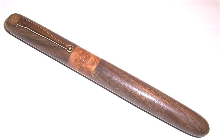

My version of the cigar for reference(no band on it though)
<b>Image Insert:</b><br />
