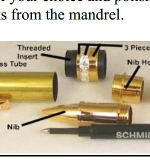

I'm having difficulties to put together threaded insert into the center band.
The only way it supposed to be inserted is the way that threaded insert will be at the end of insert ring... But it does not allow to push it in .... Instructions are talking about some kind of "wooden push block" ... but diameters of plastic insert next to thread which i'm trying to put in smaller end is not working.
Can someone come up wit clear picture? Coz instructions are not good at all.

It is not about putting it in the tube... it is about assemble threaded insert with 3-piece center band.
this is a part which does not work:
"10. Slide the gold center band base onto the black threaded insert from the small end
of the insert. The large end of the base should face the large end of the insert.
11. Using a wooden push block on top of the gold base, with a 33/64" hole drilled in
it, that's the one you used to drill the short blank with, press the gold base flush
with the large end of the threaded insert. "
What is meant by large end on threaded? and on ring? picture would speak louder than words.
Look at the good center band - one end is a bigger outside diameter, the other is smaller and the trim rings will fit over it. That's the end you to slip over the plastic insert and press flush. The left side of the pic is the small OD, the right side has not been pressed flush only slipped in. Your wood block would go on the left end and press the center band onto the threaded insert. When flush you should not see the plastic on the right hand side...

Thank Vic, it works that way.
Thanks Ed.
After I pushed everything as per Vic's suggestion I got to the point where instructions said:
"19. One other adjustment. If your pen looks like this(Image here I'm skipping)
when finished, with the nib holder showing below the center band, then place the cap
on the pen and push downward slightly to hide the nib holder."
I'd say every pen will need that adjustment, meaning that plastic threaded part needs to be pushed slightly deeper into the center ring on every assembly.
Anyway, I really appreciate Vic's and Ed's help and guidance.
