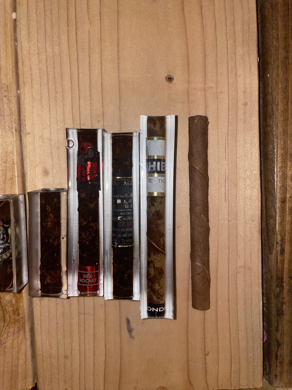

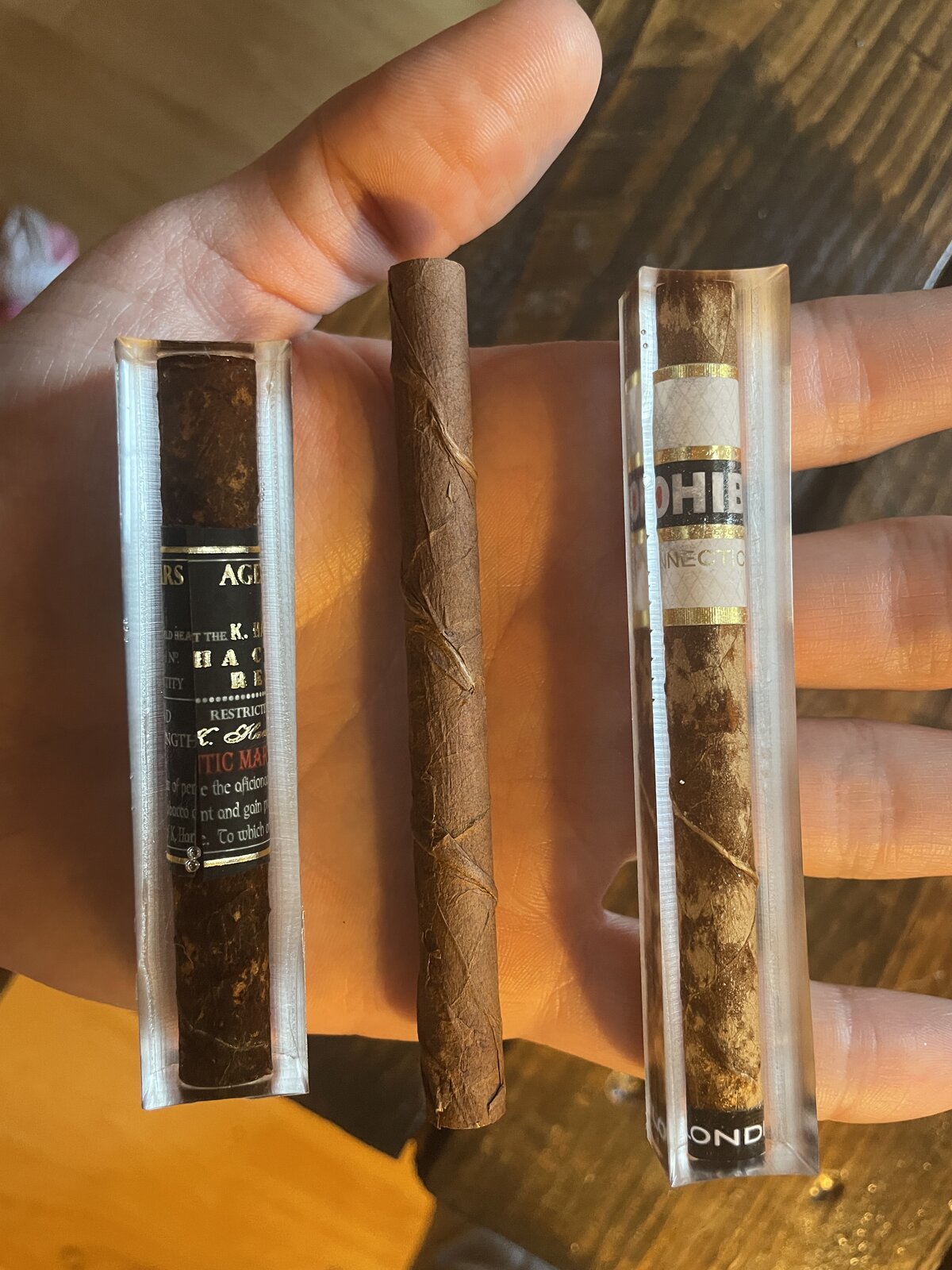

Owner of our BJJ gym ordered 3 cigar themed pens incorporating his own cigar bands. I want to cast them using real tobacco. I understand there are other ways to attach a label to a pen but I want to make this way work unless it proves to be completely impossible. I'm having serious trouble trying to cast tobacco leaves. The tobacco discolors significantly as though it's undergoing a chemical reaction and being "soaked" dark and translucent. FYI, neither coating with CA or coating with modgepodge caused this type of discoloration until it was cast.
Here is what I've tried that made no discernible difference:
Baking bone dry vs air drying for a day
Painting the tubes vs direct to brass
Alumilite CS vs Liquid diamonds
What seems to have made a small difference:
Coating with CA.
(This left some areas light but some still became dark and formed a "splotchy" look. The Cohiba blank is the one that utilized a CA coating. I know CA doesn't jive well with Alumilite but I'm just trying to see what can be done to protect it from this reaction.)
What I have yet to try but plan on doing next:
Casting modgpodge coated one (it's coated but not yet cast)
Coating with clear nail polish
Since LDs didn't perform any better I'm going to be focused on using Alumilite clear slow going forward with the experimentation. The universal factors so far have been:
Tobacco glued to tubes with Gorilla glue spray adhesive (and same with the labels)
Preheating the molds to ~130*
Casting under 60 PSI
Demolding after 4-5 hours

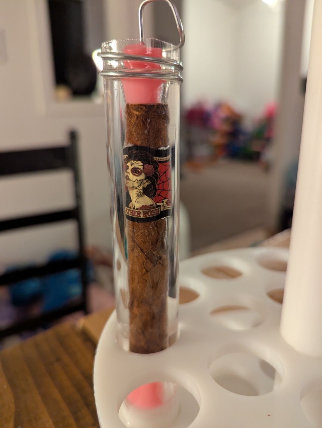

So far none of the blanks have changed since being demolded. Meaning, what I saw when I opened the pressure pot is what I'm still looking at. In the picture I have one tube that is how it looks pre-casting. I love the look and I'm trying to preserve it in the final product.
Anyone tried this before? Any advice or theories?

Several years ago, we used a CA to adhere the leaf to a bare tube before encapsulating with polyester resin (Silmar 41). The leaf was moistened to reduce crumbling during the process. Memory serves that it was about a 50-60% success rate. Abandoned for the success rate.
Plants lose color when they dry, I am not aware of a process to prevent that because the moisture must come out completely for casting. Maybe reach out to Flower Girl Blanks as she casts a LOT of dried flower and similar things. She may be able to assist you with finding a way to do this more efficiently.
Several years ago, during a class at Arrowmont, Curtis Seebeck and Barry Gross dried and then cast shredded tobacco leaves in Alumilite Clear Slow which were then eventually turned into pens, IIRC. I'm not sure how well whole leaves or whole cigars would do as there will likely be some small amount of moisture left in the leaves/cigars; moisture and Alumilite Clear/Clear Slow are avowed enemies.
I made a batch of tobacco leaf pens several years ago. I watched YouTube videos to see how cigars are rolled. Used my Ulu knife to cut around the big veins. I did paint the tubes, did not do any oven drying. As you learned, wrapping the tubes is the easy part. After a few failed attempts because of discoloring after casting, I tried spraying with a clear enamel. That got close and probably would have worked if I have given it 3-4 coats of clear spray.
What did work was to smear a coat of ProPaste over everything. ProPaste is thick two part epoxy that stays where you put it. I found it when looking at supplies for making fishing rods. With the wrapped tube completely encased in epoxy with no discoloration I cast them in Silmar 41. I would not recommend Alumilite. I hardens quick, so that may help with the discoloring, but it won't shine enough for me.
I displayed them in a wood cigar box, they looked good, got a lot of attention, but were slow selling.

Hmm this gives me several things to try, thanks Chasper. Enamel coatings and/or a layer of thinner epoxy prior to casting. I'll give those a shot
Well, it looks like crap but this is still just a test piece and I solved the problem I needed to solve! This was two coats of modge podge. I'm also going to try nail polish because I think it'll be a better outcome if it also protects the tobacco.

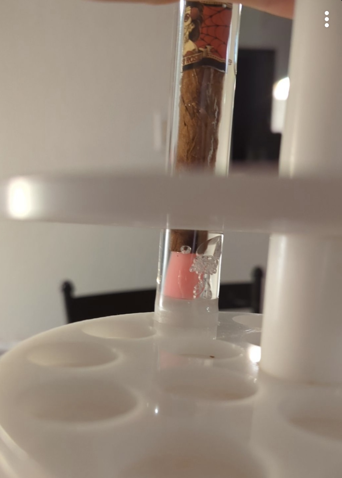

Side note, can you give me any tips on avoiding whatever caused these bubbles at the bottom (second picture) @JohnU ? Love the casting system but I just received it and am completely new to vertical clear casting. 60psi for 4.5 hours. Cant wait to get it figured out, it's super clever and will make things very efficient for me.

I occasionally have those issues. I believe the air comes from inside the brass tube, under the bottom tapered plug and along the delrin base where the clear tube fits. The thinner the resin, the less they will be. I'm not totally sure on how to avoid them but I warm side B up to 90-100° ,with a heat light bulb, prior to mixing so the resin is thinner and mixes quicker, allowing me to get it under pressure quicker, without using up a lot of my working time. A couple times I've also placed a block of wood under one side of the rack to tilt it while I pour, to help air rise out, but I don't now with thin resin. With thinner resin I still get some bubbles but they are always low on the bottom plug and removed when trimming up the blank. I hope this help . Don't hesitate to reach out.
I don`t have that casting system , seldom cast clear , and mostly do larger items , but my approach is to determine the volume of the piece and the volume of the mould to that height . Subtracting one from the other gives the resin volume required . Add 5 or 10 % . Pour it into the mould , then push the object into the resin .

Thanks! I did warm side B (saw you recommended this to someone else) but only by putting it in some warm water so not much. I think I might have been a bit messy on the pour, hopefully that was the issue. Excited to do further experimenting.

Nail polish is a no-go. It doesn't protect the tobacco. I have several more experiments in multiple stages of development right now but so far, believe it or not, Mod Podge is the only thing protecting the tobacco.
The problem is that it leave shiny spots where it built up a bit thicker. Next up to cast is a water thinned version of mod podge, as well as liquid polyethylene coated and liquid shellac coated.
The poly is already out of the lineup but I'm casting it anyway to see if maybe spray poly will be promising, but otherwise it's already distortion the tobacco. Shellac one looks ok.
These first two are Mod Podge on top of nail polish. Close but not there yet. Also a random label cast to prove I usually know what I'm doing. Then the "next up" rack and a few other failed attempts with nail polish and CA. Also also, those are my fiancée's hands in some of those, I don't paint my nails. Not for free anyway. 😂
