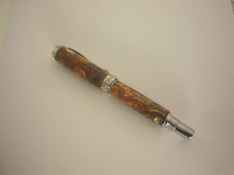

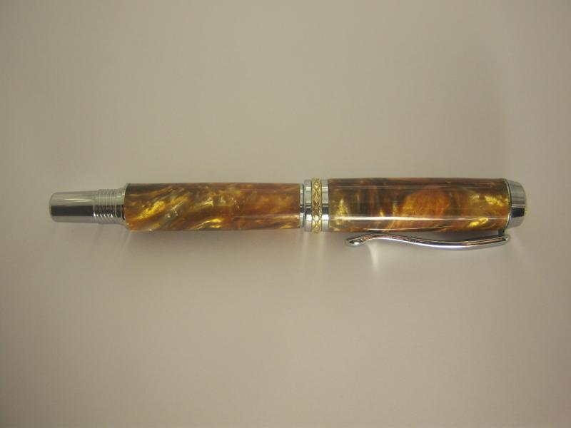

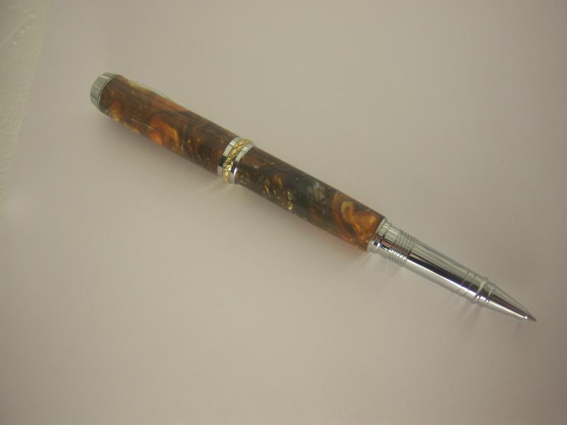

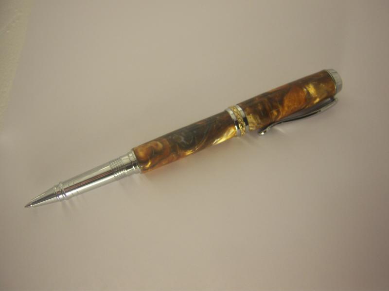

First Triton RB..the fit didn't seem quite right..seemed the cap didn't fit as flush as I thought it should? As always c+c welcome!
You are aware the stop rings are different diameters. The small stop ring goes next to the end cap.
I'm with Mack. It looks like you switched the two rings around. The nib end diameter should be larger than the other end. the blank does look great with the hardware though.
