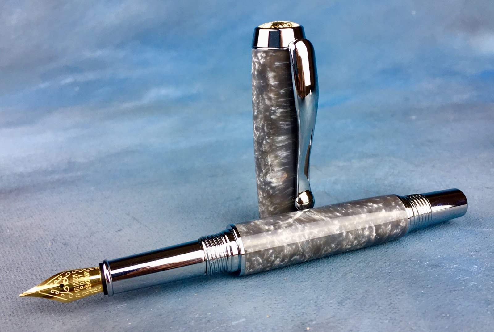

I used to hate this material and time has changed that to near affection. Improved sharpening skills for HSS, better turning skills, more patience and yes a fresh surface on a 2" radius carbide tool have all made the difference. I know we have been advised to NOT use carbide on inlace, but the long smooth ribbons say keep doing it. Your mileage may vary so do what works for you.
I use carbide on Inlace all the time with no problems. Spin it fast and keep the cuts light and easy. Love the ribbons.
Beautiful pen !!
Yes in silver Testor's. I paint the tube and the inside of the blank, wait 24 hours to dry and glue up with 5 minute epoxy.

Really nice job of turning. Very sharp.
