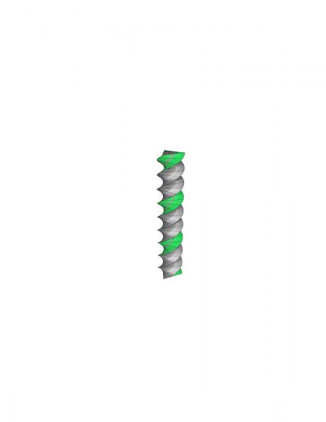

Shown is a sample of the triple lead. The green stripe would be one of the three formed threads as it spirals down the tenon. Hope this helps I will probably put something like this as an explanation on the website.
