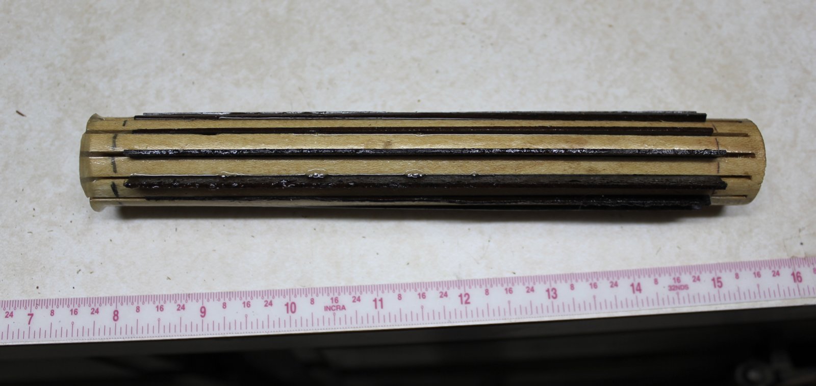

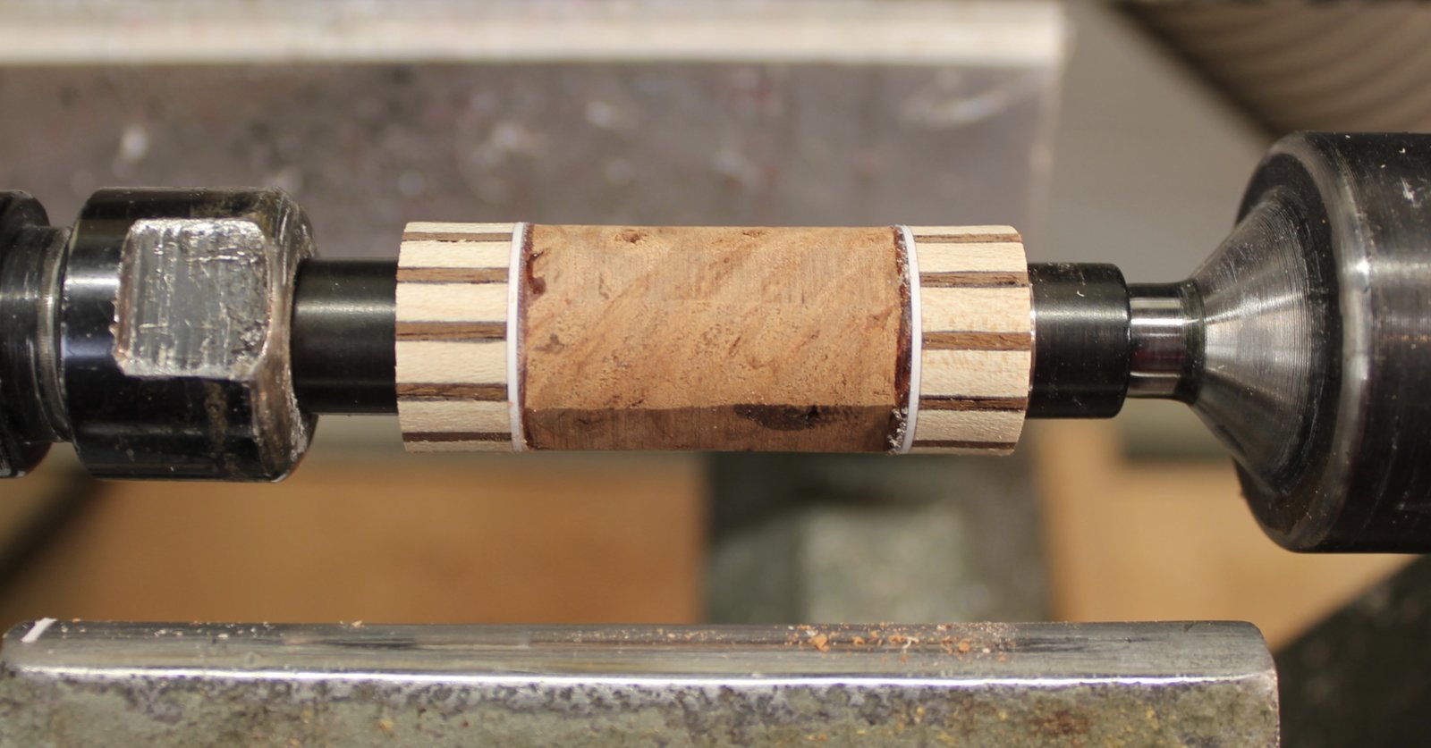

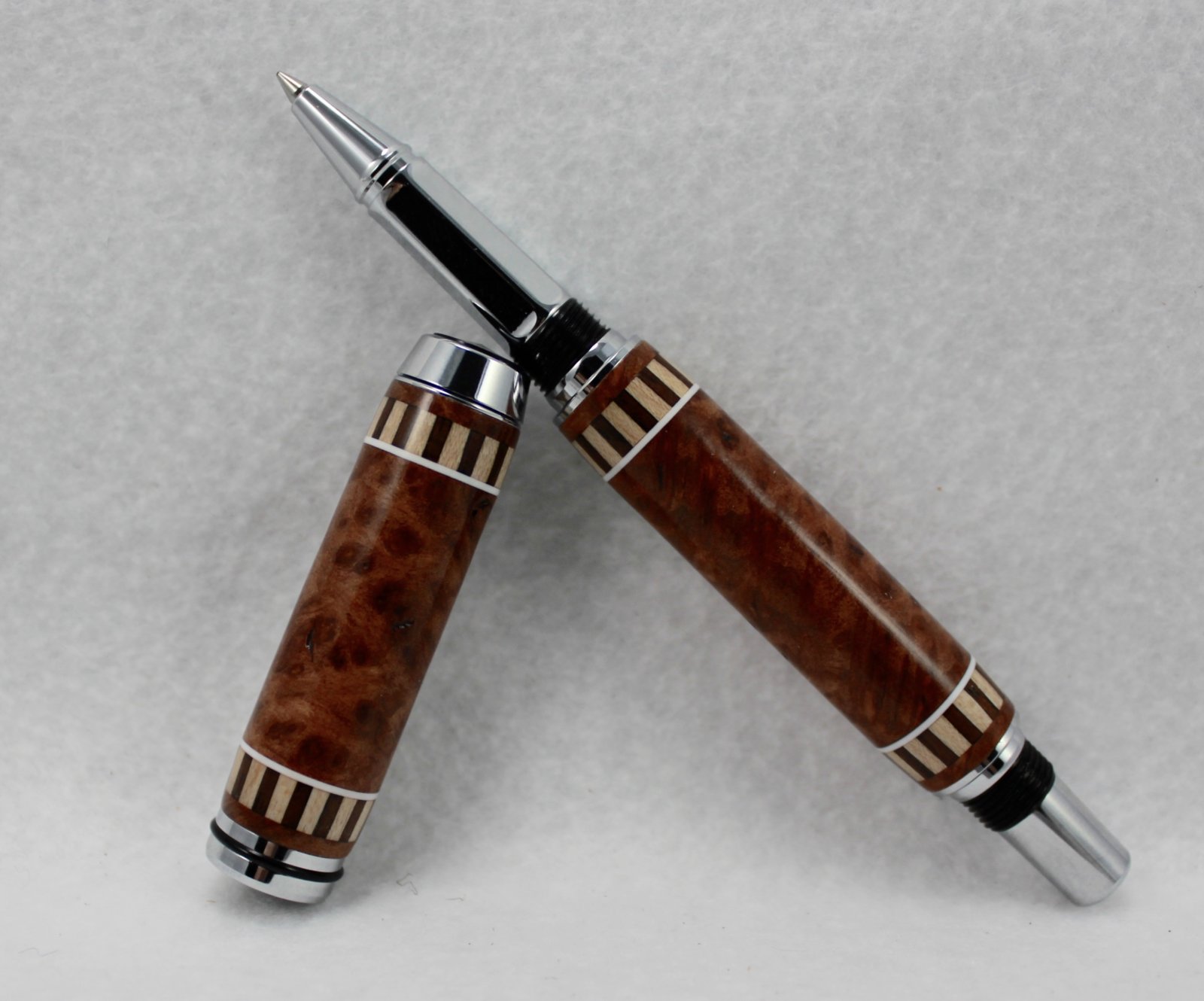

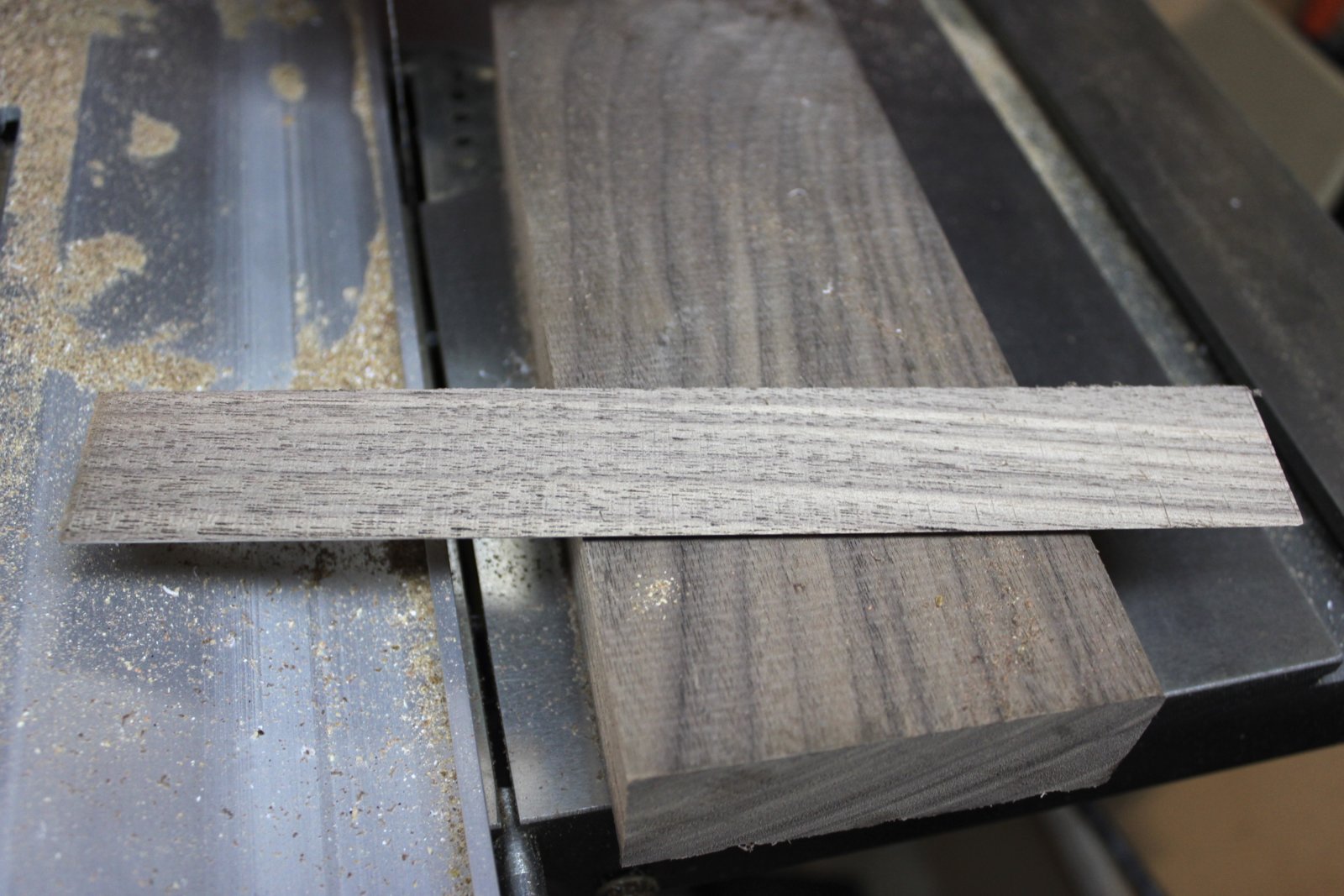

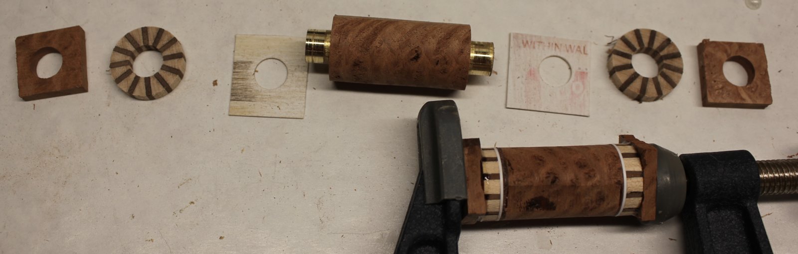

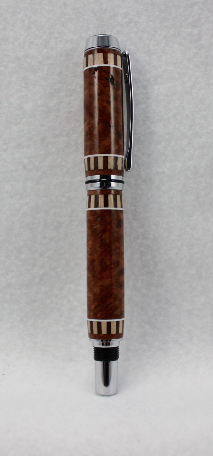

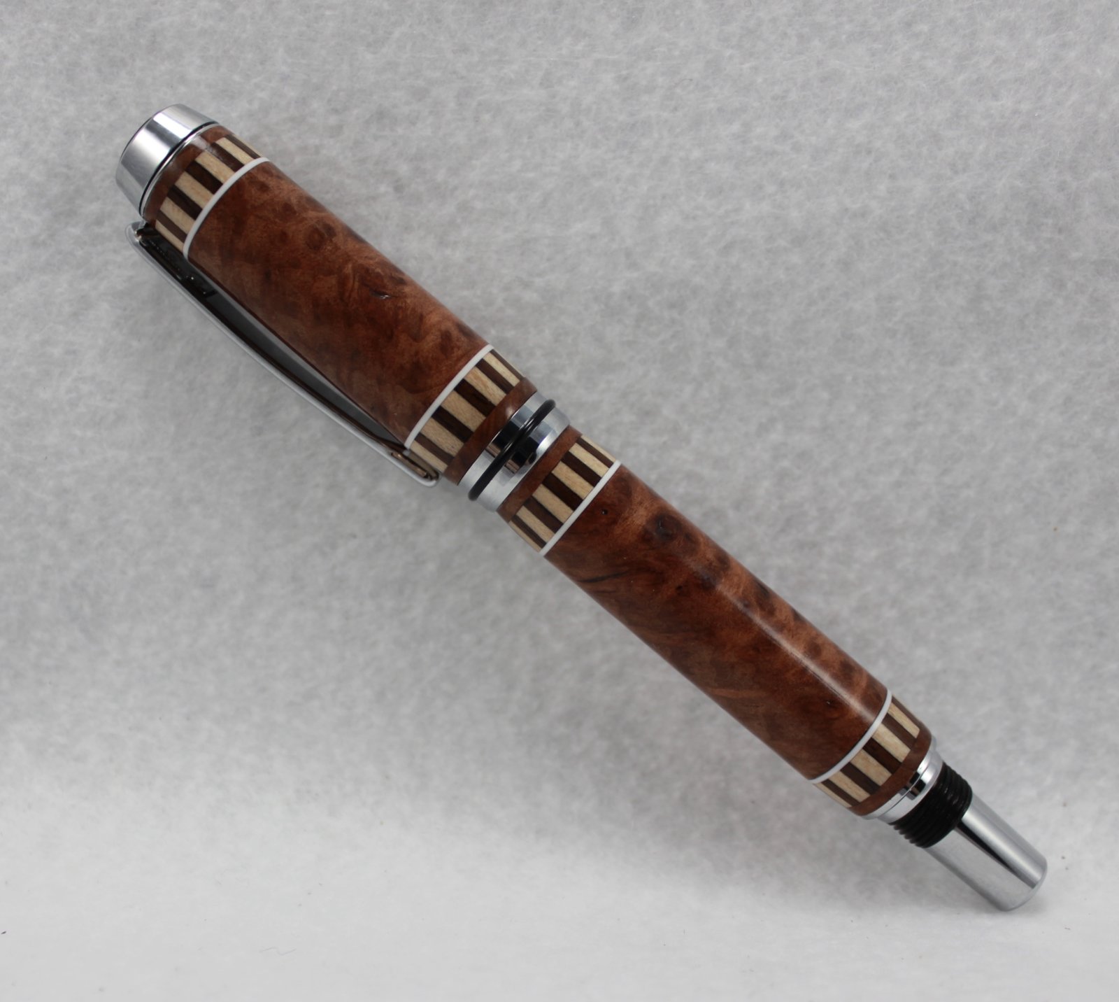

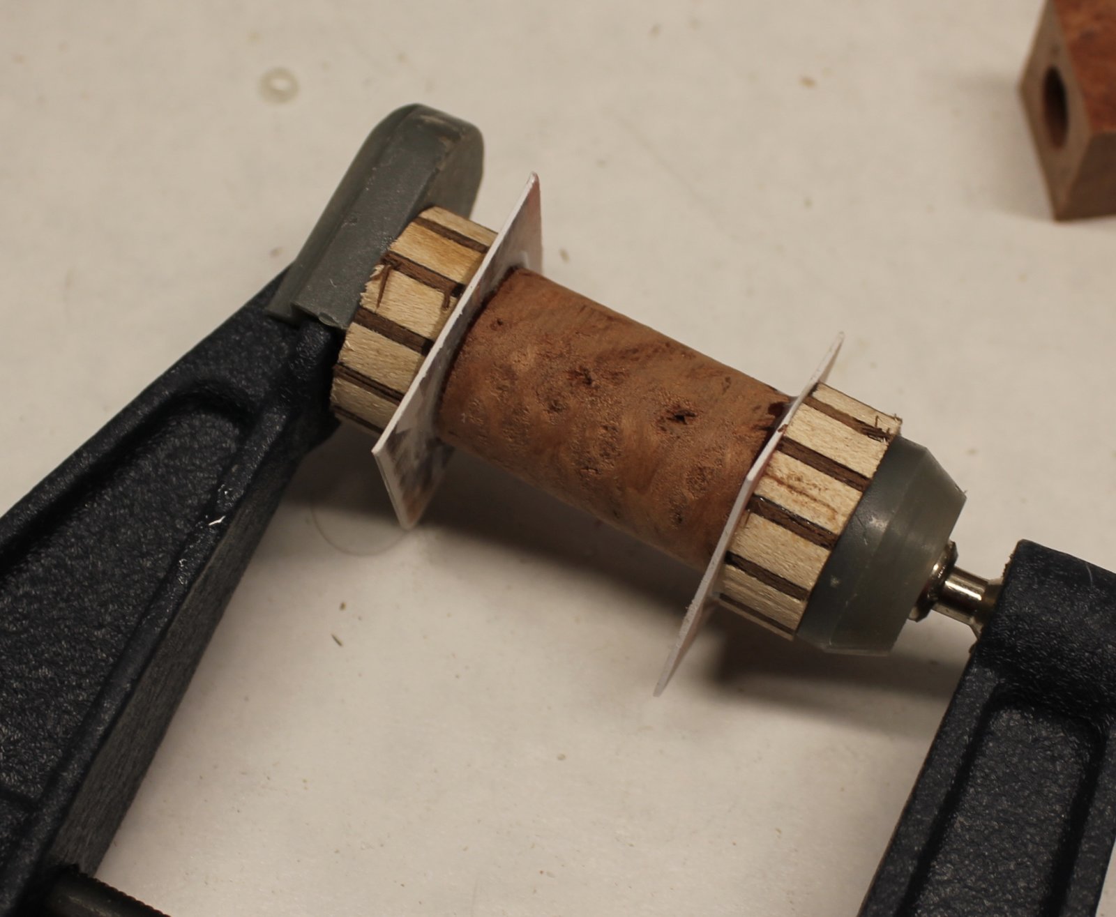

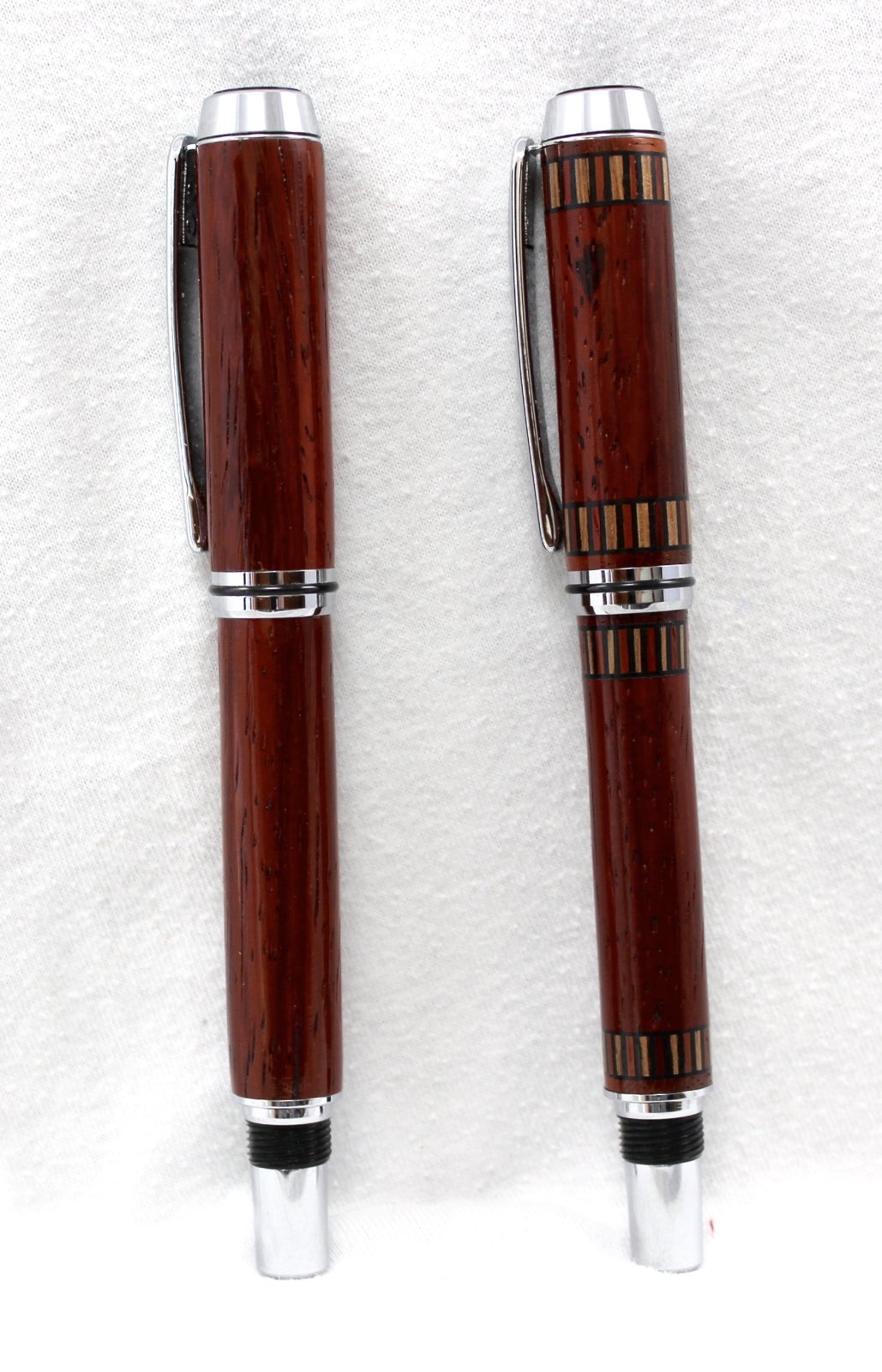

I haven't made any trim rings recently, so I thought I'd give it a shot.

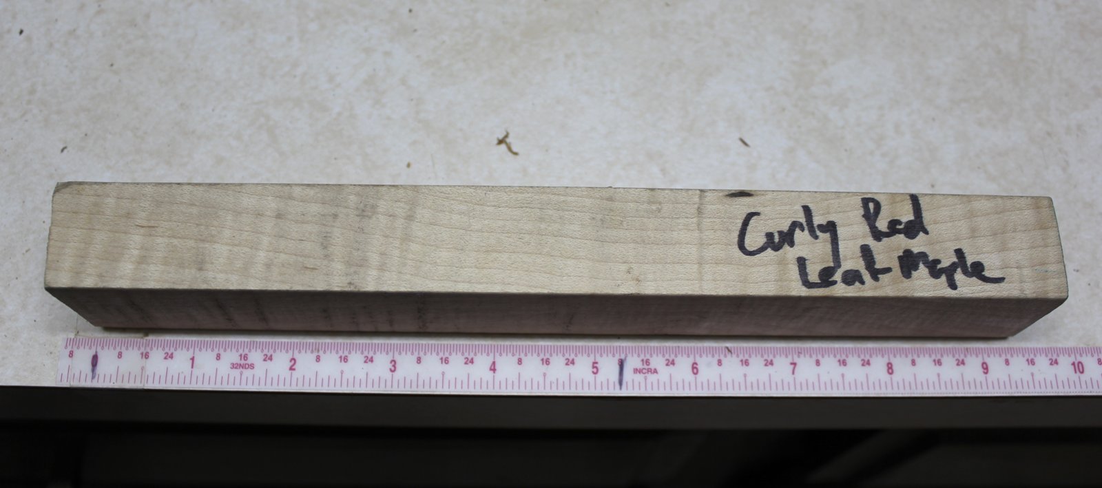

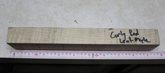

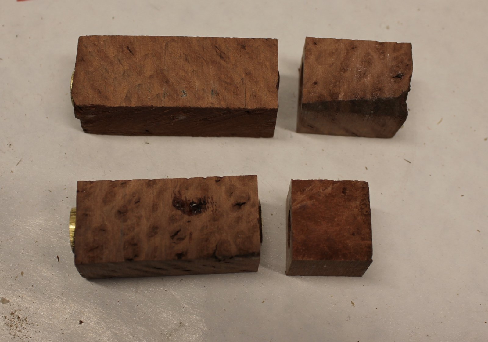

This is for a special order where the wood was supplied to me. The trim rings were made from a spindle of Curly Red Leaf Maple, and a block of Black walnut. The rest was a beautiful Redwood Lace Burl.
Here's the process.

Very Nice! Thanks for showing the process. Although seeing the process doesn't make any easier but it does show us the skill you have for planning and precision. Well Done!
Mark, I aspire to reach your level of precision.

Do you have a photograph of the jig you use to cut those walnut strips?
Alan
Hope you are able to spend more time in the workshop.
Alan

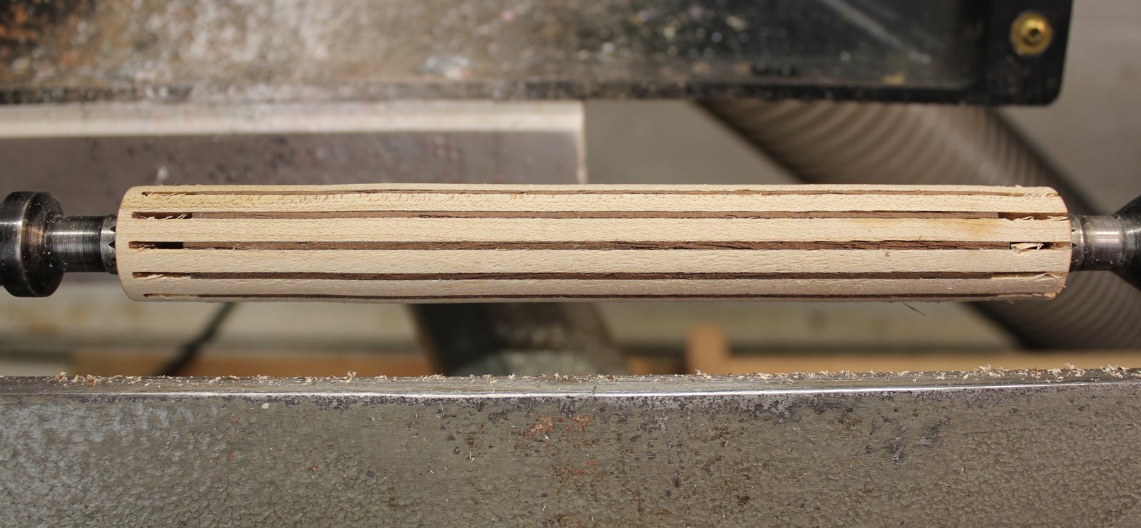

G'Day Alan. Thank you for the kind comments. I cut the strips on a band saw simply with the stock fence and then mill the strips in a Byrnes thickness sander to get the exact fit for the slots. I have no special jig for the band saw yet - just have not made the effort. But with the thickness sander, I can get whatever dimension I need.

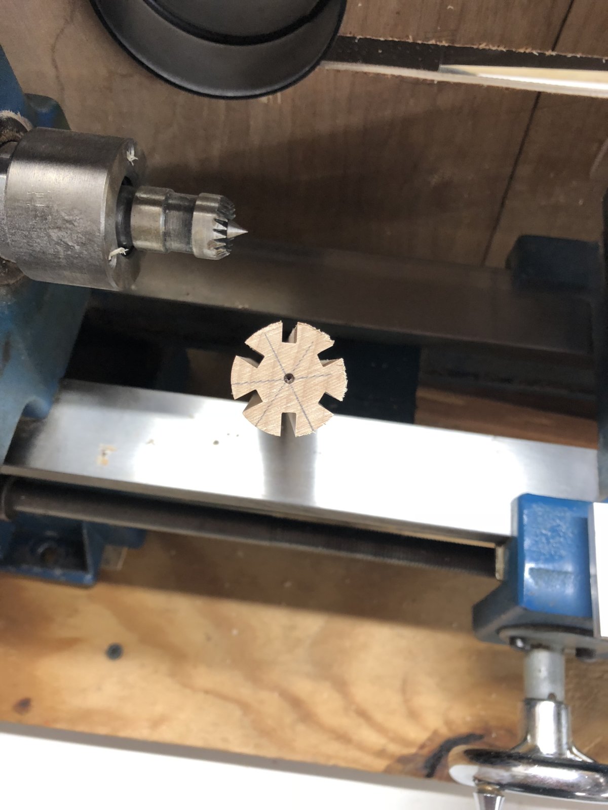

Excellent looking pen Mark. Also looks like a very straight forward technique.

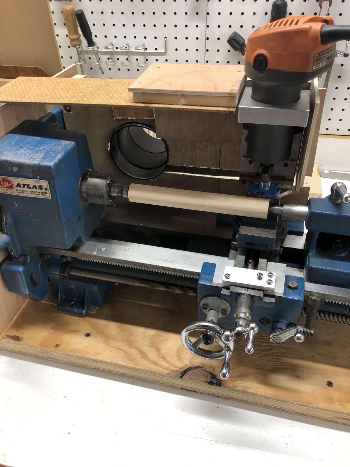

How do you cut the slits? Do you use a table saw jig?

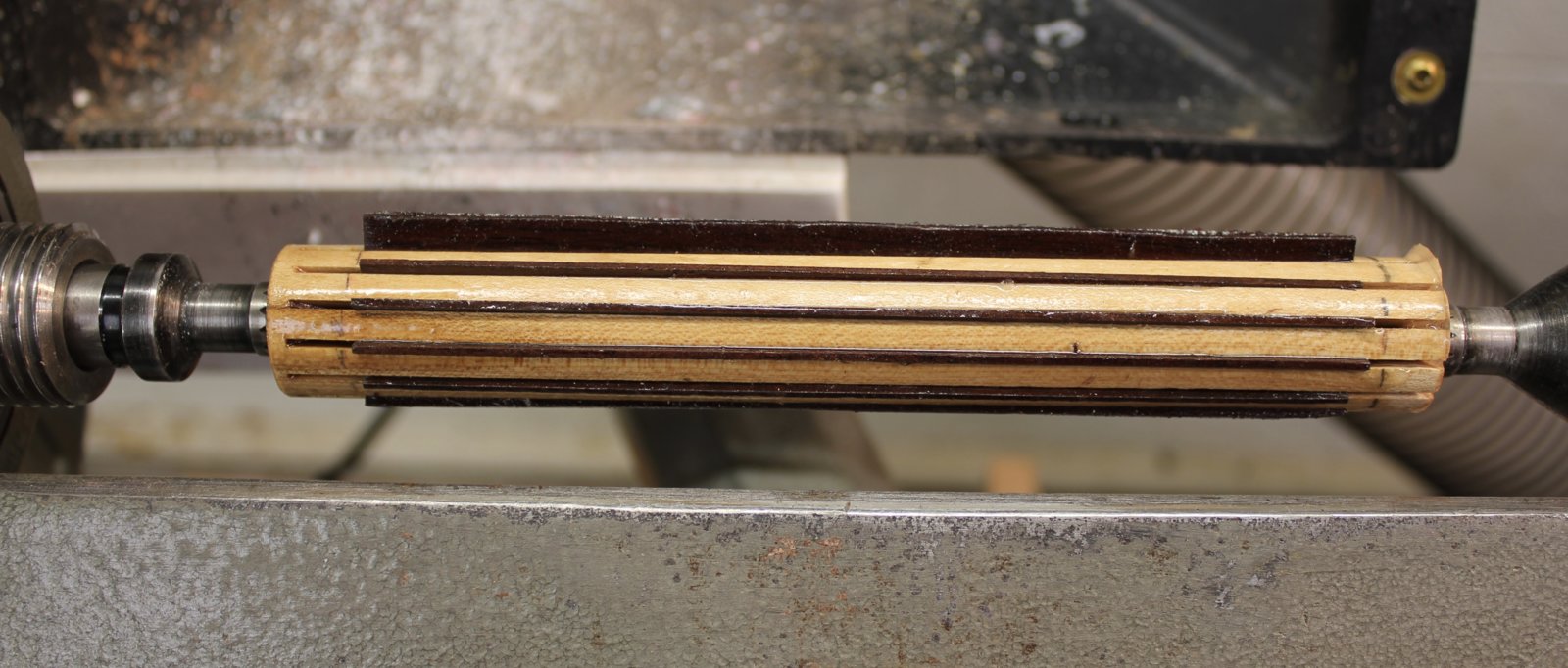

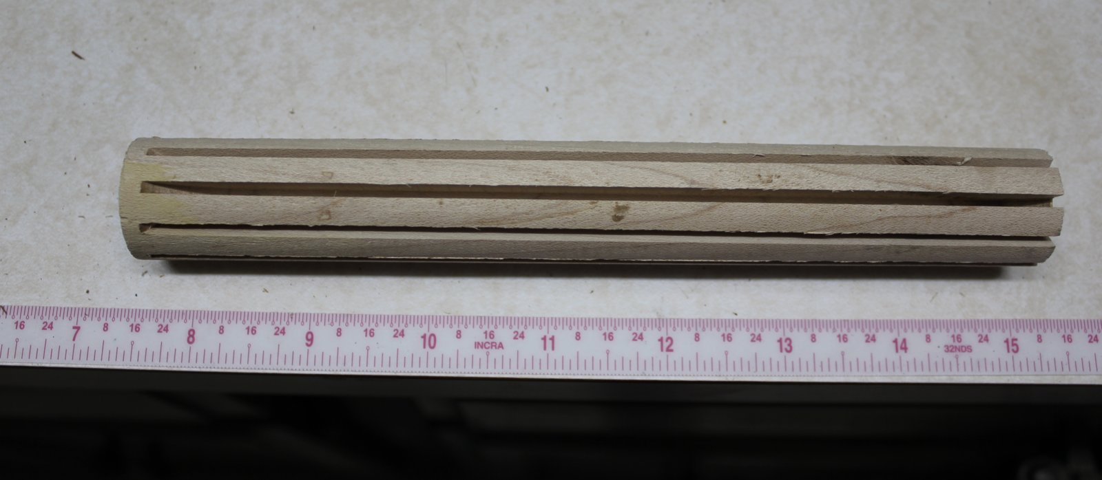

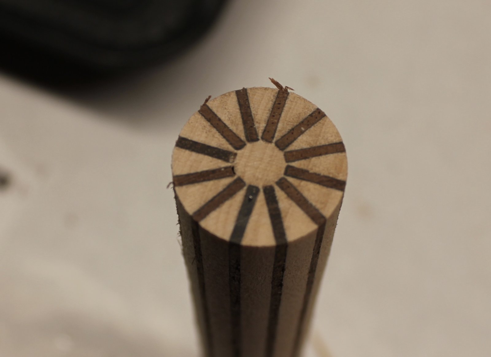

I use a router mounted on a junked 1950's metal lathe (no motor, gears, etc. BUT, it has a heavy duty indexing plate welded to the headstock). I can cut up to 12 slots for a typical pen trim ring. More slots give me problems as the blank tends to explode as little wood is left in the middle. I'll attach a picture and look for the thread where I give a fuller explanation.

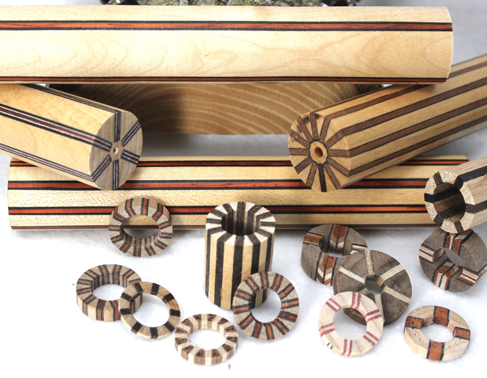

This thread has my initial work on trim rings (I called them billets back then). The discussion is helpful as there are other ways to make these rings. Billet Rings.
That is awesome. Love the process also. Do you start with a normal size blank also?
I like to start with an oversized, round blank. 1" OD x 8-9" long. I have used 3/4" OD and that did fine, but if I have larger stock I'll use it.
