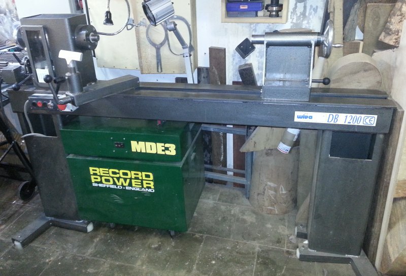

Chris, what speed are you running your lathe at, and what brand of lathe do you own?
Len
Len,
Around 400-500RPM with the carbide pen mill illustrated in the above videos. Faster speeds with another tool (Nolan's mill) at about 1500-2000RPM. Speeds may also vary depending on the blank's material (wood, resin...).
As for my lathe, it's a Belgian Wivamac DB1200 (see pic below).
