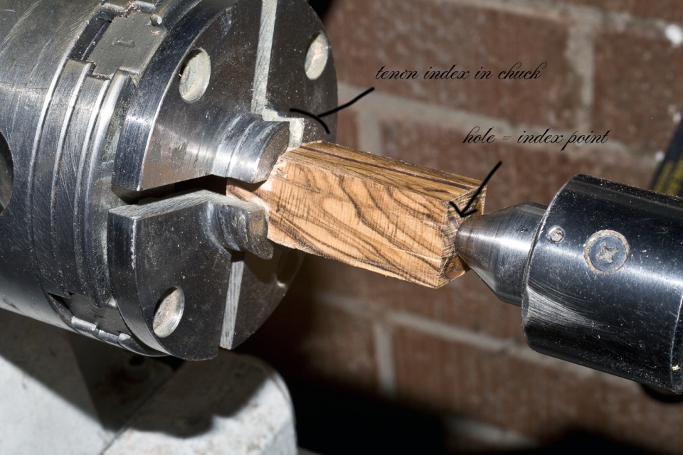

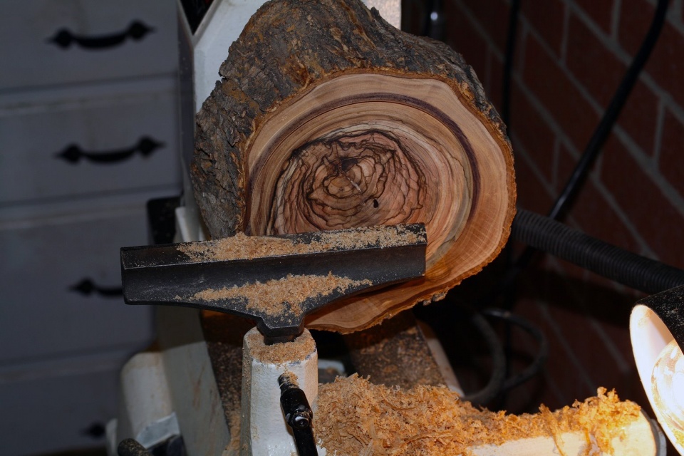

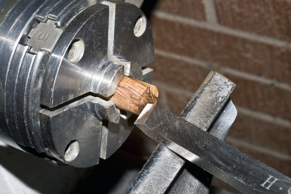

This is some scrap wood I have, it's cracked like crazy. I used a chuck and a flat skew. No need for barrel trimmers, sand paper pads or the like. I even did this one with an off centered drill hole on one side to show a few points.
chuck the blank and flatten the end, clean as you can, sharper the chisel the cleaner the cut.
attachment.php

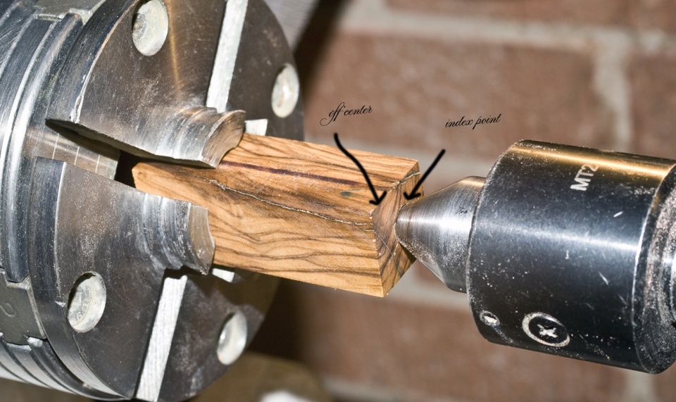

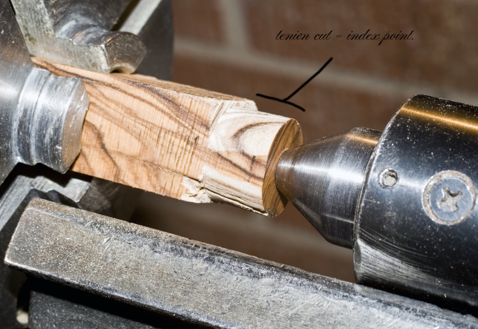

then drill the hole. Once that is done you created an reference / index point. This hole, on both sides of the blank, will be used several times down the road to align things. The example I used is off center on one end, the off center is the bottom of the drill hole. I reversed it on the lathe to align the off center part to the tail stock.
attachment.php

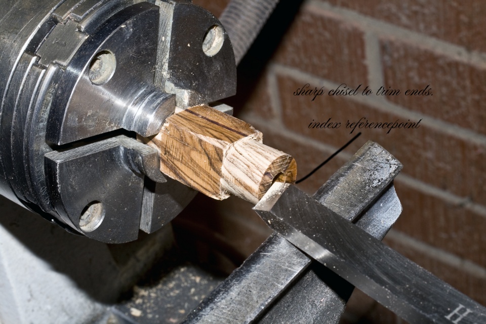

Then I cut a tenon on that. No more off center.
attachment.php
This new cut tenon is a new index point that will be reversed and put in the chuck jaws, it will line up with it perfectly and the tail stock will again index the drill hole.
attachment.php
Then a tenon cut on that side as well should clean it up super nicely.
attachment.php

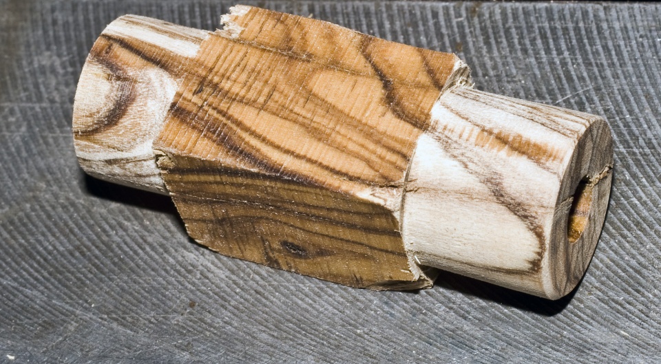

When you are done the blank looks like this. I did not fully round it either and it is a short block to show references. If you glue the tube in beforehand you can use this same setup to trim the ends for the bushings.
attachment.php
Also worthy of note is the edge of the tool rest is a reference point. :) Line it up 90 degree's to the lathe bed and that will allow you to get flat cuts on the end. If you look down at the end of the blank you will very quickly see if it is off.

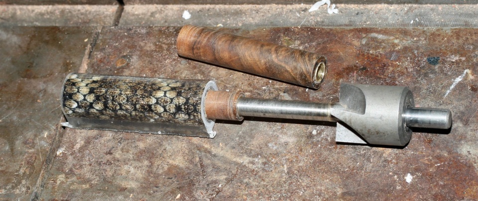

I only wish someone made a 4 cutter carbide mill.
You know this is the sole purpose of the new sub forum on group buys. It is a place where we can get design changes for group buy orders. Granted those would be special order items but it's doable with the power of numbers and we have those numbers here on IAP. So if there is interest and the design is good and sound and you have a shop that can do the work then it should be a very good chance.
The picture shown in that link shows a 4-blade cutter but the part number reference to PSI indicates it is a 2-blade, which gets poor reviews.

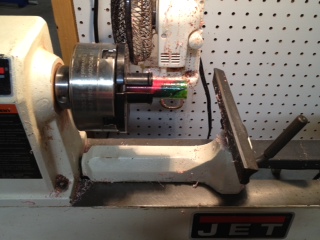

Ed I actually tried your method tonight and worked for me sort of.......my tool rest holder body is too long for me to get it close to the chuck to be 90 degrees, it was still a few inches away. The pics below were made with a different blank but wanted to show general idea of what I meant. I sort of worked it from the side and front and made it work. Blank was cast round so that made it easier. I may be missing something really simple? Usually am and like to overcomplicate things.

:facepalm: Rotate that banjo 90 degrees ;)
'universal' is only given with the proper usage ;)
