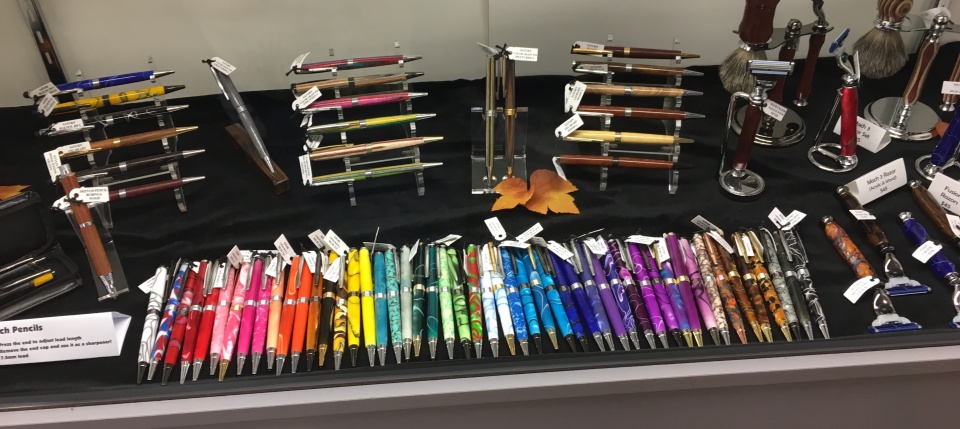

The kits from Craft Supply called Roadster are my favorites of this type and are the least expensive too when purchased in quantity. I sell many, many of them and that's why I'll keep making them. I have over 70 different ones (acrylic, wood, Spectraply, stylus etc.) in my Gallery n Gifts display case (many shown in the photo) and close to 60 in my travel cases. I'll make 40 more before the holiday season. Last year, most were sold, I hope for a similar result this year.
