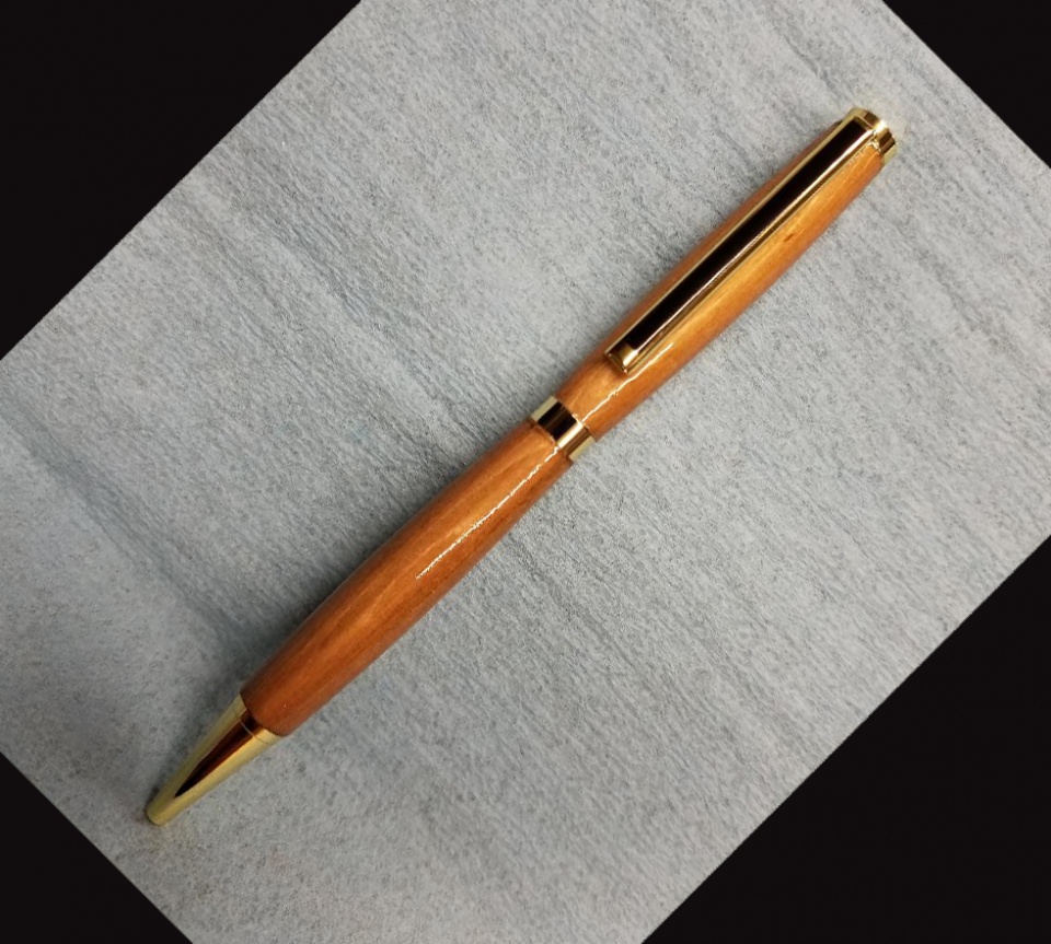

So my first 2 pens I finished with Bullseye Shellac. It does a decent job and dries fast which is a plus, but still not getting a high sheen with even 6 coats. I know I know ca finish. Not ready for that just yet. But for my third pen I wanted to try the wipeon poly. I did this pen with Zebrawood. I really like how it turned out. I put 4 coats of poly on. I sanded with 1000 grit between coats. Yea it took a while to cure. It's 4 hrs between coats. I turned this sunday evening, put 1 coat on. Then put another coat Monday morning before I went to work. Came home and put 3rd coat on and then 4th before bed. I like the way the finish looks. The pics don't show real well, but it has a nice shine to it. I know for most of you that time is of the essence but for me its just a hobby and I'm not selling any at this time and have no timely demands. Ok, on to my 3rd pen.
Try putting it under a light to get some heat to assist the curing. When I do this, I can repeat the Poly in about 2 hrs.
Looks fine so far.
I wasnt in a hurry for the finish. Thats why I let it set as long as I did. I'm just experimenting with few things.

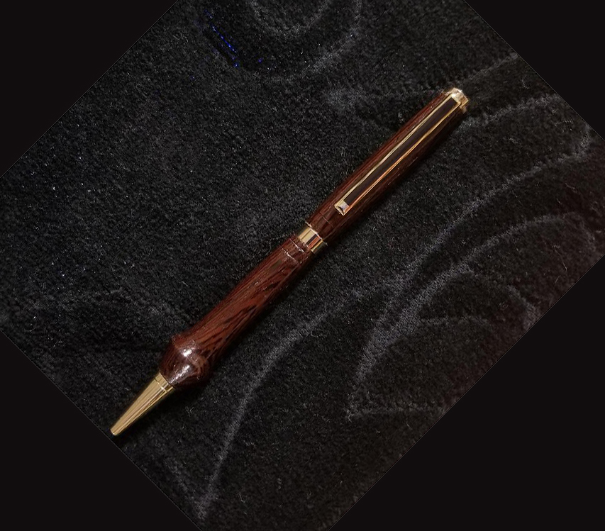

Yes sir! I'm actually doing another one but this time got me a can deft lacquer. I'm using wenge wood and it seems a little pourus. When I use poly on anything, I sand with 1000 grit after each coat. Did the same with the shellac and plan on doing it with the lacquer. I do it just in case there's something too small for me to feel or see. Lol Luckily, the lacquer does dry about half the time of poly. We'll see how it does. Time doesn't bother me too much using poly and so far I like the finish I got with the poly. Hopefully the lacquer will turn out as good.

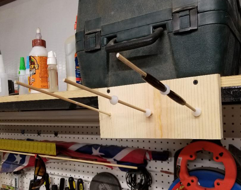

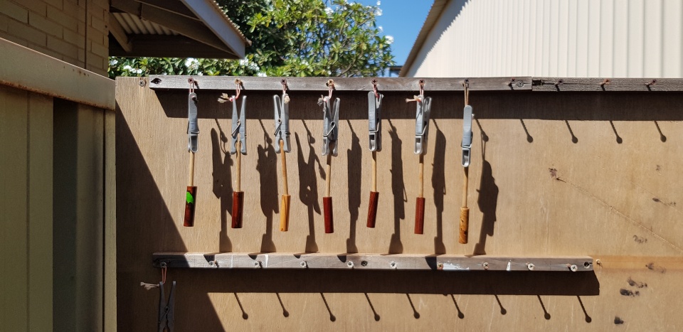

So I really like the looks of the poly finishes I've been getting. Yea it is time consuming waiting 4 hrs between coats, but I got me an idea. I made this little drying rack. Lol 3/16" dowel and 7mm bushings slide over them nicely. Put some CA bushings between them to keep them from sticking together. Now I can lathe, coat and then put them up to dry and be able to start lathing my next pen. Lol

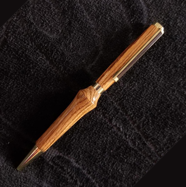

So I used lacquer on one of my pens. It did look good but I still get a better finish with the poly. I let the poly totally cure, sand with 2000 grit between each finish and use 4 coats. The poly gives a great shine. Just for additional protection I do a quick wax with some renaissance.

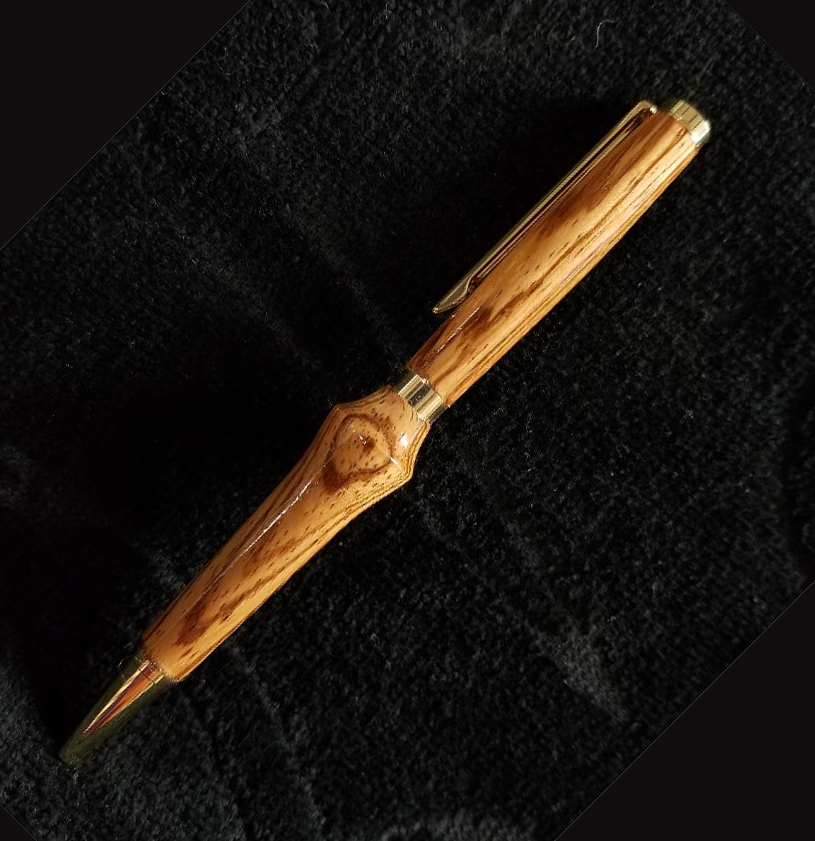

I did a pen with lacquer. For poly, I do 4 coats. I put 6 coats of lacquer on the wenge (dark) pen. 4 coats of poly on the cedar pen. Unless I'm not using a specific lacquer, it just doen't give me the shine that the poly did. What is your method for finishing with lacquer. I'd really like to know and if I can get the same finish with it, it would save me a little time. With winter coming on, poly never cures very easy. Lol

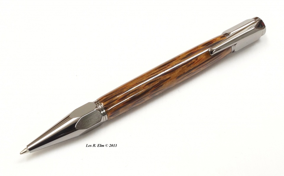

I use MINWAX WBOM Clear Gloss Polyurethane using my dipping method.
Easy to apply for a fast drying, consistent, high gloss durable finish every time.
Les

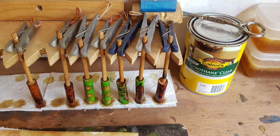

I have used the dip method for a couple of years after getting a reaction from CA.
I block the lower end of the tube with a disposable earplug. I use an earplug glued to a dowel to block the top and as a handle to dip, remove excess varnish and to hang for drying.
This method takes several days to complete 3 coats but the strength, depth and shine of the finish is worth the wait.

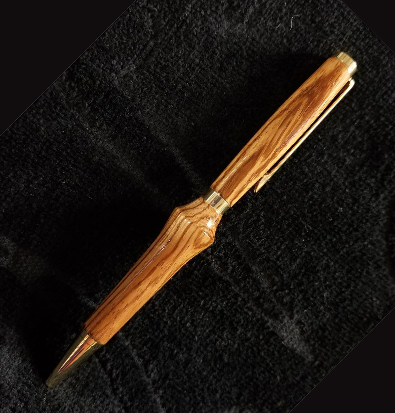

Nice idea on the drying rack. I normally just set them on the workbench. Thanks for sharing. But your shop seems way to clean...really... know saw dust on the shelves? Maybe you cleaned up before you shot the photo.
