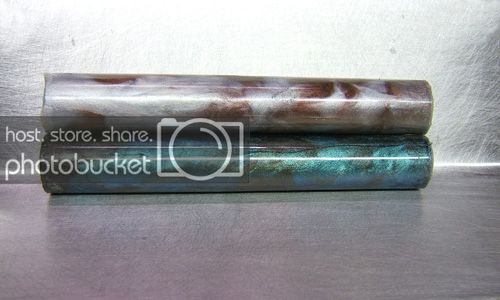

I've been around resins most of my life, but I've never made a pen blank. I read on here, along with other places, about making pen blanks.
It's pretty simple compared to doing lay-ups or prototypes. I haven't done anything with resins for quite some time now, but I don't miss the aroma.
Anyway, here is my first attempts at pen blanks. I'll be attempting more soon, I hope.
Be gentle on your assessment.
Thanks. I have another one in the pvc, but it was still too sticky, so I will get it out later. I'm in no hurry.
I guess 5" is a good length from my reading, and these are almost 5.5".
If I get feeling better, I would like to attempt a 5' pen blank. Buttons are made from 10'-15' rods, and then sliced on a cutting machine. The resin is swirled on a table that funnels into the pipes. At least they used to be, and I would like to try something of that length.
They look great now but always look better on the inside. Good luck with a 5' one. Might be tough to coax out of a PVC mold if it has one little ripple imperfection on the ID (and most do). Pouring it would be interesting too as I would think most would end up running down one side or the other. Who knows, might turn out you are a genius for coming up with a great new method. Keep up the great work with the little ones though.

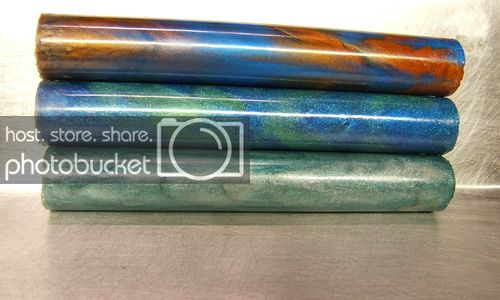

Those look great. A 5" blank will be enough for most pens unless you're doing kitless with a nib section with the same material. Then a longer blank would be needed.
I usually see about 1/4" shrinkage when I pour my blanks. I pour to about 5.5" to get right around a 5.25" blank.
For blanks that don't want to come out, I put them in a cold oven. Set the temp to 170°, the timer at 25 minutes. When the timer hits zero, they get pulled and set aside to cool. Typically they will come out after that for me.

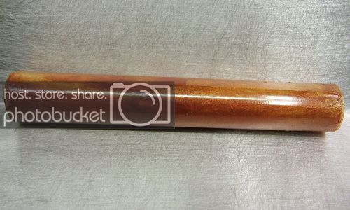

It's not that it wouldn't come out, it just wasn't cured enough. I went back out and it slipped out without issue. I'll place a photo below.
I would never place chemicals in an oven. They will leave a toxic residue and will contaminate any food placed in the oven. Also, an open flame and the resin fumes create a combustible environment that can potentially be dangerous. I've seen some consequences first hand. Be careful, I wouldn't want anything bad to happen.
My last pen blank.
Actually, this was my first one. I used this one as a test for the catalyst ratio, and it was off. That is part of the reason for it taking longer to release. So, it blended a little more than I would've liked. It's red and gold, but has a nice orange blend.
Those are really good looking on the outside. And I'd bet the inside is spectacular. I like mine to be at the 5.25" mark so I can make a closed ended pen with a custom finial

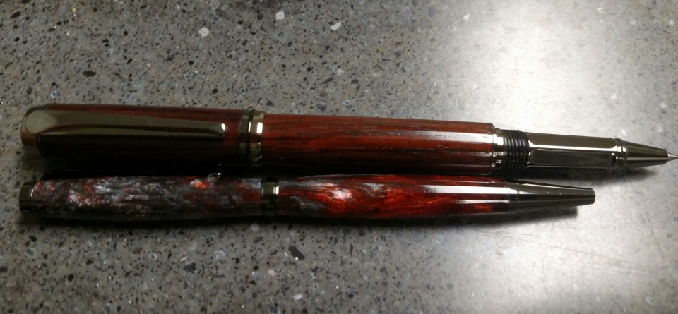

For reference, here's a Baron that I use everyday at work next to a slimline that I use everyday at work.

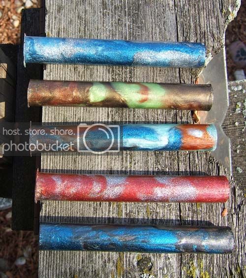

I did another batch of blanks, but I was asked if I could make them "sparkly". So I made these with some large particle powder.
I'm guessing I should have started a new thread for these? Maybe most people have looked at this thread once and didn't return, and don't realize I added these?
Should a new thread be started for additional items, other than comments and responses? I didn't want to seem like a post hog just to show a photo.
Anyway, if you happen to see them, any critiques?
It's an aluminum powder. It comes in various sizes and in other non-ferrous metals as well. The aluminum is least likely to oxidize in the container, between uses.

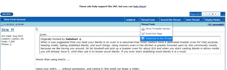

Sappheiros: you can subscribe to a thread and get email notification when new posts are made. Would that help you?
I feel like that could get a little crazy. I guess I'm thinking more of a Facebook-esque notification center. My email would be popping! Good to know, though. Thanks! :D
You'ld only subscribe to the threads you want to keep track of ... :)
You can find the proper link at the top of the page in any thread...
