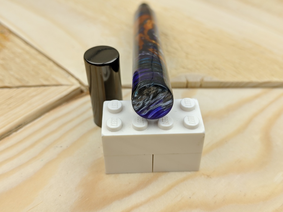

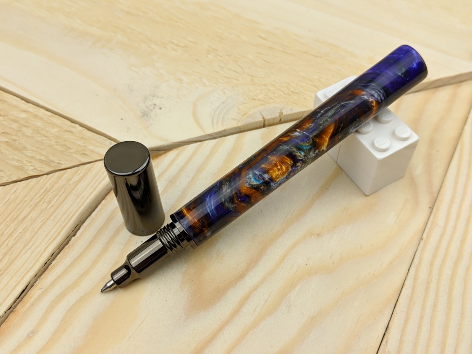

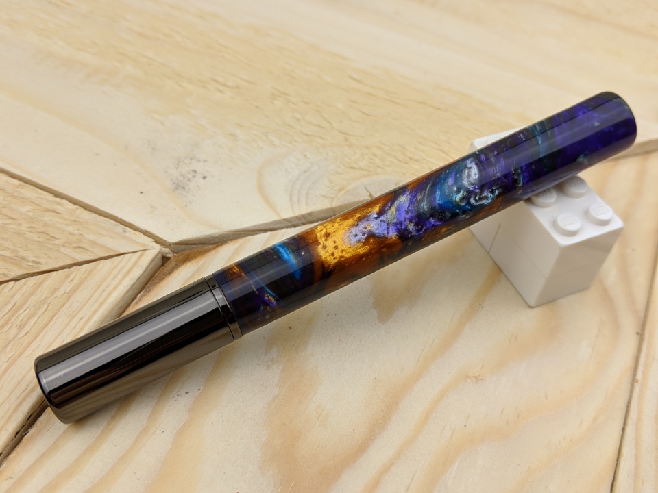

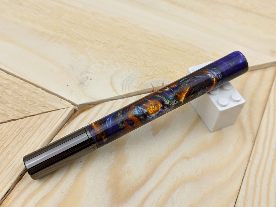

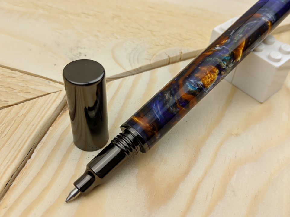

Tried out the Varita closed end kit, and I really like it. The wife ended up claiming this one as she likes the smaller more compact pens. Though you can make this as long as you like.
The blank is "Four Color Nebula" from Exotic.
