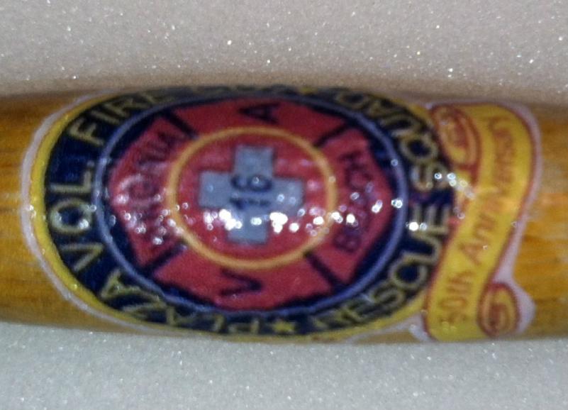

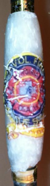

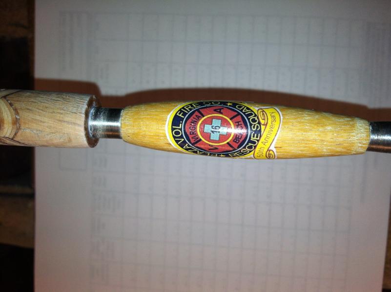

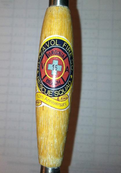

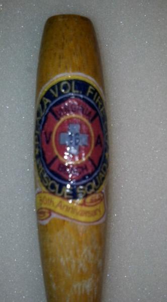

I didn't think this fit the catagory of "show off your pens". It wasn't finished, plus it didn't come out right. Here is a before shoot on the wooden pen. I don't have a before on the corian one. They came out kind of "orange peel". I'll get shot after battery charges. I applied 1 coat of thin and let dry a day. Then applied about 6 coats med. The decal was completly dried for 24-48 hrs. They are on white decalpaper from decalpaper.com.

Here are the after pictures.
The wood looks decent. I don't know what happened to the corian one.

I humbly suggest you apply only 2 coats of thin CA after it has dried. Too much CA solvent will attack the decal like a rabid hamster. That's a S.W.A.G.
WB
Mike; When I apply a decal, and after it dries overnight, I apply a coat of ModPodge or DecoPodge to seal the decal from the CA. I also do this with any paper item I am applying to something. Just a thought. Jim S
Mike, it looks like the decal may not have adhered to the Corian. I haven't tried a decal on Corian but on wood I usually put several coats of CA as a base and sand it real smooth. After that I apply the decal. Like Jim says, leave it set over night before applying the CA over the decal. I usually apply some BLO before the first coat of CA just to make the CA go on smoother. After that, CA up to 10 coats. Just remember, just because it works for me doesn't mean it will work for anyone else.
