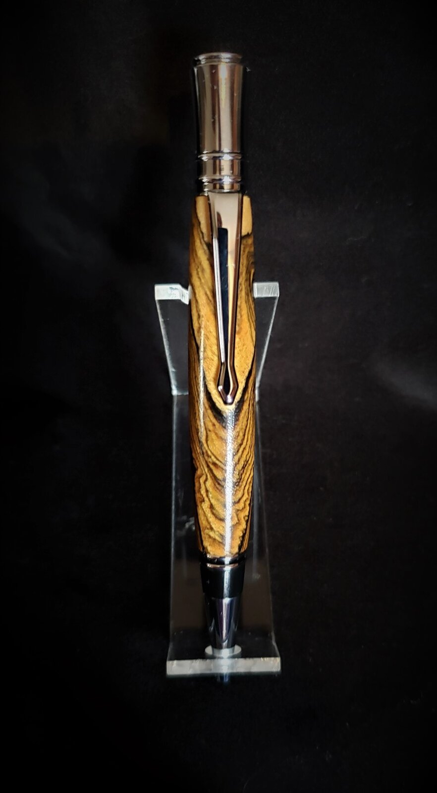

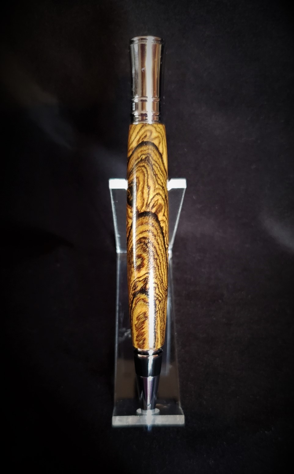

Here are the pics that I promised - both sides of the same pen. The other pen was spectraply; this is a better example and allows one to see wood grain. I think it is a good one to strengthen and add durability to the HBFP finish - assuming it lasts. I am going to try this on others.
BEAUTIFUL !!! . . . . Thanks for showing, Tony !!!!
Wood looks like Bocote ? . . Is that right ?

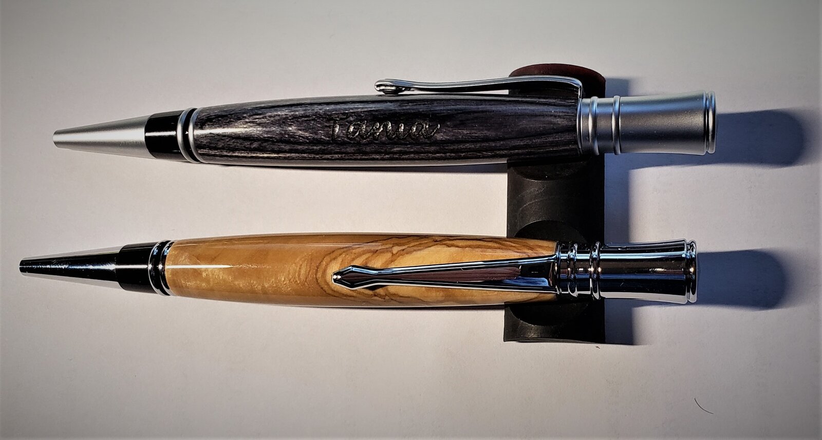

Here's another one - the gray spectraply has the CA/HBFP finish. The Olive Wood (from a Marshall's cutting board) is a traditional CA only finish. My friend requested the black and gray spectraply.
