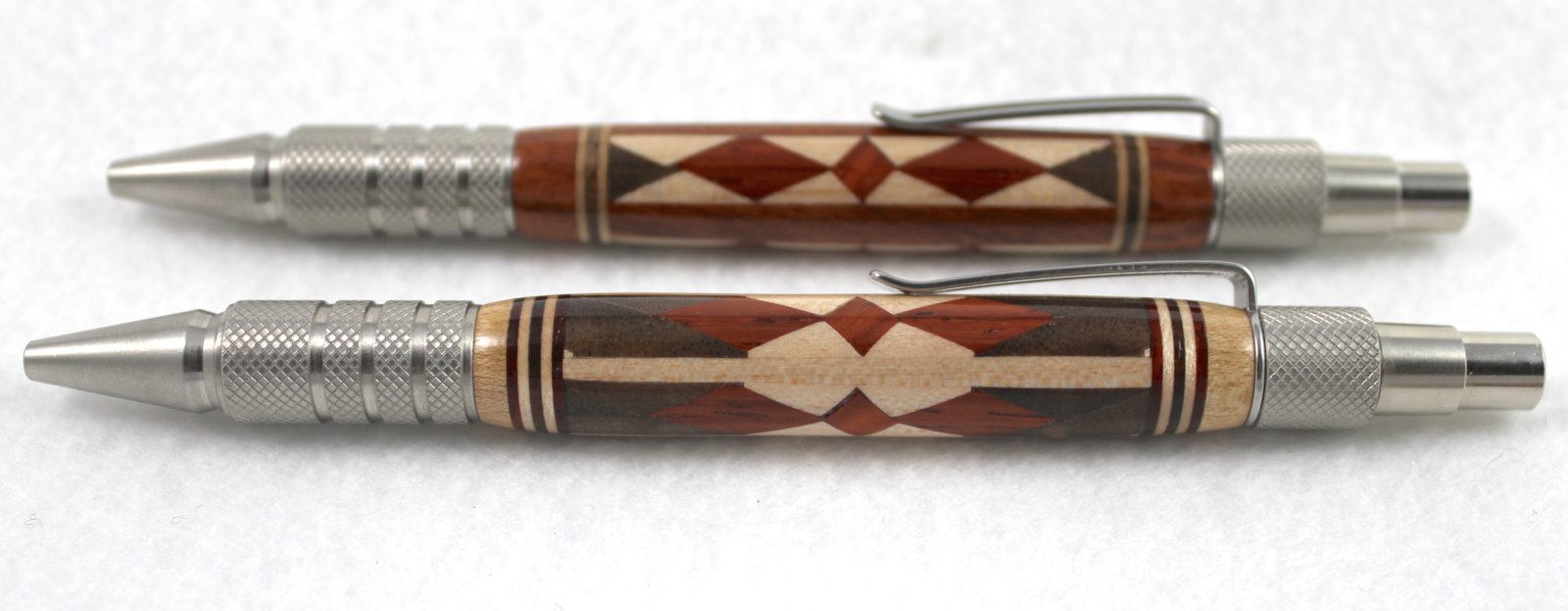

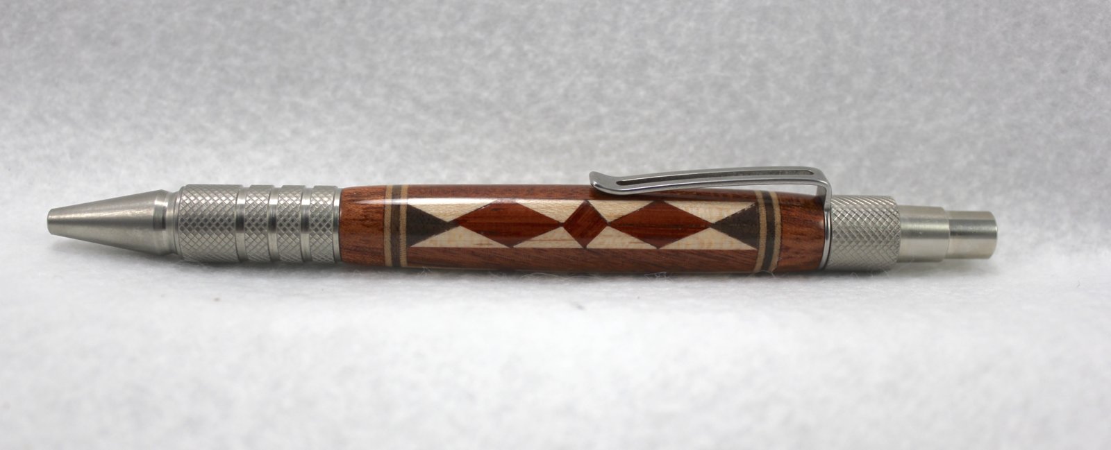

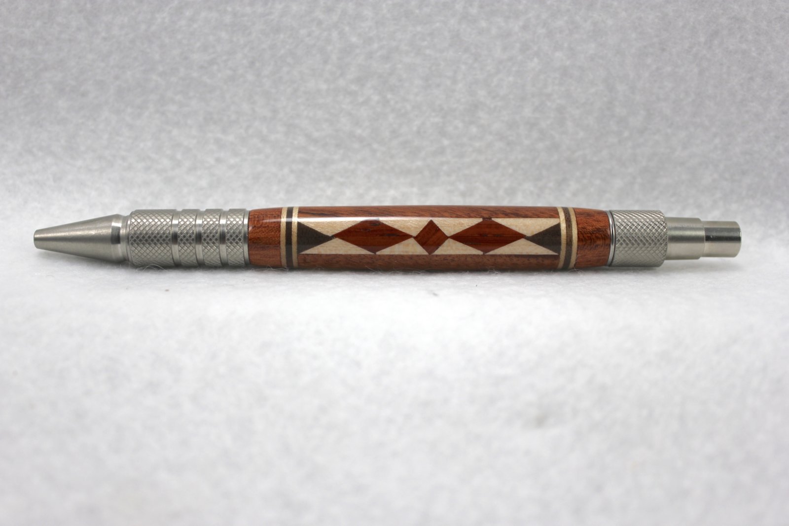

My first effort with this design can be found here. I mentioned that I did not care for some of the visual elements, so here is version 2.0.

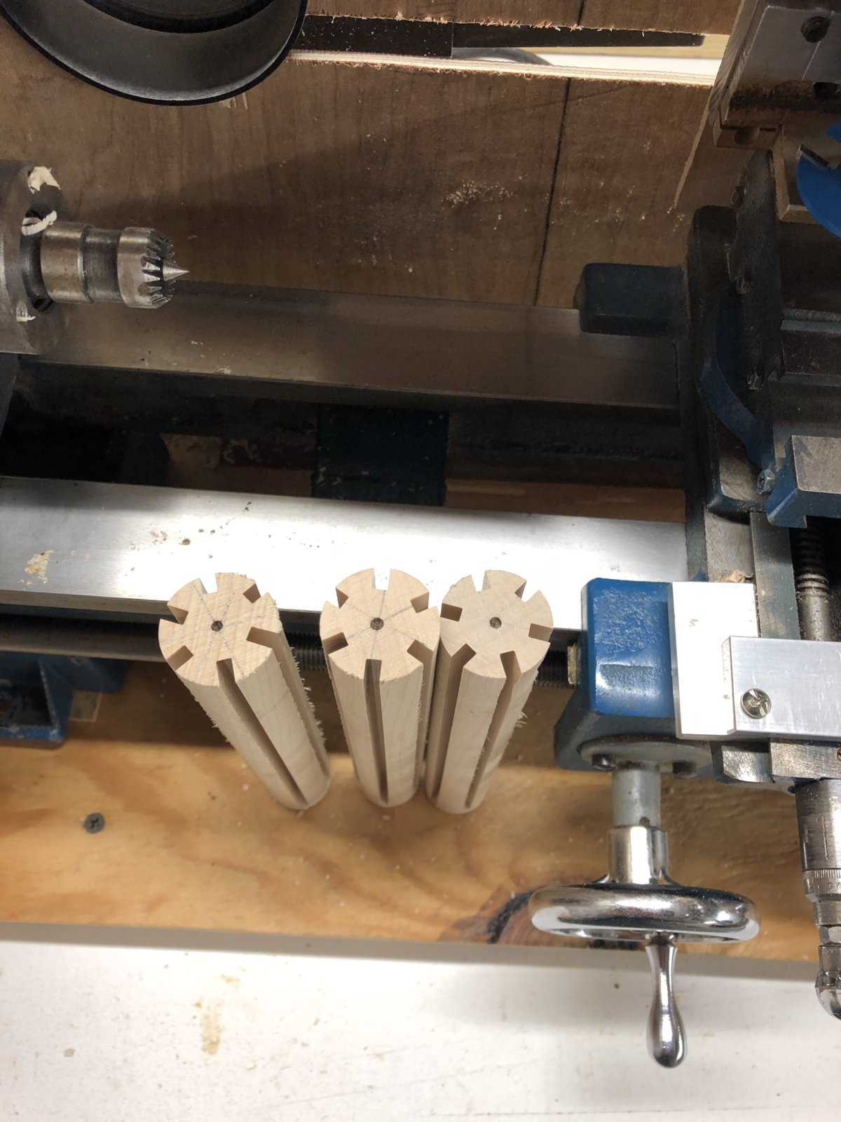

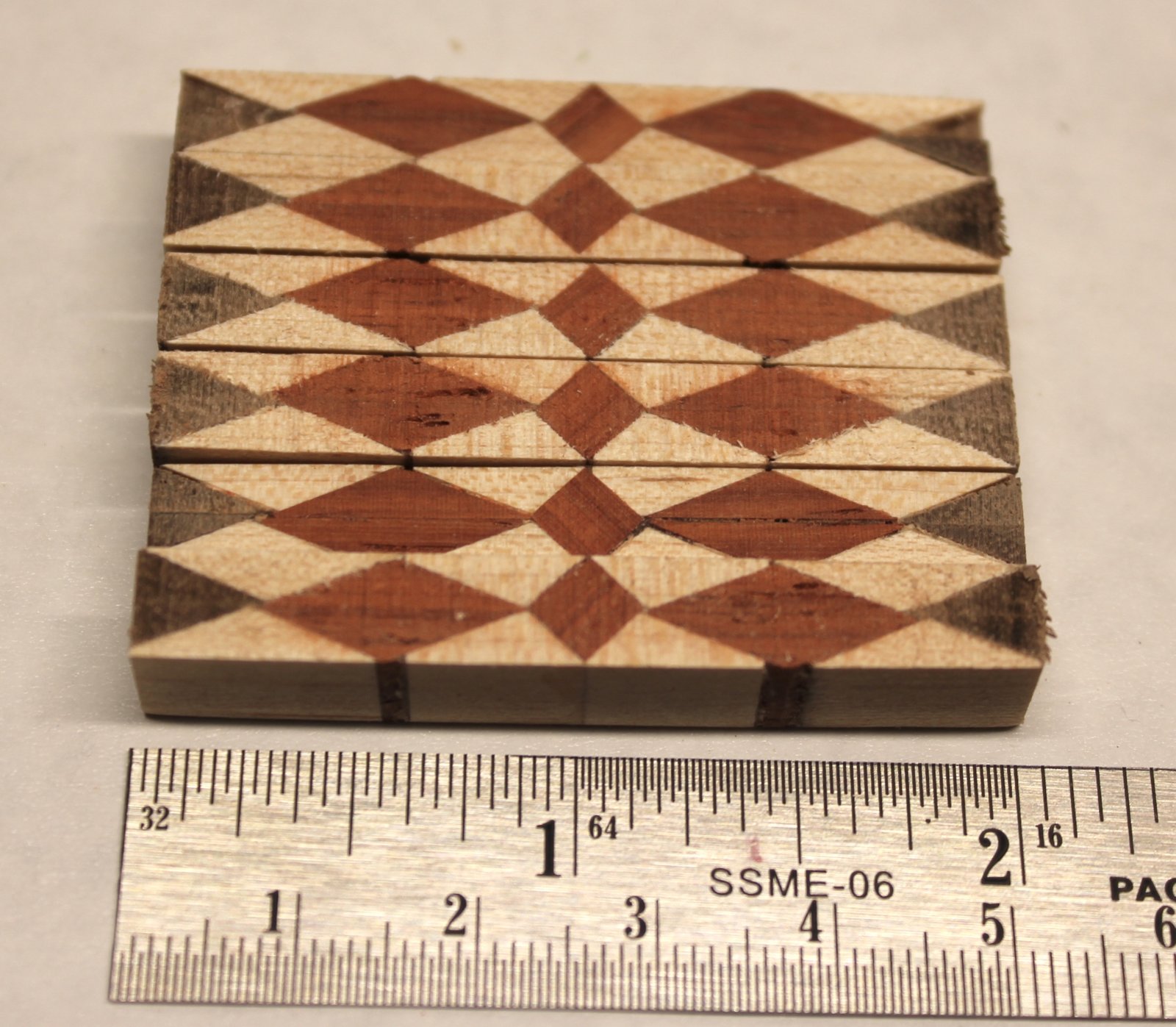

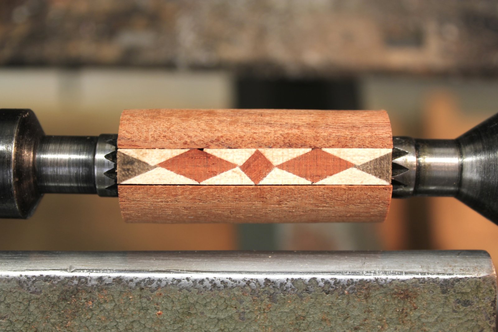

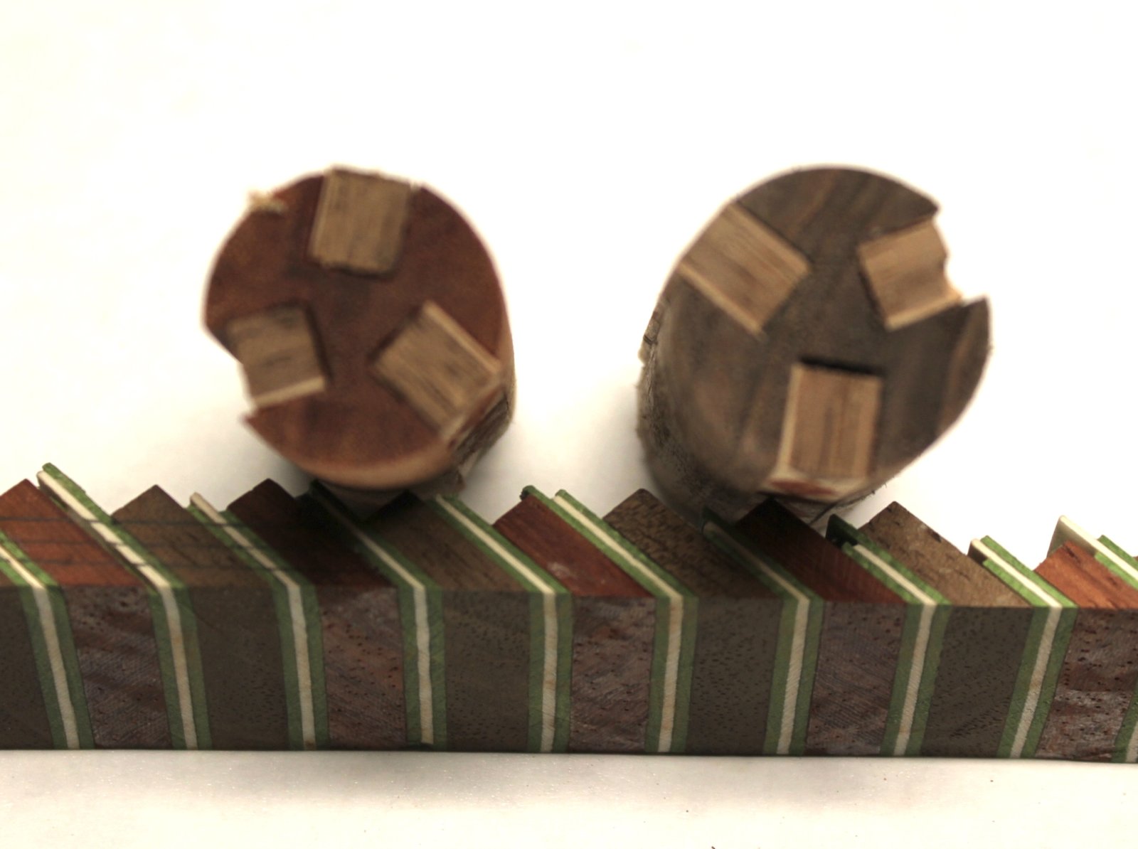

I changed the basic design from a 4-sided pattern, to a 3-sided one, which increased the size of the wood in between the segmentation. This meant I could not do the 4-corner assembly, but needed a slotted blank (cutting staves eludes me).

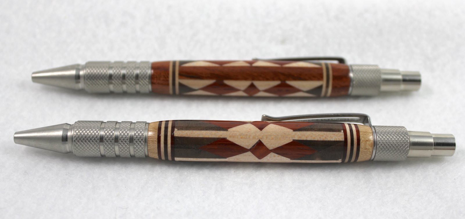

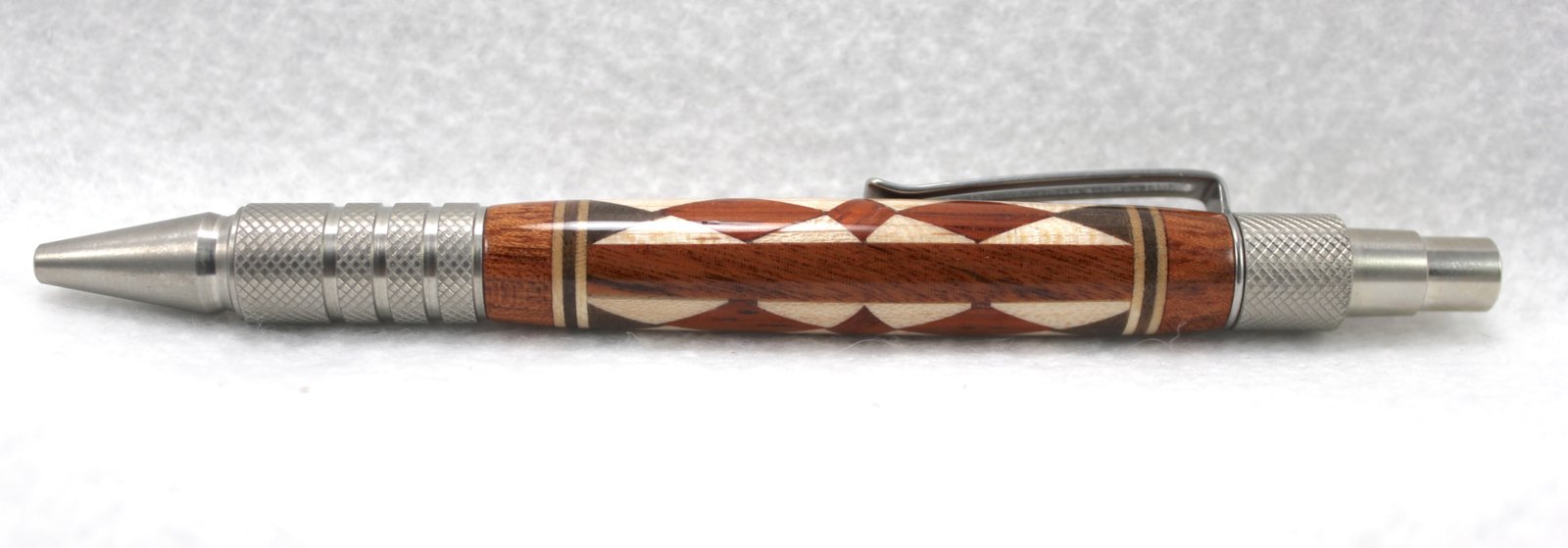

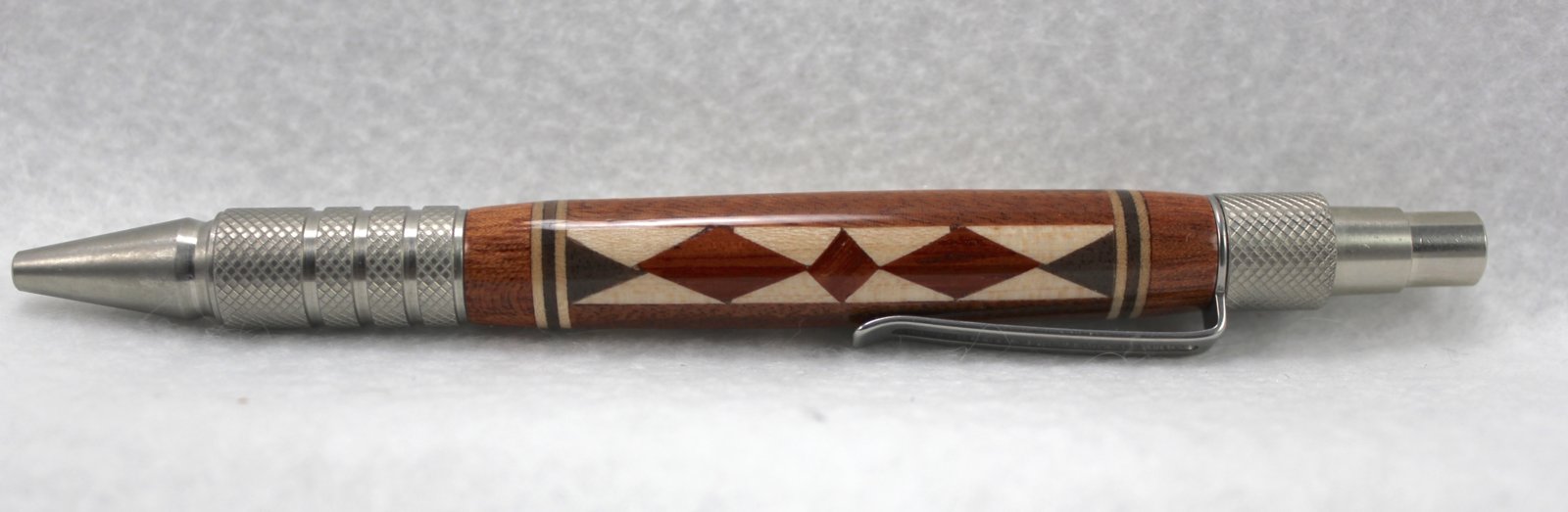

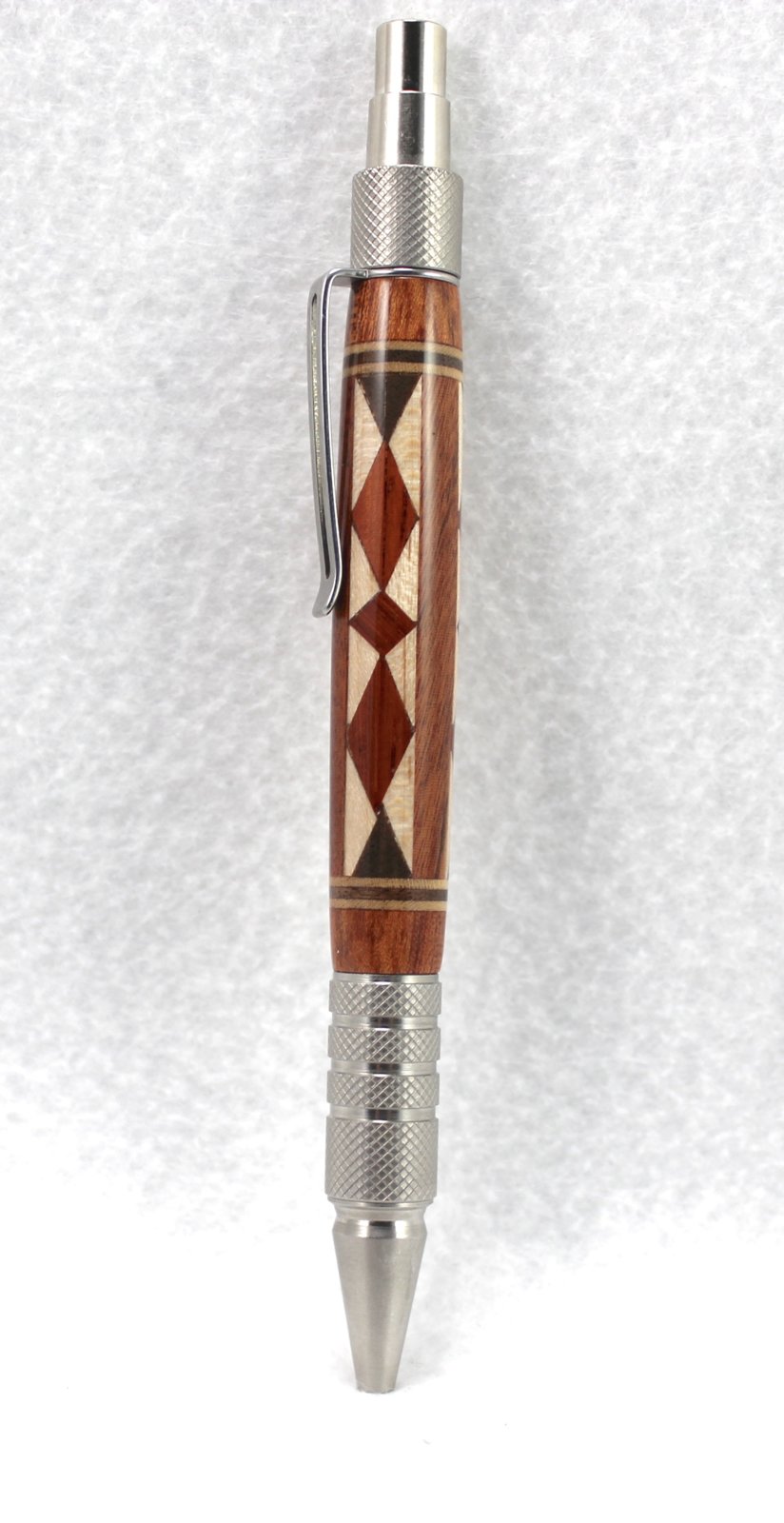

More importantly, I changed the pattern of colors to one that, IMO is more visually appealing. I swapped out the Maple starting blank for a matching red (Cabreuva ?). Pictures of the two pens show the changes better.

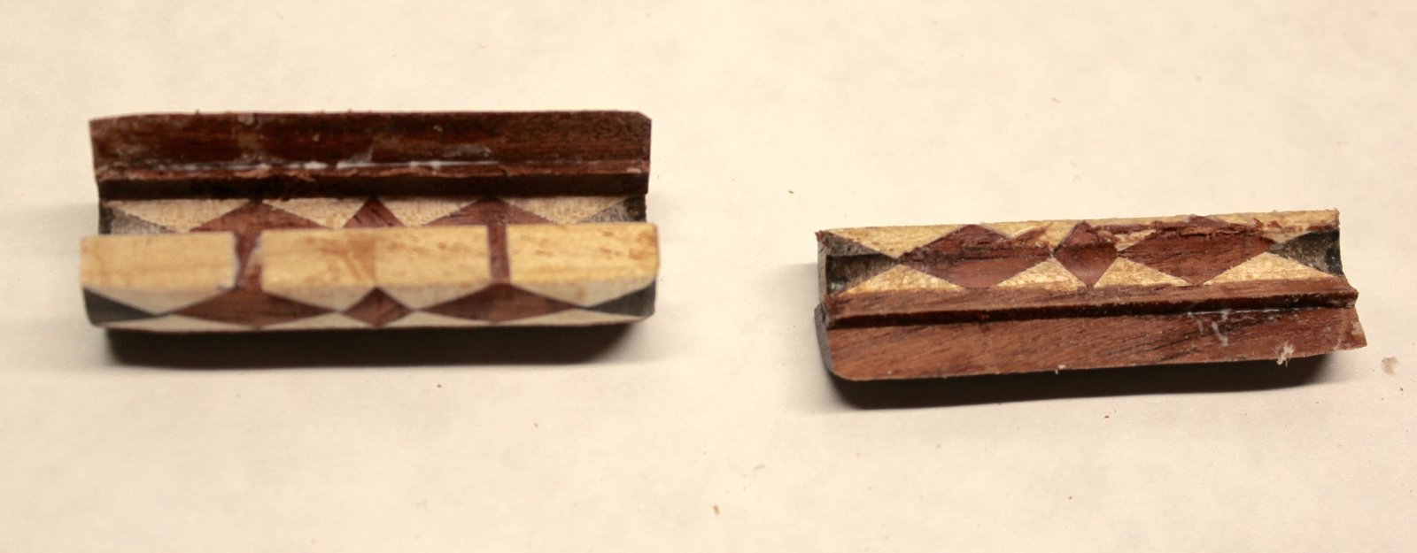

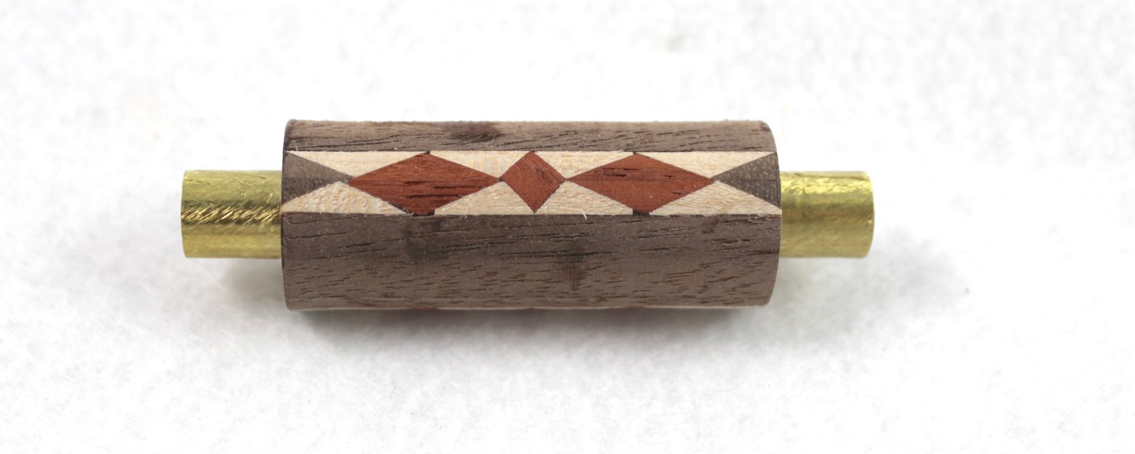

The last picture is another blank mid-assembly where I used Walnut for the starting blank.
As with version 1.0, the multi-angled segments were the fussy buggers. In this pen they are a bit more apparent.
Turned, sanding sealer applied, sanded, finished with Glu Boost. I'll finish the last blank, then onto a totally new design.
Comments, critique and typical beatings are welcomed.
