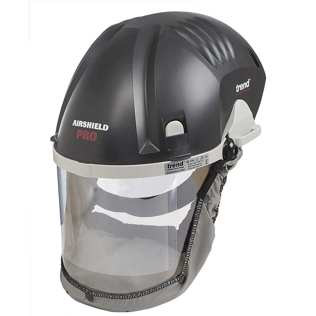

I would appreciate any comments from the membership who are using any of the Trend products.
After many months of working with my Pulmonary MD and several other Wizards, I have a tough decision on continuing woodturning. A 53 year vet of Asthma (now 62 yrs old), I started having increased lung problems in the summer of 2019. Final diagnosis is ABPA ( Allergic Broncho... etc, etc.). I am getting medications (more than the past), but even with my Cyclone dust collector and 1 micron air filter, external window vent and a fan blowing all dust, etc away from me at my lathe, I need to consider other options, or stop woodturning. I have previously regularly used an Industry Standard Respirator, but it is not comfortable. (Sorry for the huge ugly mug).
So... Anybody out there use the Trend products, advise, suggestions?
I wear glasses, had a thin beard which I know is not good for a good seal and will lose if needed.
I realize the cost, but considering my monthly asthma medications are $355, I am confortable and can afford this.
Comfort?
Maintenance?
Service/Repairs?
Quality?
Vision/Clarity?
Ease with thick glasses (I'm at 9 diopters
Any other thoughts?
Thanks in advance - I will do my own research, but value those with actual experience.

I have and have been using the Trend Air Shield Pro
Comfort - at first I thought it would be uncomfortable due to the battery and fan on top. It is too heavy but fits more like a hard hat. I recently wore it for a couple of hours at a time for 4 or 5 days in a row and it ended up being much more comfortable than I expected.
Maintenance - none this far, had about a year using on and off. I have checked and parts seem readily available.
Service/Repairs - same as above
Quality - decent. I got mine on clearance from a return at Rockler, so paid hugely less than retail. The way the fabric(vinyl) portion is made seems a little cheap but it is also what allows for a comfortable fit around the face. Even with a beard (that was a beard?) no issues since it is positive pressure.
Vision/Clarity - zero issues for me.
Ease with thick glasses (I'm at 9 diopters) - can't say, though I have worn mine comfortably with and without my glasses.
Any other thoughts - because you are running a fan in a plastic housing it does build up a bit of charge attracting a fine dust on the surface. I haven't tried any of the ways to overcome this yet as I just blow it off or wipe it down. I will say that the more I use it, the more I like using it.

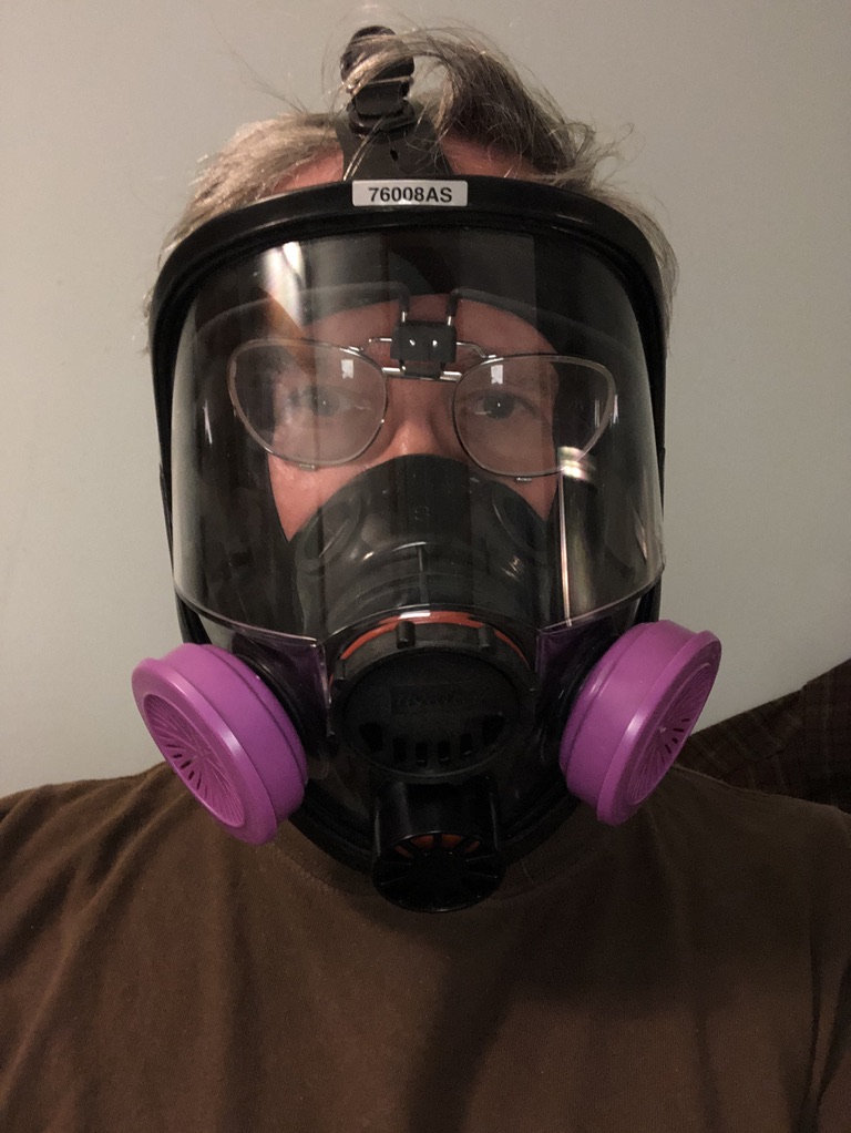

If cost is truly not an obstacle I would look into 3M products. I use their full face respirator with the cartridges that protect against vapor and dust. It works pretty good for. (I have a mild case of asthma).
https://www.amazon.com/3M-Cartridge...09ebf&pd_rd_wg=s88Fq&pd_rd_i=B009POHLRC&psc=1
If I could afford it I would use the 3M TR-800-PSK Versaflo Powered Air Purifying Respirator Assembly Painters Kit.

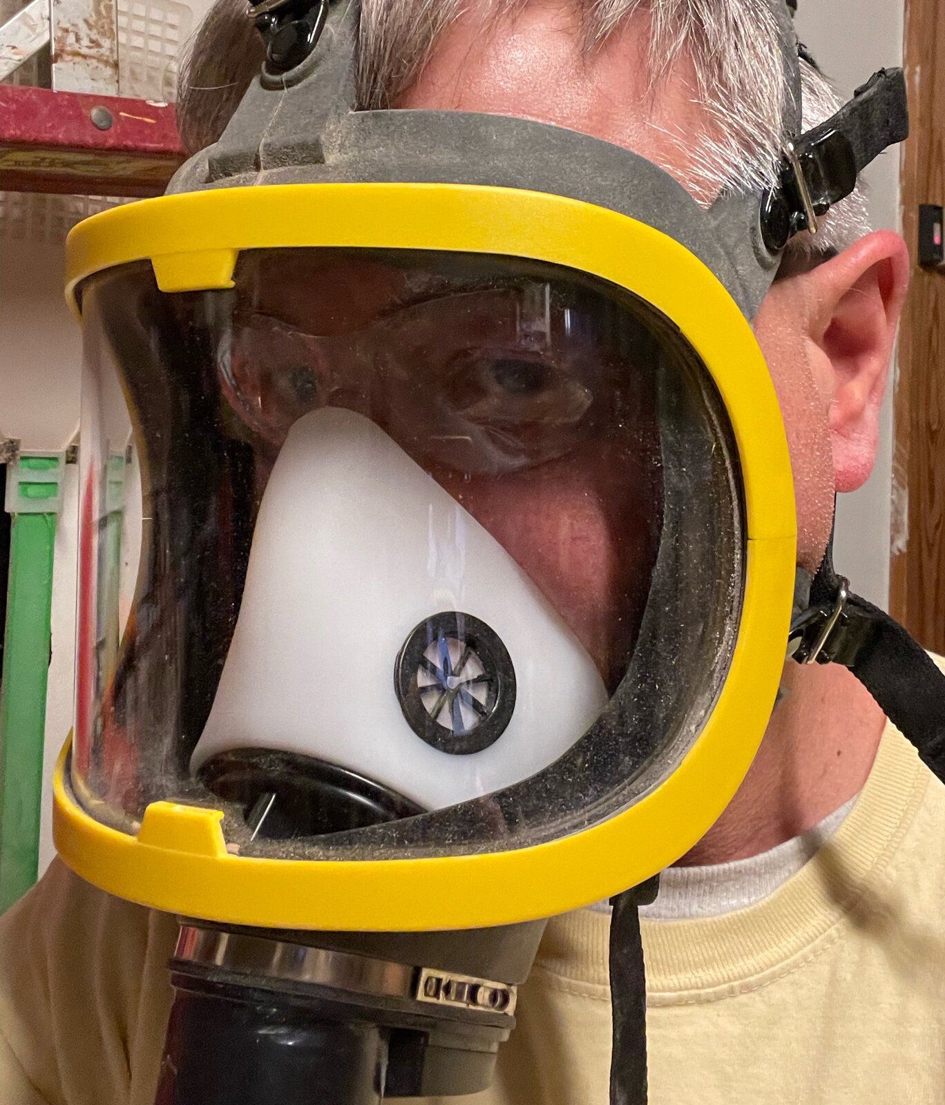

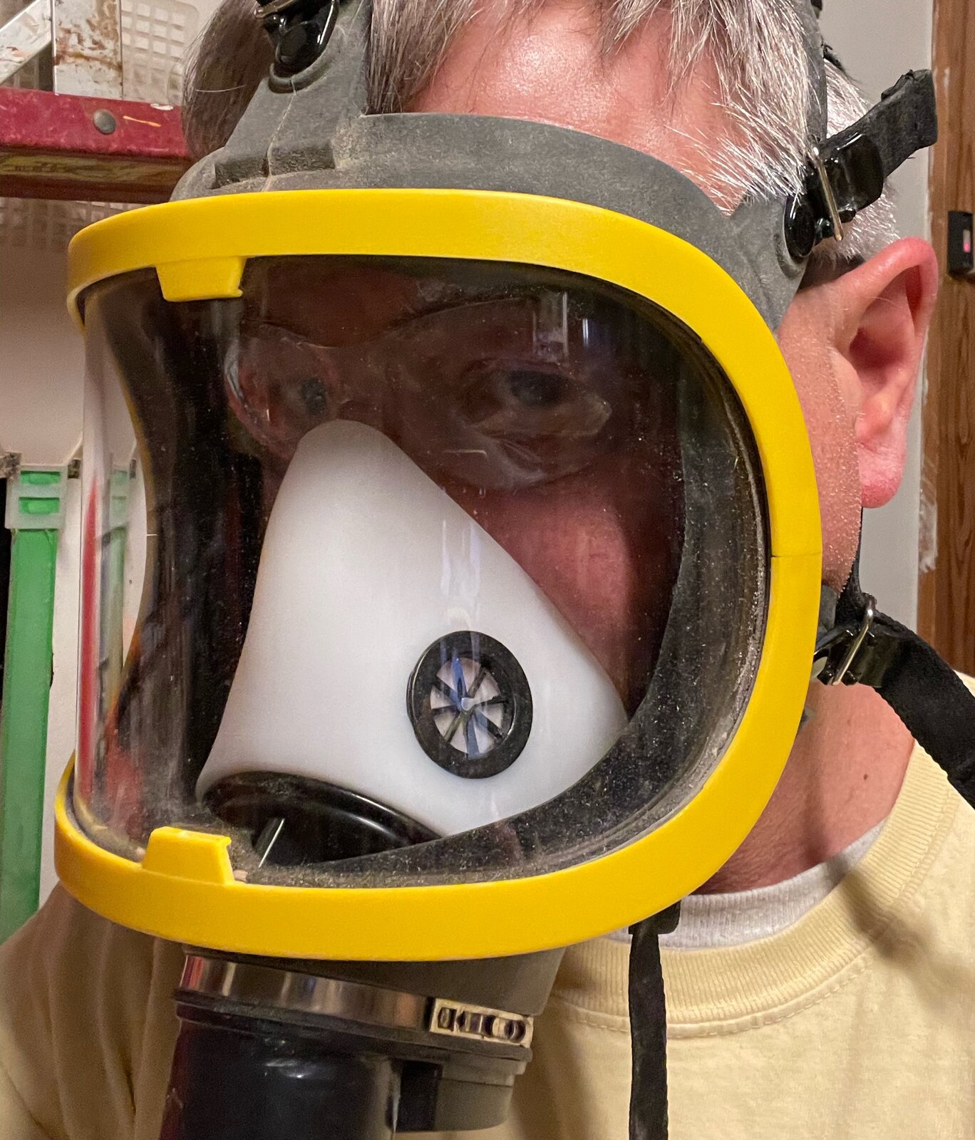

Interesting unit, looks like it could be worth a try. Question: have you worn glasses with it? It looks like the silicon portion of the mask comes up pretty far on the nose.

I tried It on with safety glasses and the silicon portion stopped short of the glasses. It's hard to see the separation in this photo.
Thanks for the test fit! I know the silicon masks typically fold back on themselves to creat a seal and the nose piece looked huge. Glad the is a gap there to allow for glasses.
Thanks for the photos Cody. I am a SCUBA diver and the white section concerns me. It looks like a tight hard fit, with little 'soft' transition between the skin and the 'element.' In SCUBA diving, we are used to insure an air tight fit (Breath in after the mask is mounted). So I am used to some logical discomfort to insure a good fit. I appreciate the photo and your comments. And the hose at the bottom looks HUGE! - 3'' - 4" ?
The actual hose cannot be seen in my photo, it's approximately 1 1/2". The white section is flexible and soft so there is no discomfort. If anything, the fit around the mouth and nose may be a little loose.
