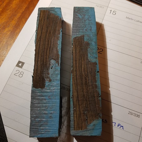

Tree bark blanks
Beautys_Beast
Sep 27, 2017
161
Wisconsin/
This is what they ended up looking like. The bark goes all the way through the blank. Will attempt to turn today or tomorrow.
