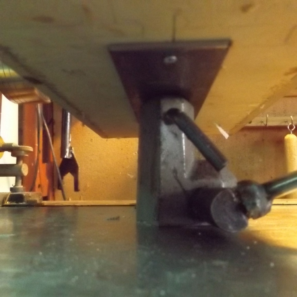

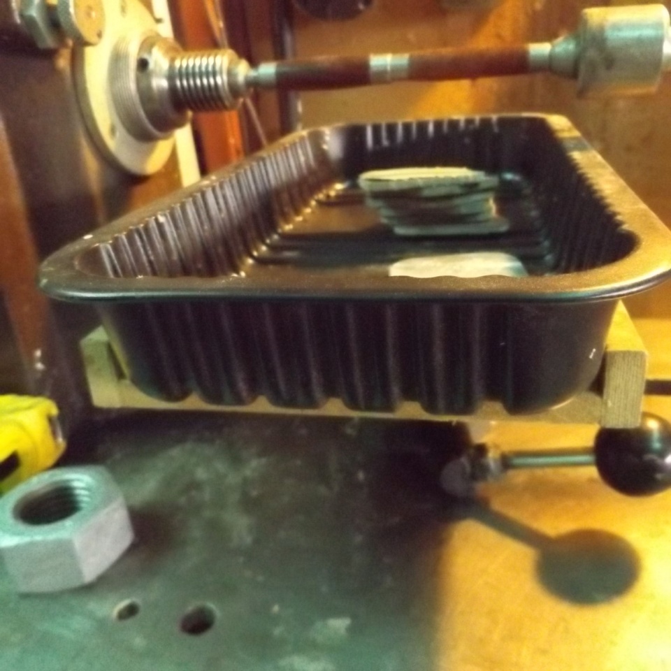

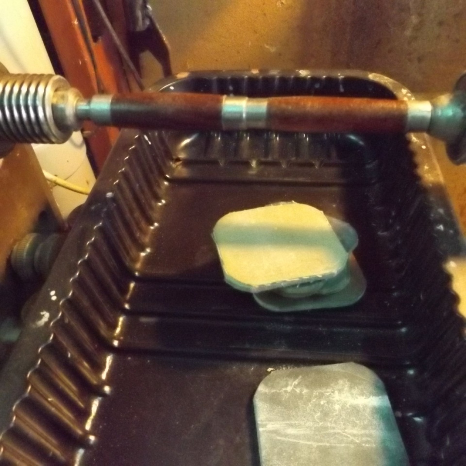

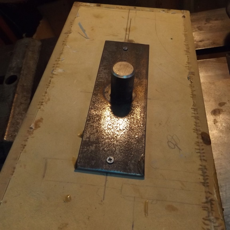

This is a tray stand I made for finishing my pens with Micromesh, to save water getting onto the lathe bed. The tray is what the meat comes in from the supermarket, so they are readily available, when it gets dirty throw it out and grab another.
The wooden base is made from MDF, you can choose what ever you like/have at hand.
From right to left
Underside details, where it goes into the banjo.
Underside pic of how it sits on the banjo.
In position, ready to use.
Hope this makes life easier, no more covering the lathe bed with towels, sheets, what ever you use.
