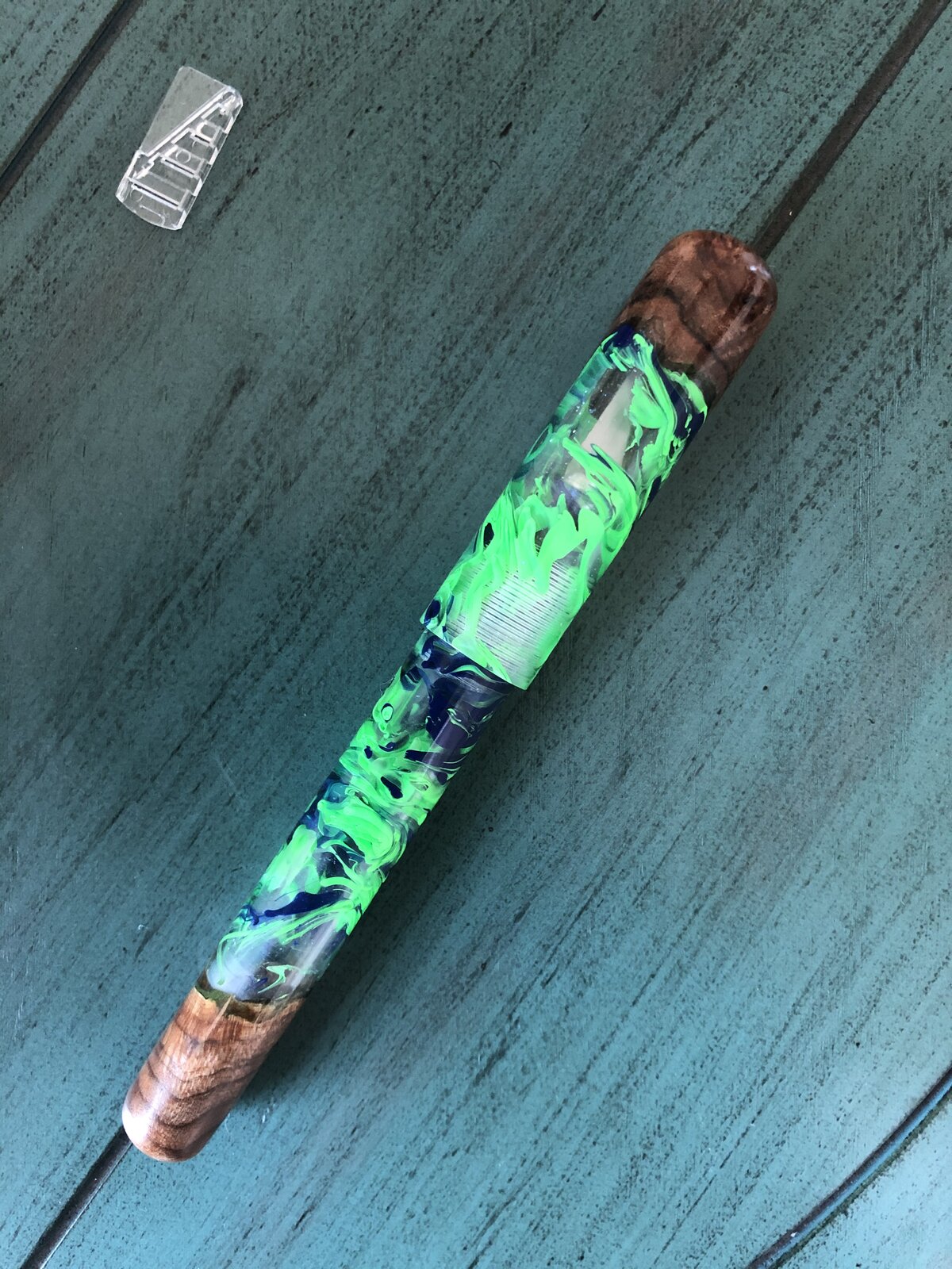

A Midwest Hybrid blank which is simply stunning and impossible to capture in photographs. The burl was perfectly stabilized and the color swirl is perfect
M14x.8x3 cap
M10x.75 section
polished inside and out

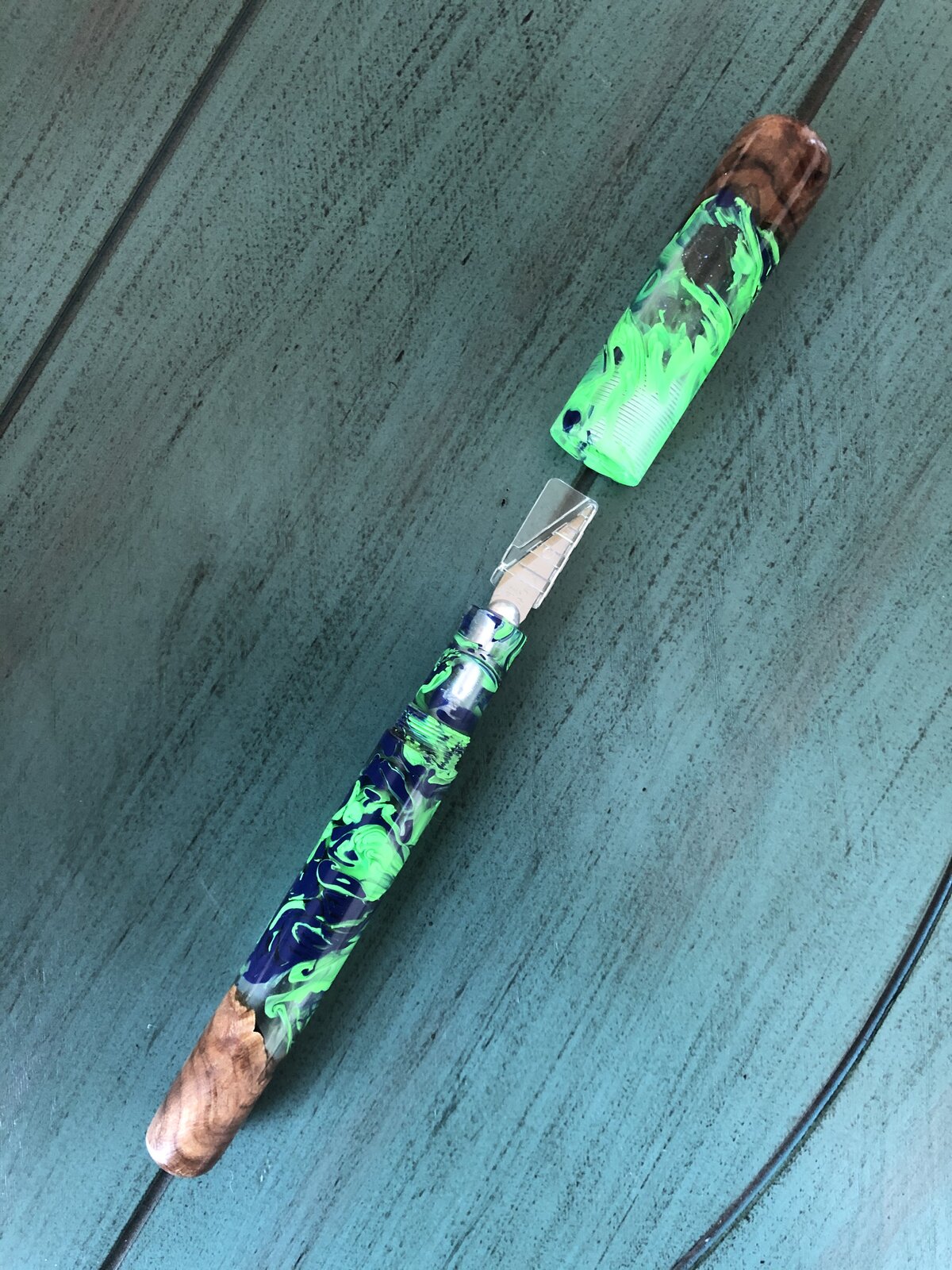

Thanks for the exploded view in Pic #3.

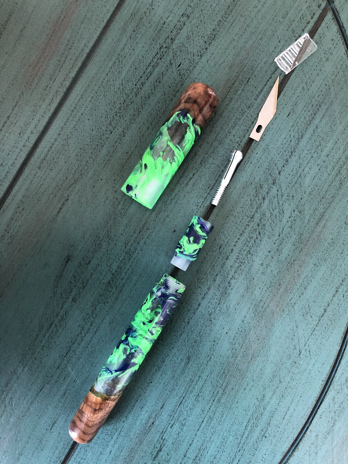

Based on Pic #1, is it fair to assume that the blade guard does not fit inside the cap ? . ( .... even tho' Pic #2 seems to suggest that it does .... )

The blade guard/blade wrench does fit inside the cap.

Where do you buy the parts for the knife ?
I can see that building these might be a good intro to building kitless FPs for me.
Making the body, cap, and "section" would be similar.
I already have the required taps/dies, although my 10mm has pitch of 1 and I'd prefer 0.75.
I'd like to try my hand at the internal polishing on a semi-transparent blank like this.

Hi Mal
I snag the collet and blade from a standard X-acto kit. I believe it takes a 10-24 thread. X-Acto No 1 Precision Knife | Z-Series, Craft Knife, with Safety Cap, #11 Fine Point Blade, Easy-Change Blade System https://www.amazon.com/dp/B005KRSWM...abc_PSZ2HP5CMX941K4XQG13?_encoding=UTF8&psc=1
or you can use a generic which takes a metric thread
