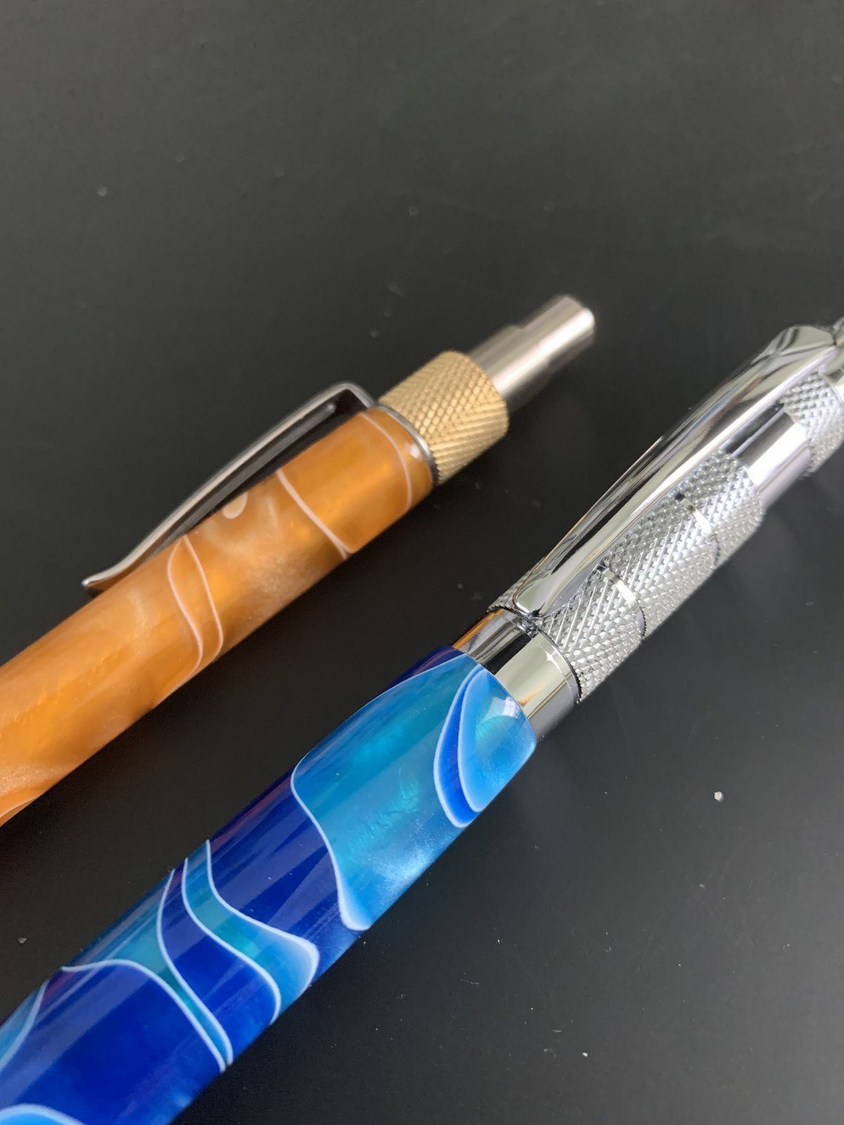

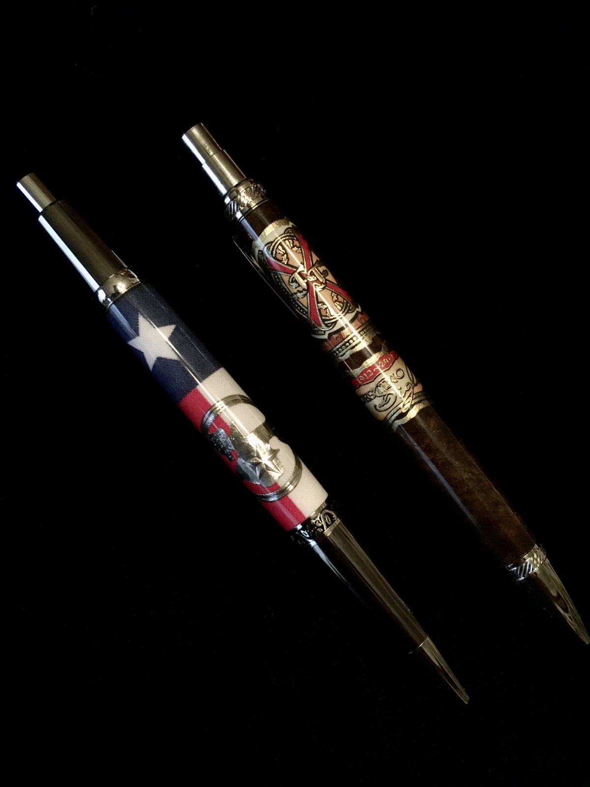

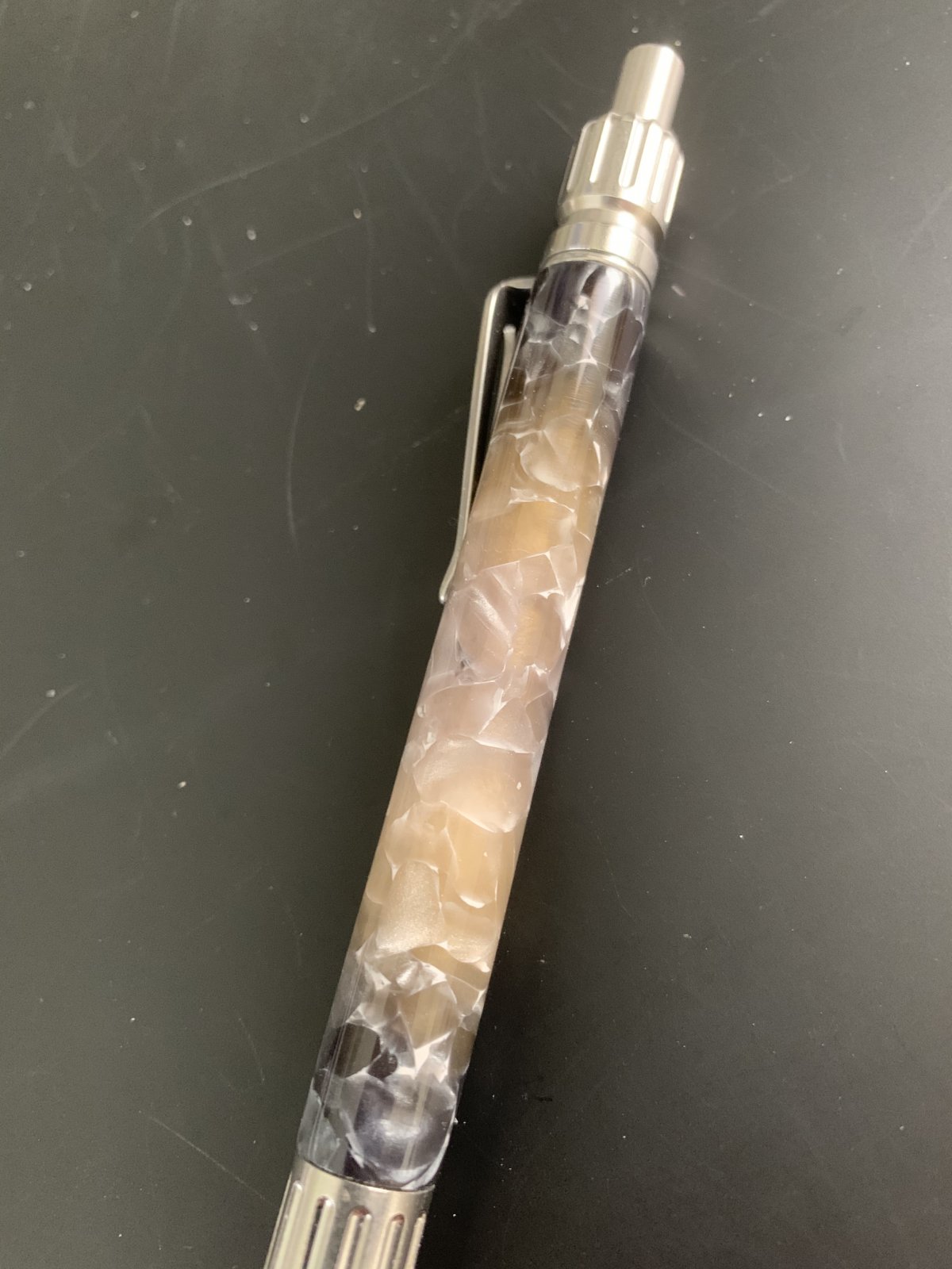

I painted the inside of the drilled blanks for both of these pens using Rustoleum 2X paint/primer. Its annoying having to let them dry overnight, but it prevents any glue splotches from being visible. I personally like transparent or partially transparent blanks because of the depth they have in their appearance.

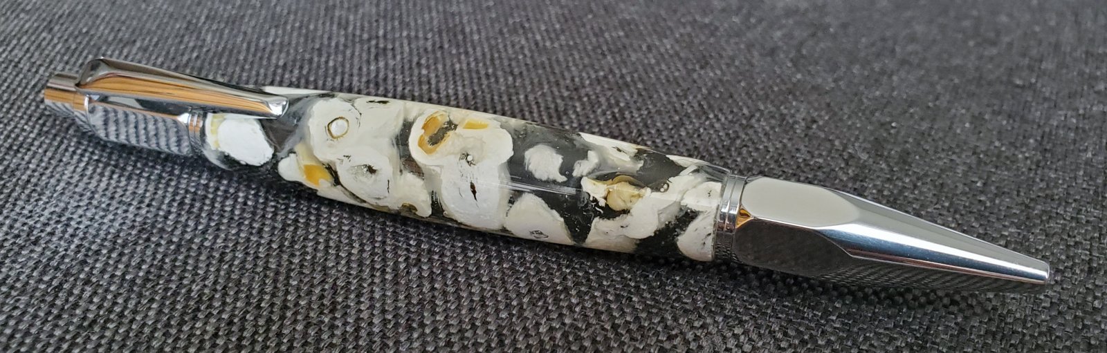

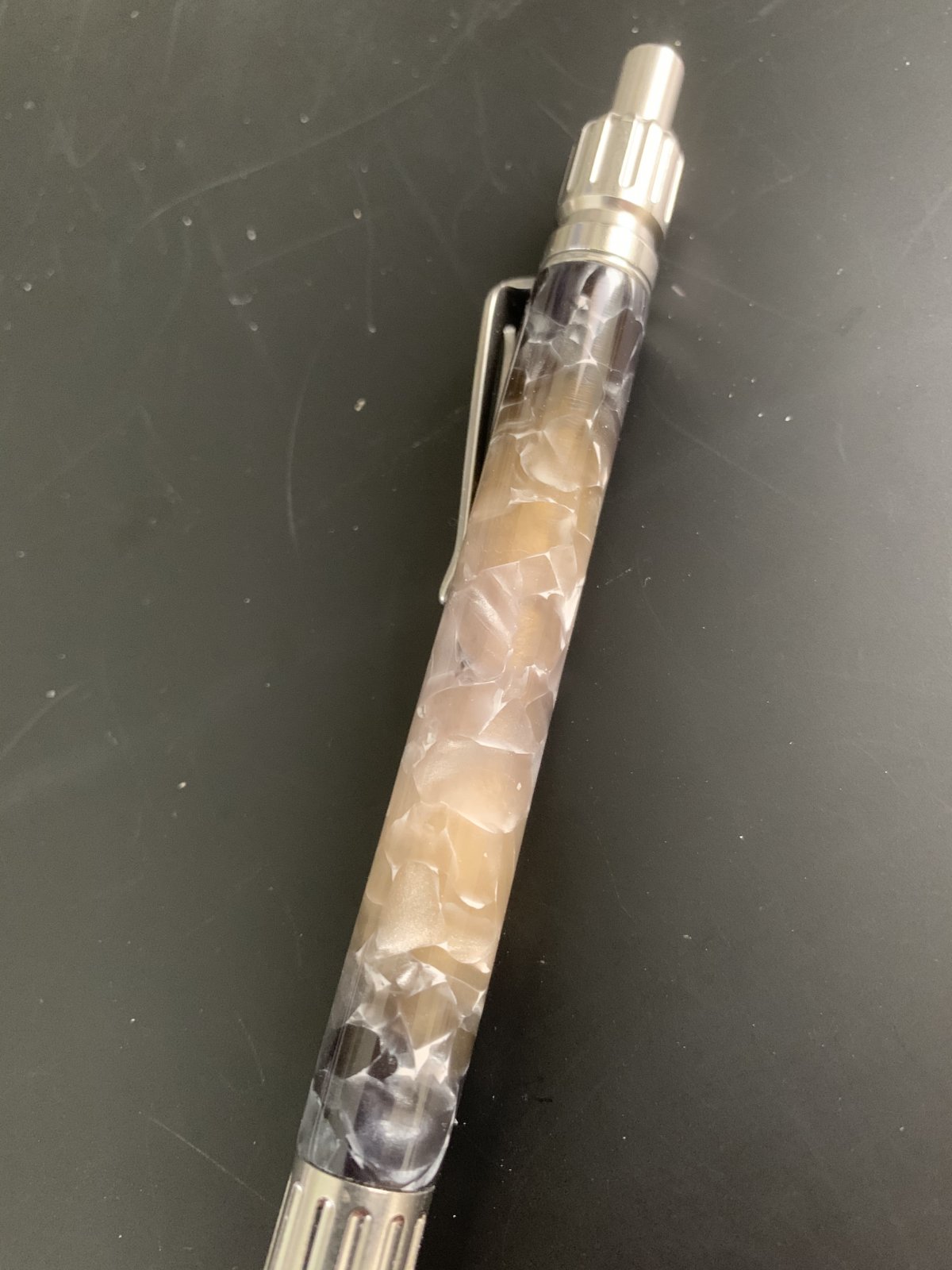

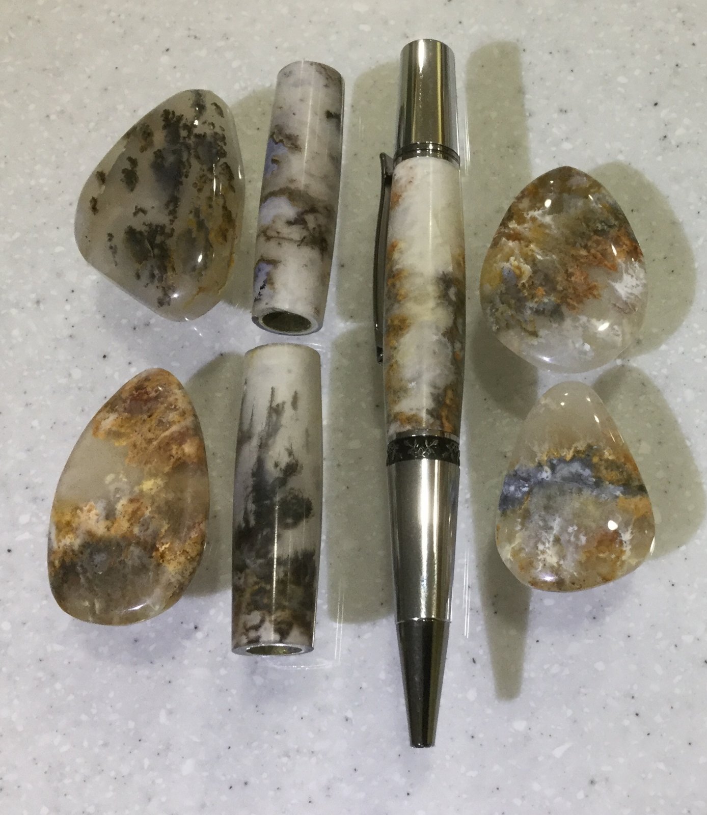

In my case, many of the materials that are especially attractive are transparent, translucent or semi-transparent. I'm currently working almost exclusively with gemstones. Agate, for example is by definition semi-transparent or translucent. Even petrified wood is often "agatized" and needs "painting" to prevent the tube from showing. My first experiments involved actually painting the tube and the inside of the drilled hole. Paint is a relatively poor material for adhesion and I had several pieces blow up while shaping. The ultimate solution for me has been to use dyed epoxy as the glue, either black or white depending on the material. I acknowledge that wood has a lot more flexibility and stability compared to stone which is extremely brittle and often has micro fractures. My wall thickness can be as little as .041 so having good support between the stone and brass tube is essential. My techniques often call for drilling .019 - .036 oversize which means I have plenty of epoxy thickness for ensuring material support and dye coverage.
Here are some examples of pen tubes made with plume agate. As shown in the cabochons made from the same material, much of the material is semi-translucent.

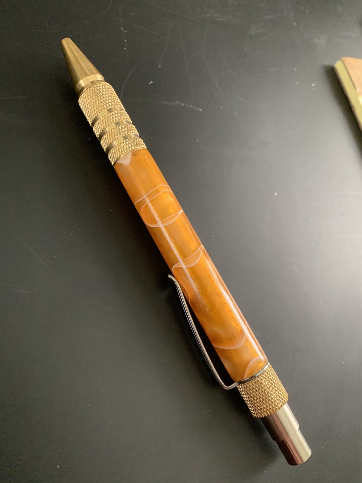

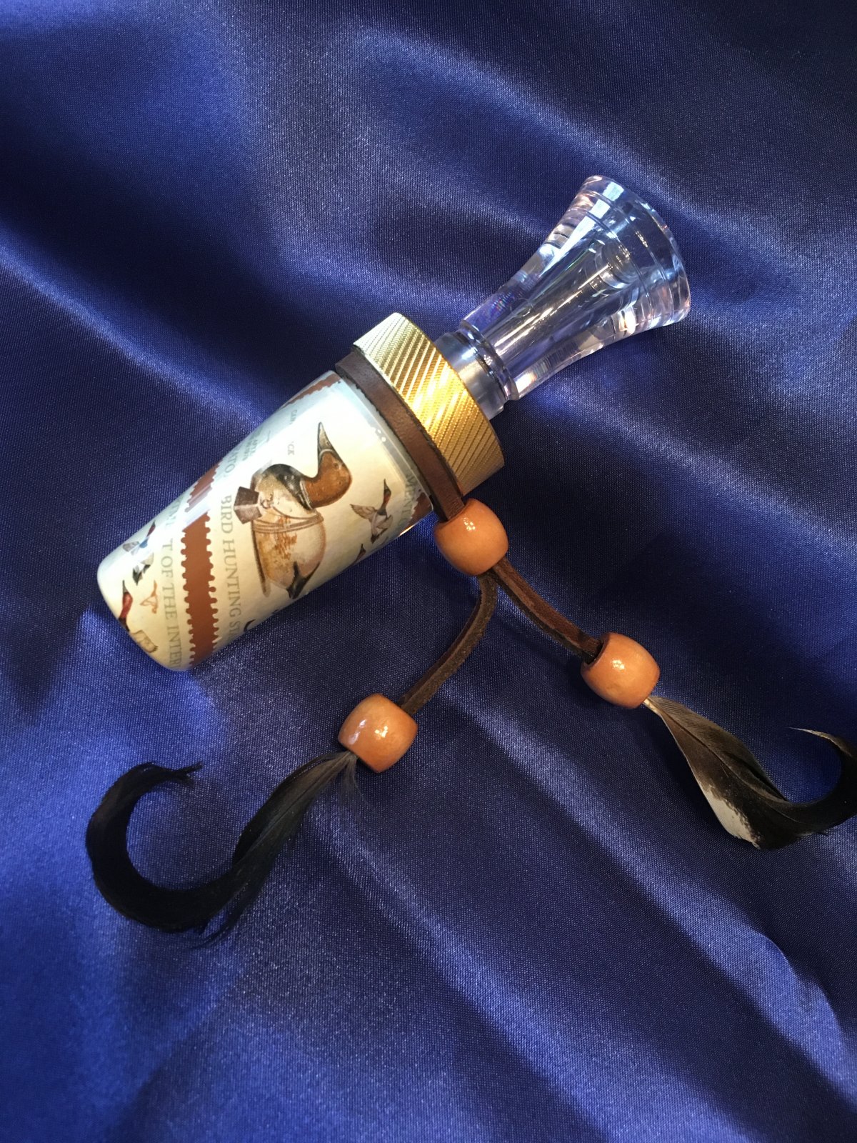

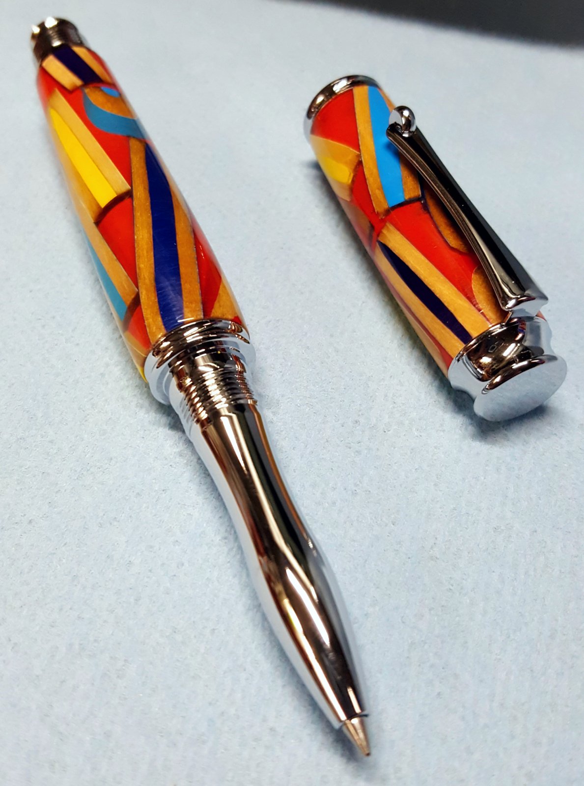

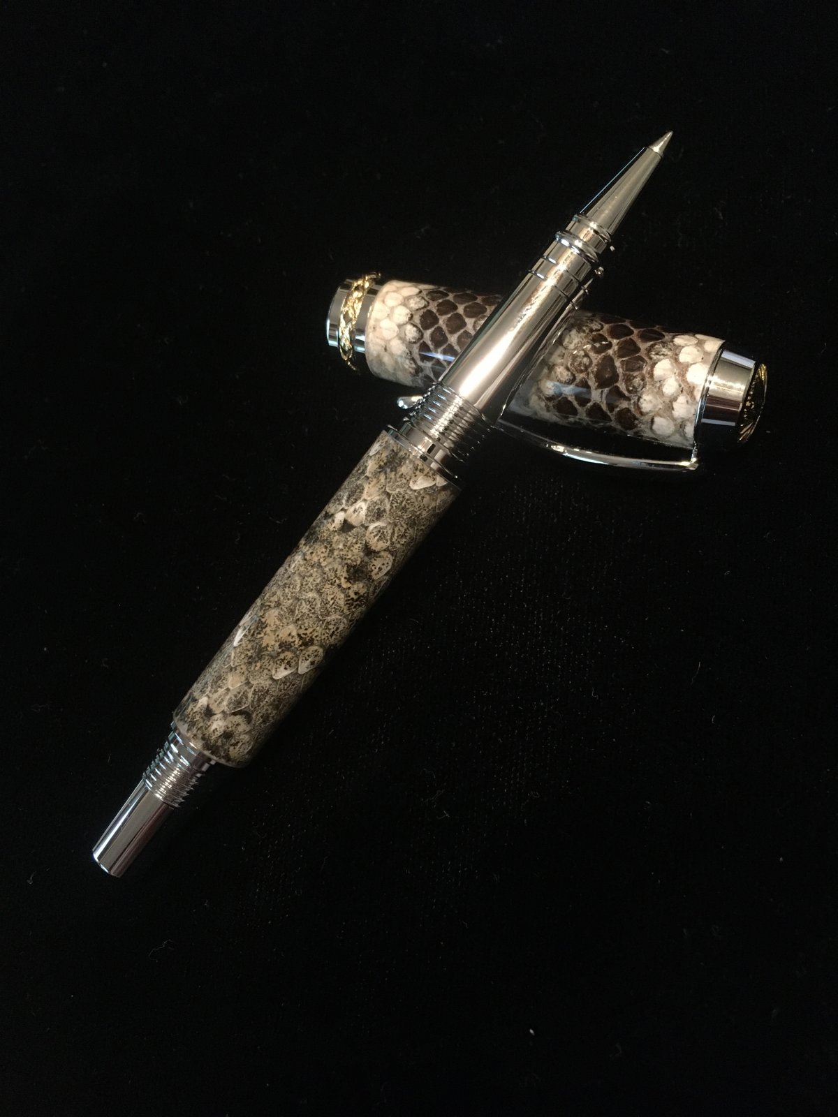

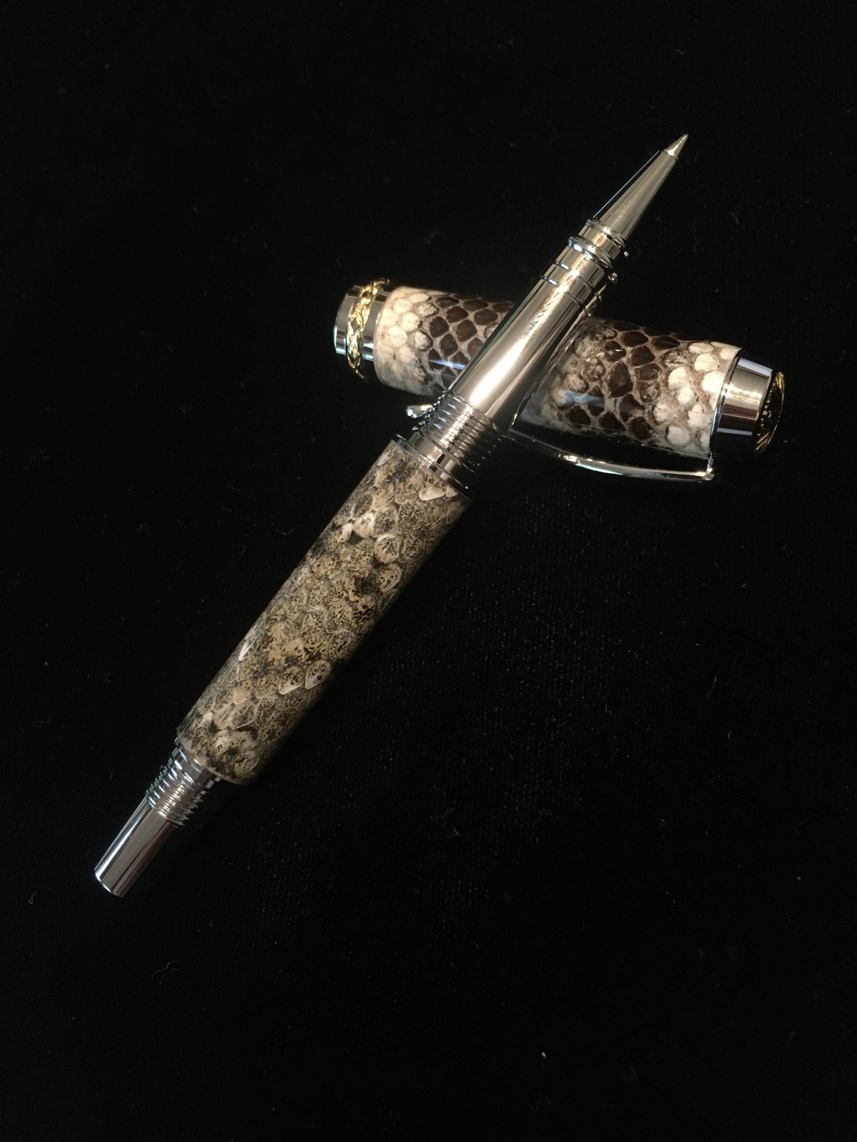

My opinion of see through might be a little different than yours. If you can literally see through the blank I'm not a fan of it. These I see mostly have a tinted resin with colored ribbons in it. As far as seeing a reflection of the brass tube, to me that's just part of pen building or turning. Most of what I do is clear casting. I'll glue something to the tube then cast in clear resin. That brings painting the tube a big plus for what I'm doing. Snake skins I can change the tint of the skin to match a plating of a kit or to darken or lighten a piece of cloth. 6C576DA0-E6A1-47CF-B724-50C0CF3CCA3B.jpeg79C42442-AD16-434B-A5AB-8622D54DA70B.jpegC5A0C3B1-C56D-49EA-8DA7-7F9AB253D851.jpeg

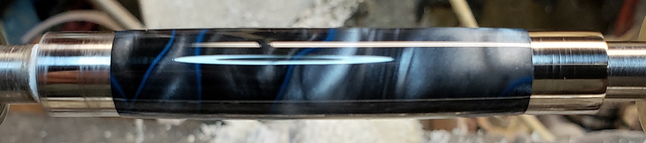

All of the above are exceptional, but look at this one in which JohnT goes with BLUE in comparisons with other colors.
And look at the YouTube in the link of this thread:

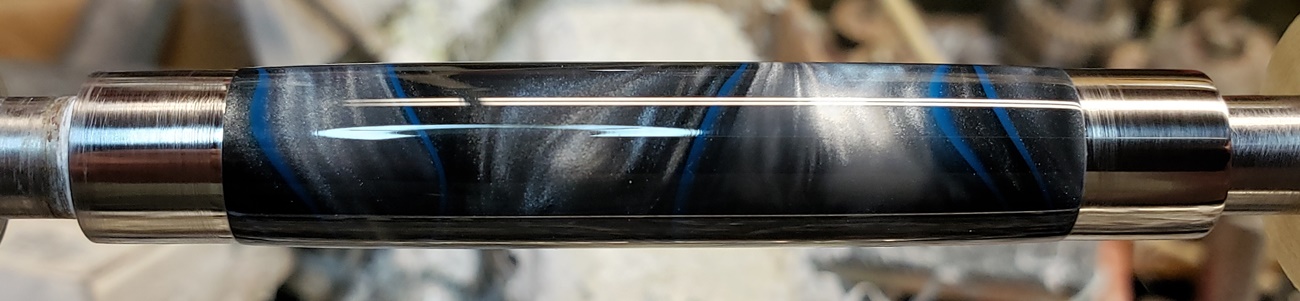

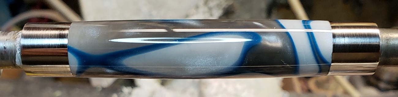

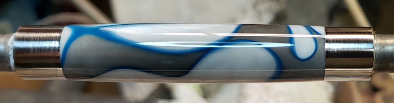

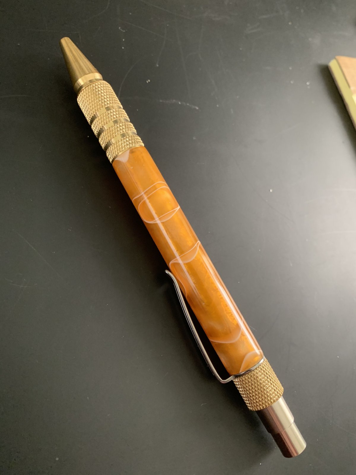

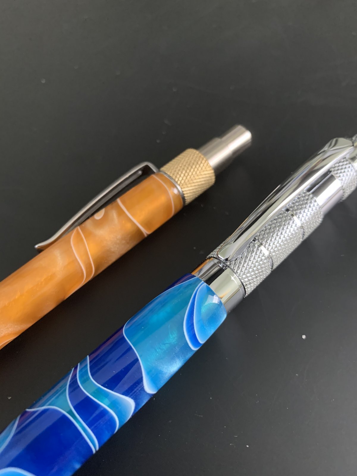

top left shows brass but it works. Blue on right shows brass and looks like it has processing flaws. Bottom is a strange blank and tube shows but it looks good in its own way.

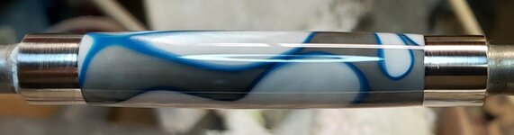

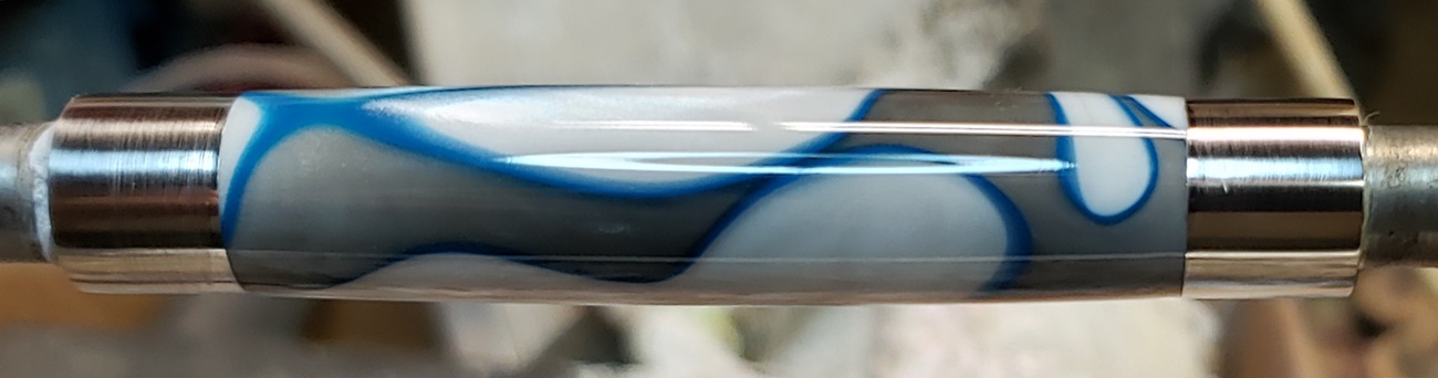

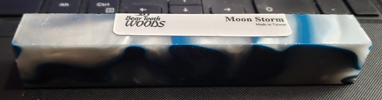

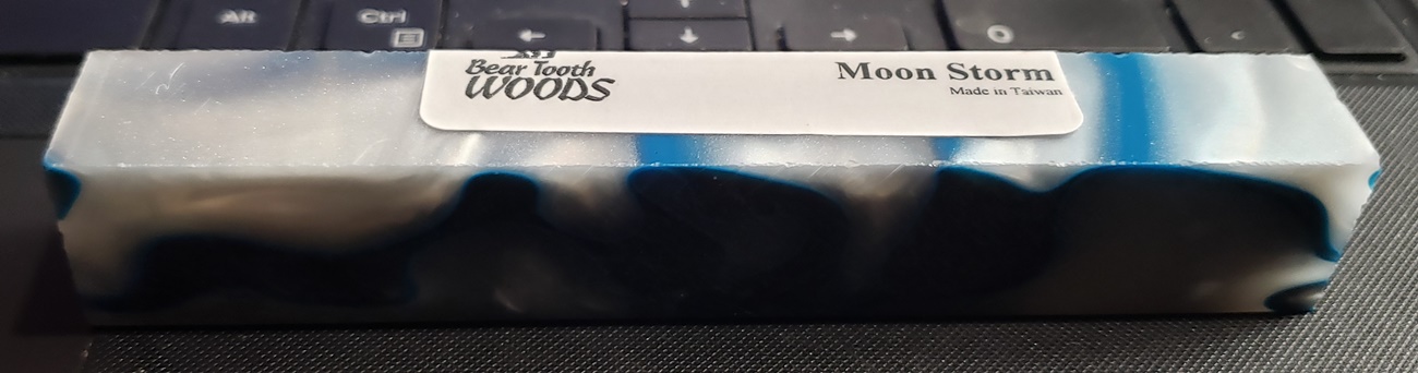

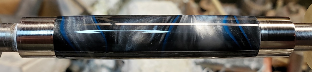

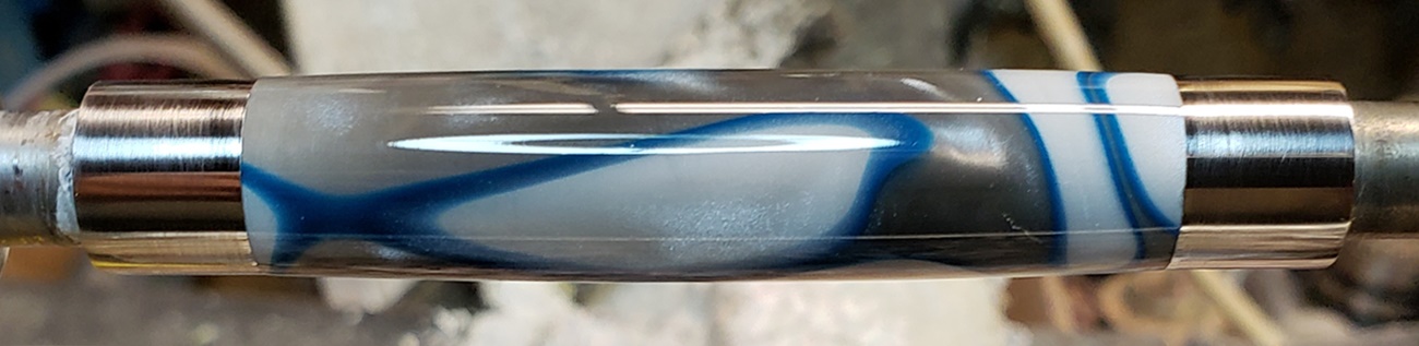

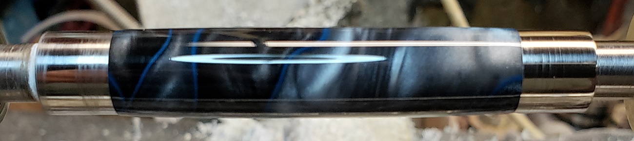

These are both pieces of the same blank. One was back painted with white, the other with black. It's amazing the difference between the two.
