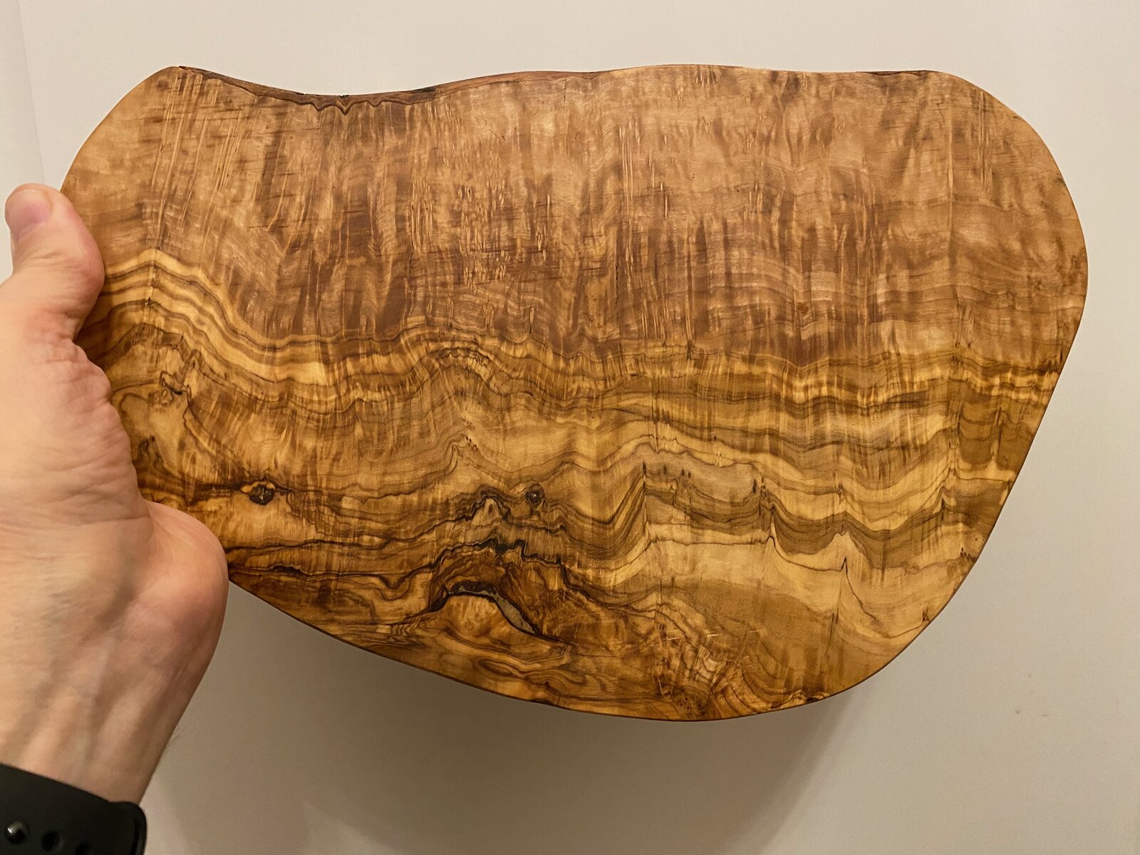

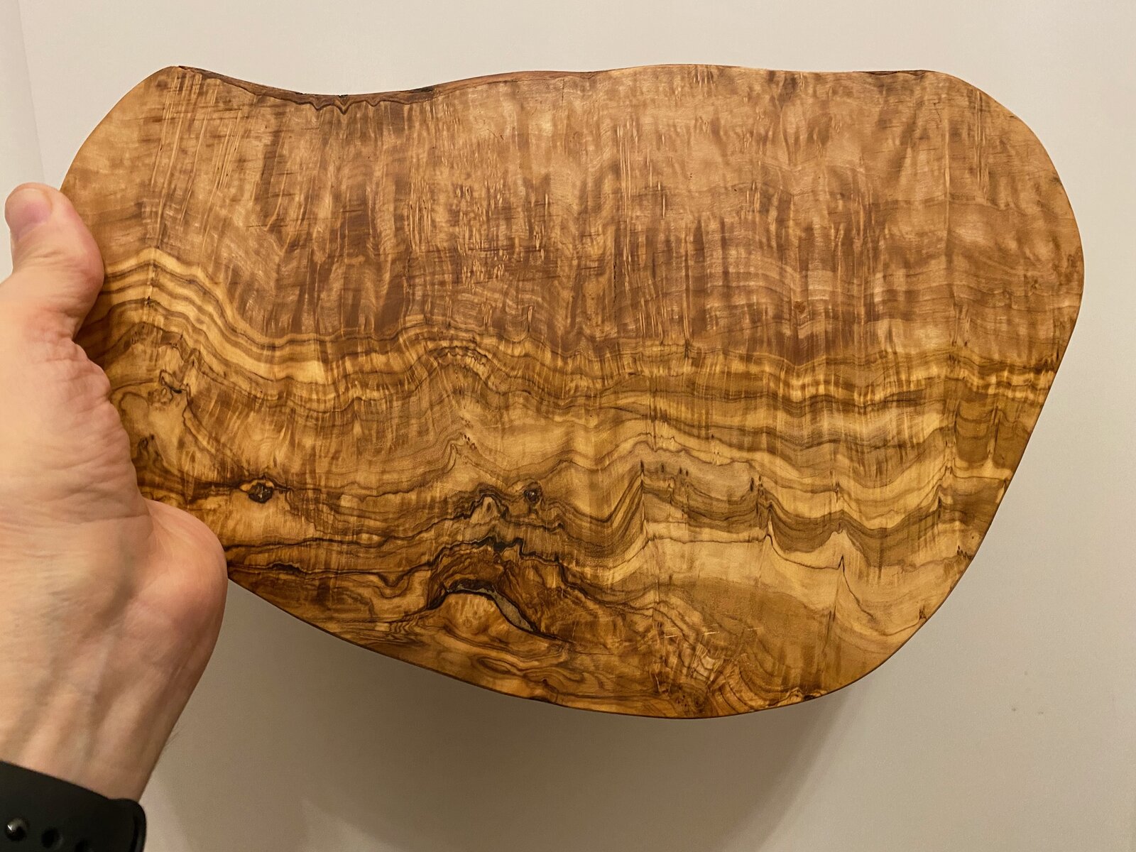

Grabbed this while at Trader Joe's this afternoon, only $12.99 and is about 12" x 7" x 3/4".
I think there are a few beautiful pens hiding in there, what do you all think?
The real question is how to cut it, with the grain, across the grain, or diagonal...

Definitely cut it longitudinally/horizontally based on this picture. There are a ton of great blanks in that picture and if you cut vertically you'll miss out on all those curls.
That's about the prettiest olive wood board I've seen that comes from an inexpensive cutting board. I will love to see what the end result is.

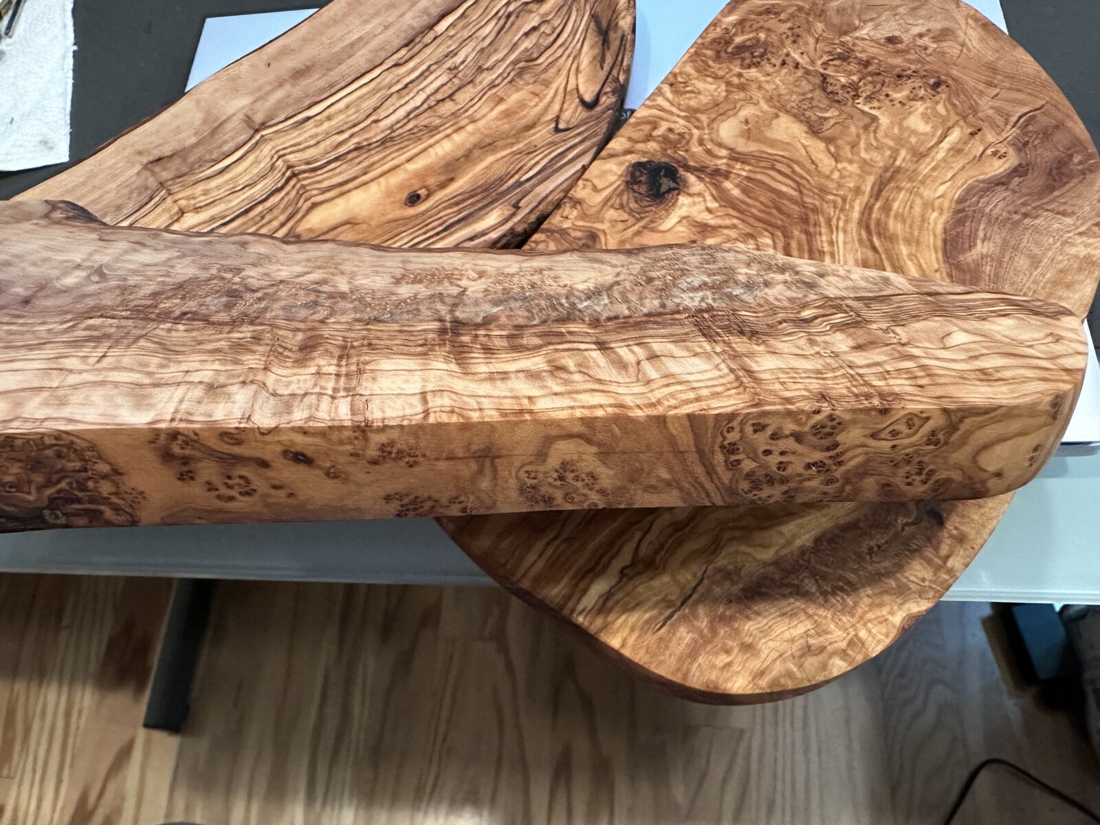

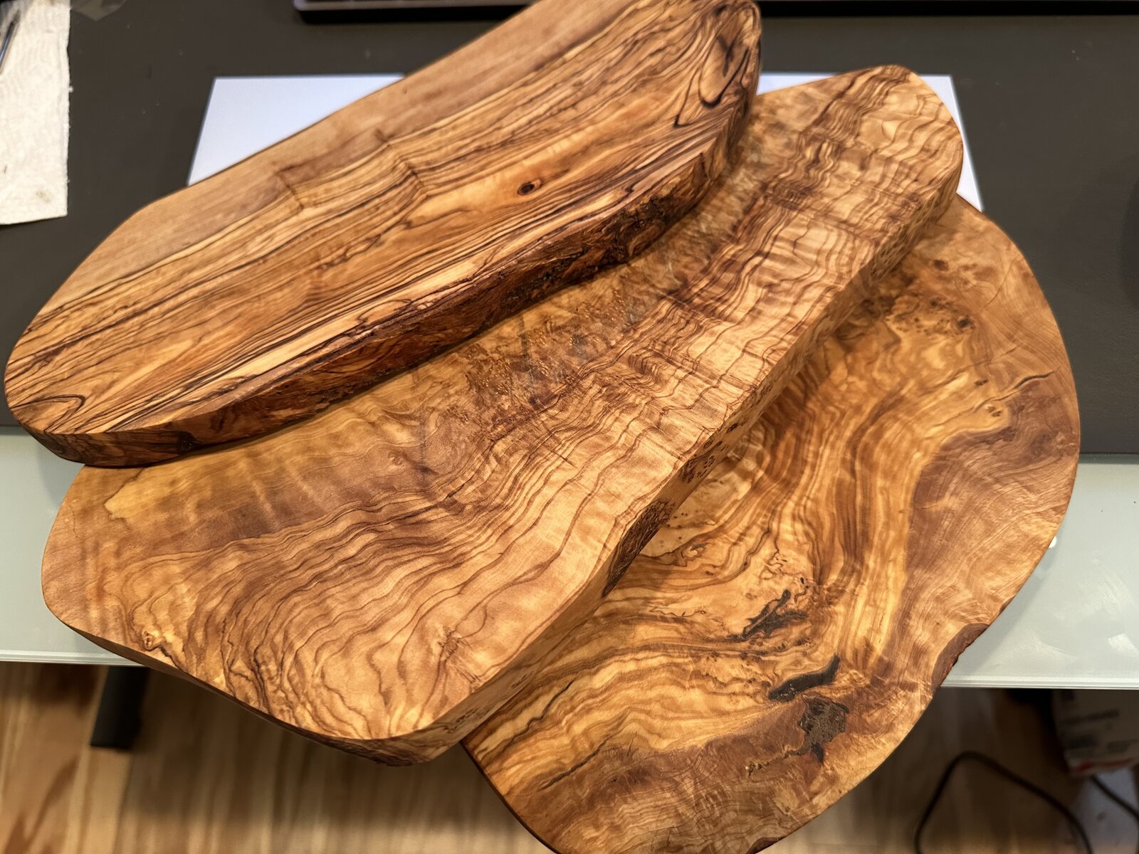

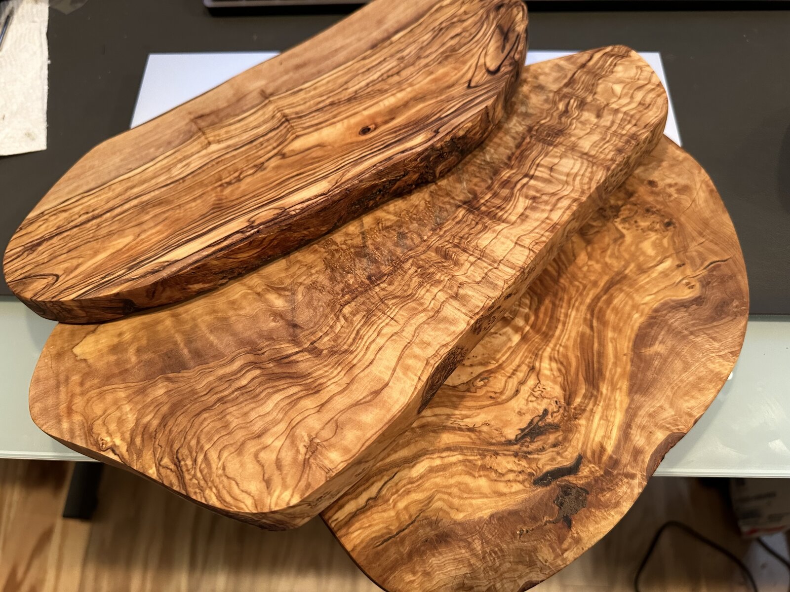

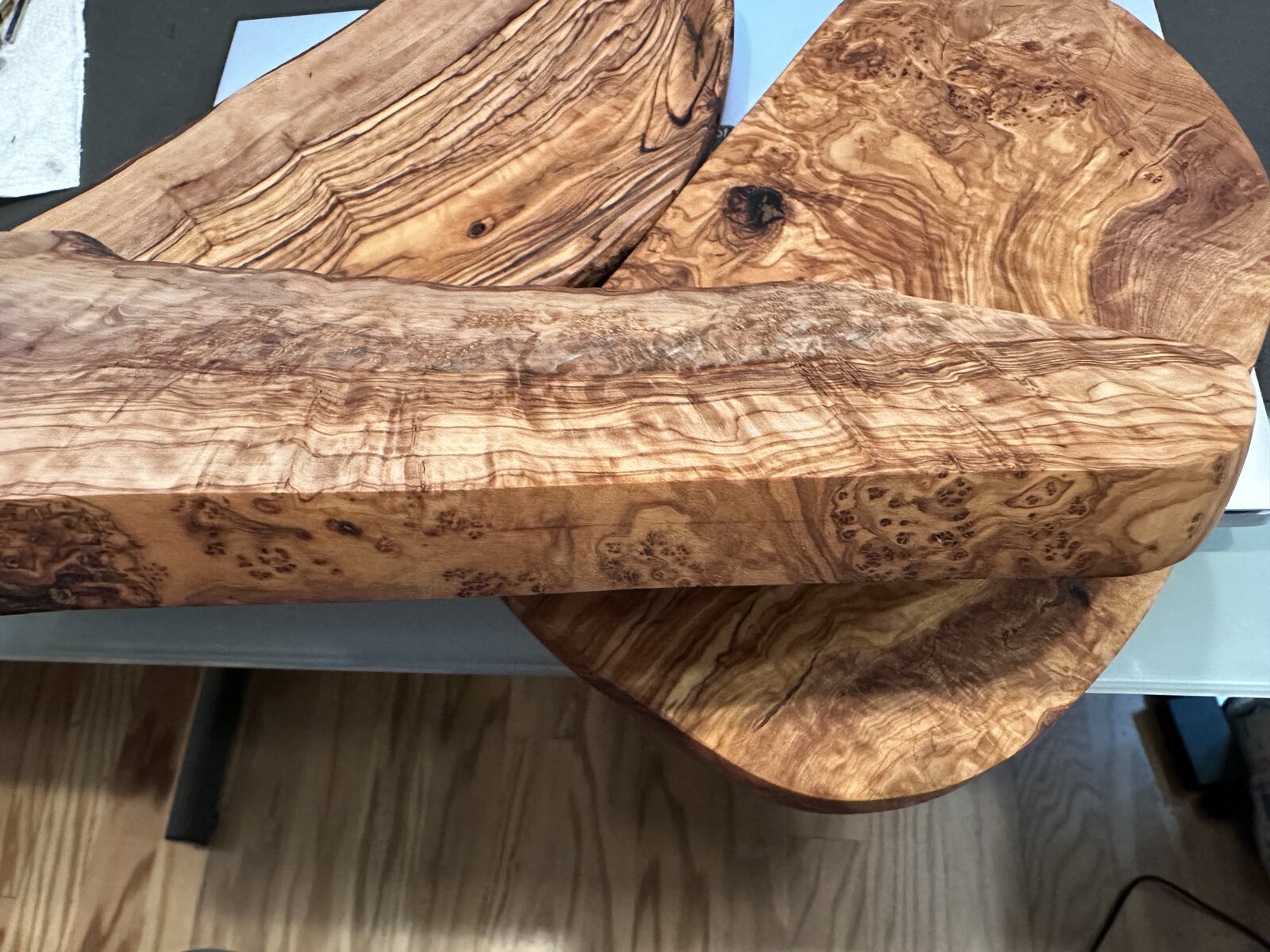

I'm pretty happy with my haul as well. I had to go to three different Trader Joes' until I found one with the bin of cutting boards. The others only had bowls or pre-carved serving platters.
I even got some nice burl figure on one of them along the edge...
I'm pretty happy with my haul as well. I had to go to three different Trader Joe's until I found one with the bin of cutting boards. The others only had bowls or pre-carved serving platters.
Wow, those are really nice. That is a great haul.
I went back to day and didn't find anything else nearly as nice. Even tried another store in town (we have 3 within about 10 miles) and that store had none of the olivewood stuff at all.

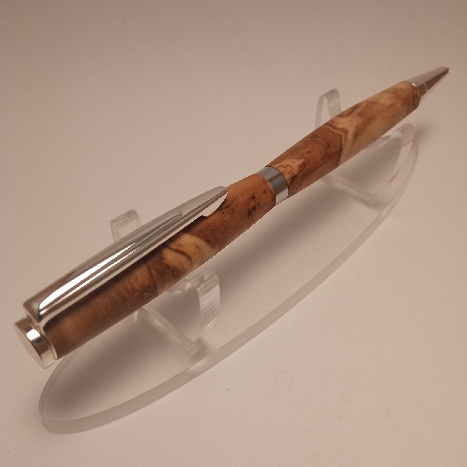

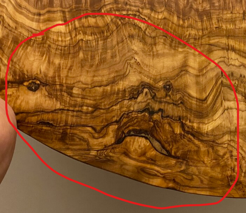

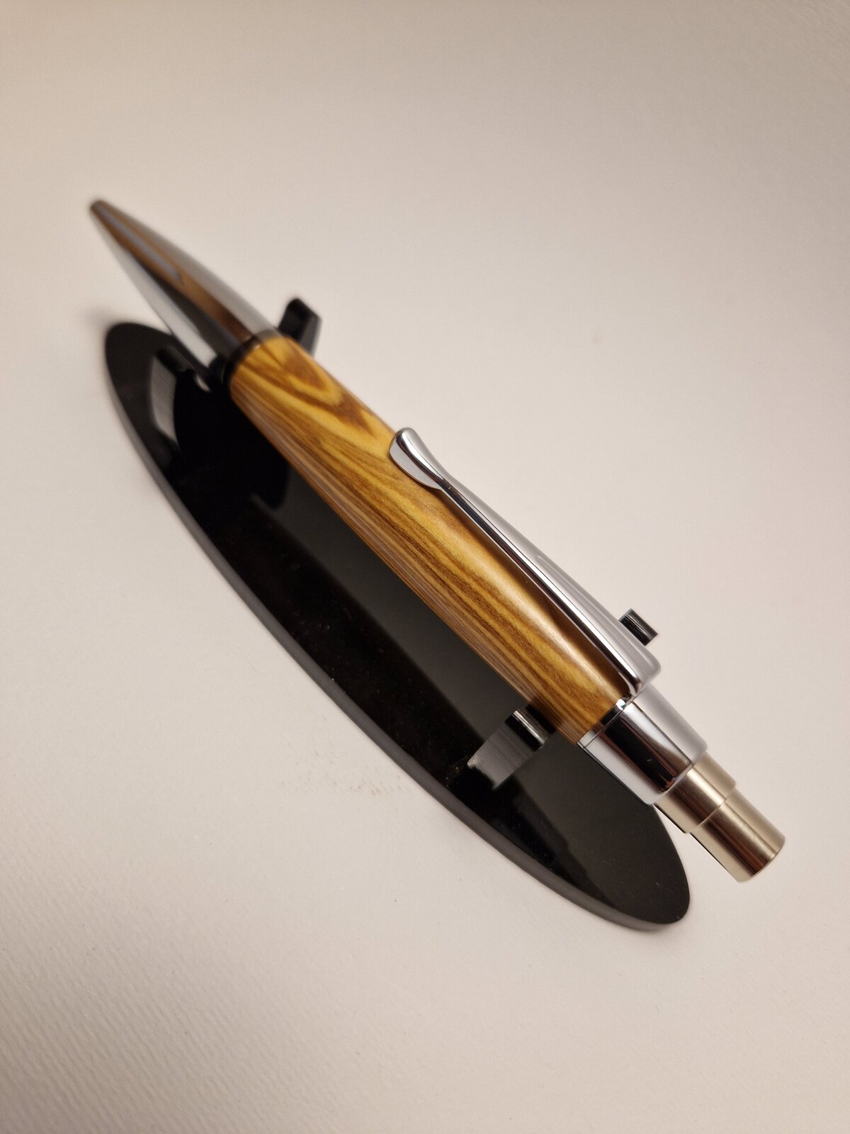

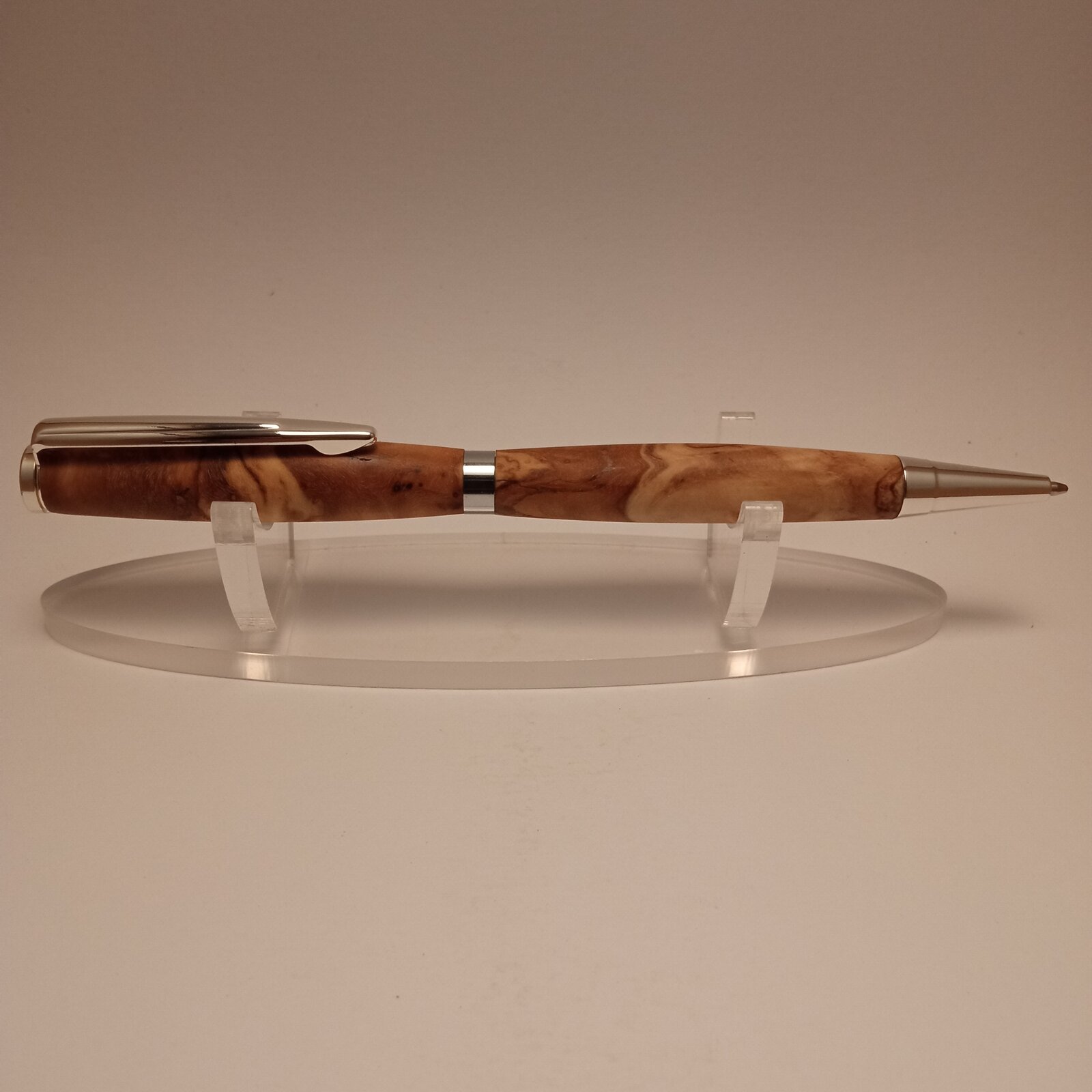

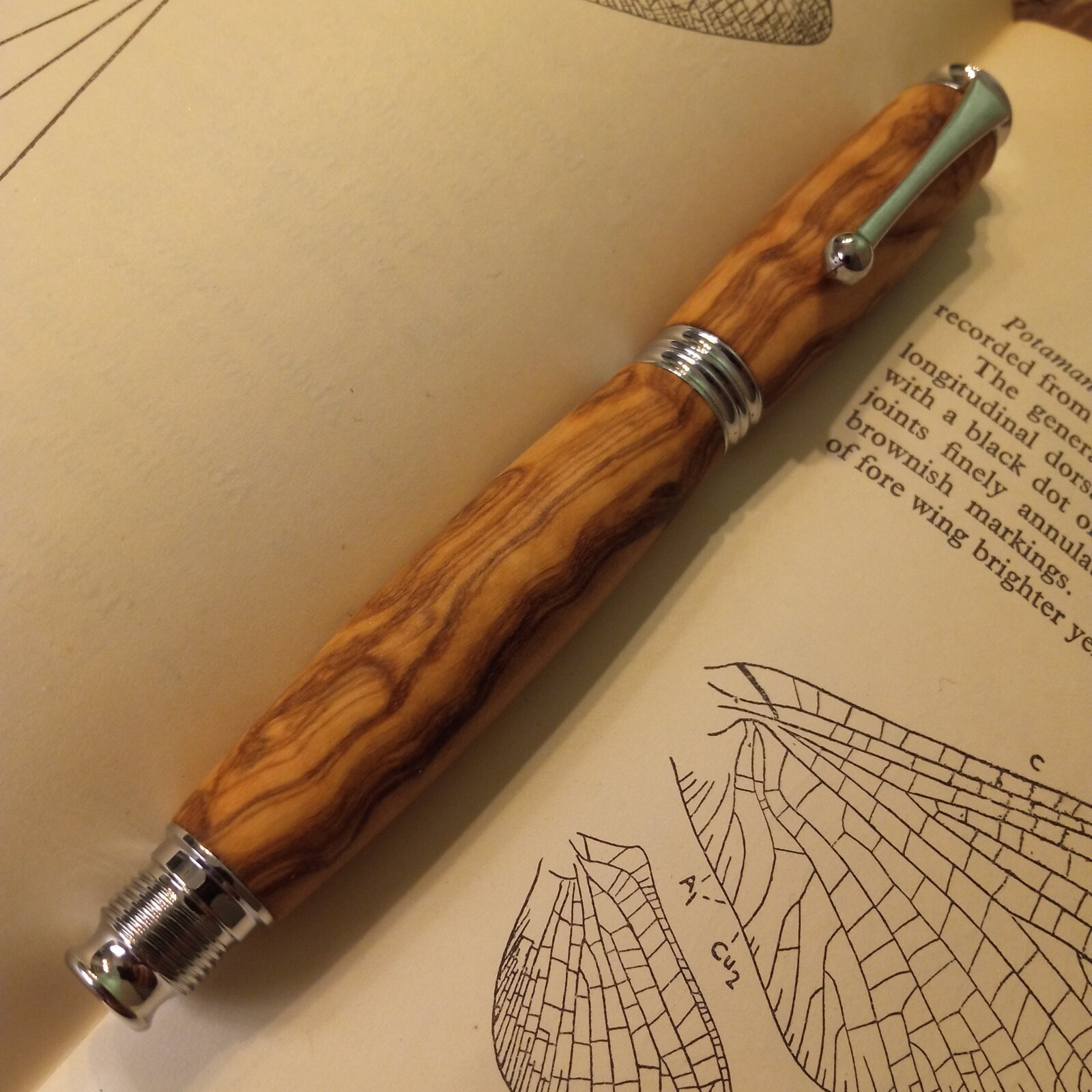

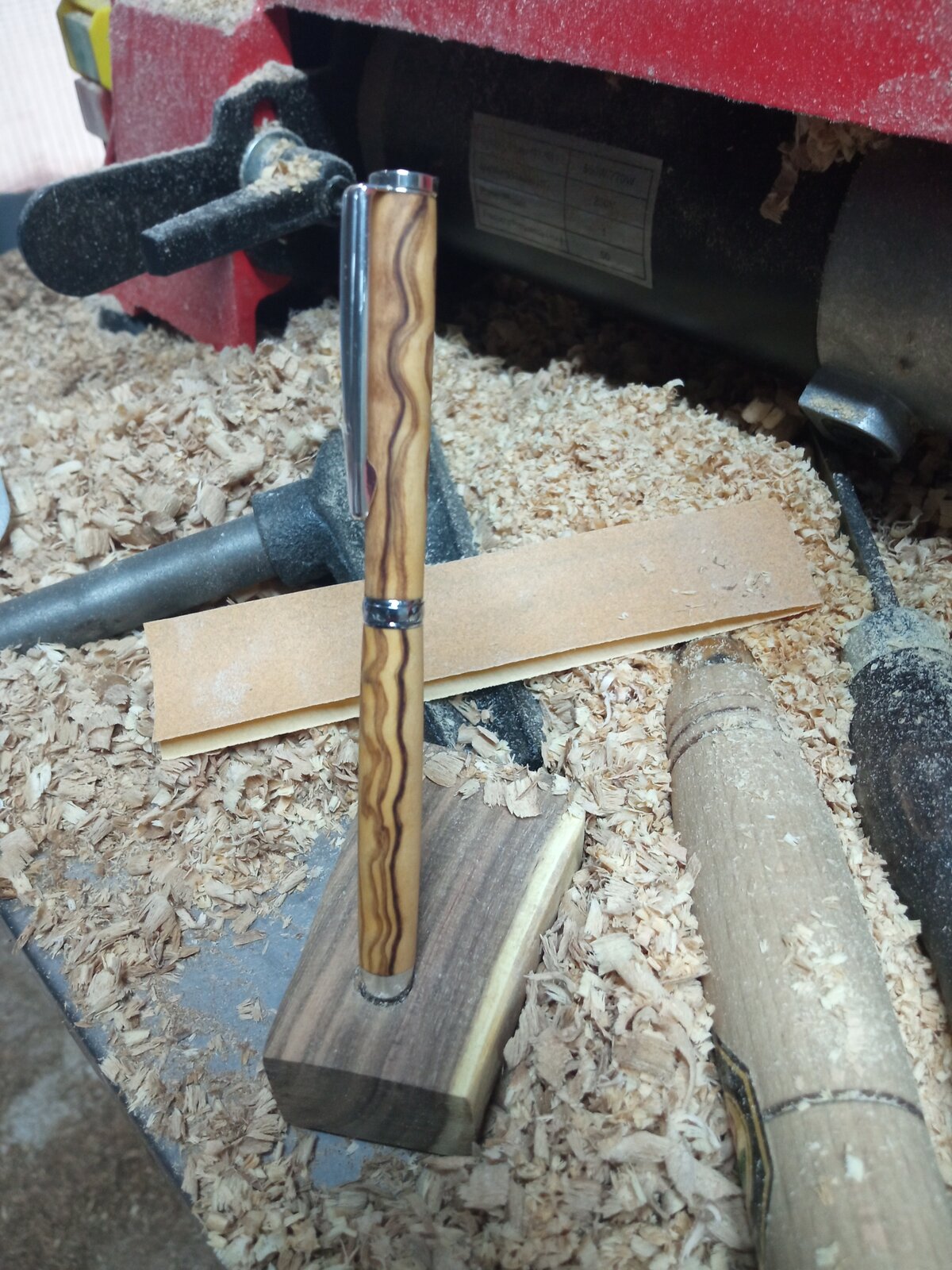

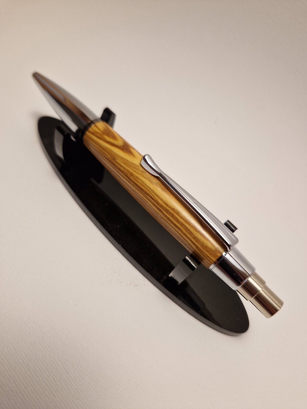

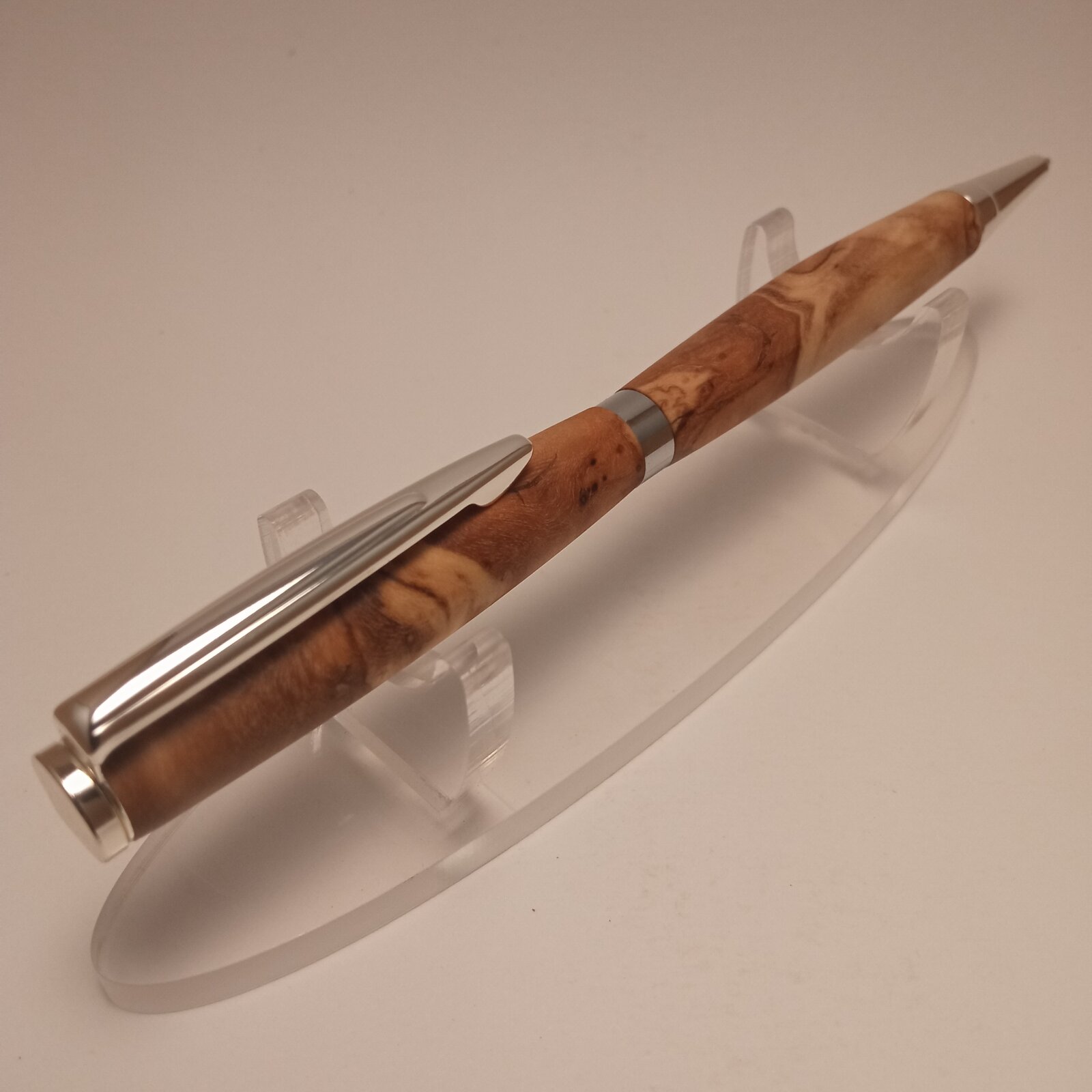

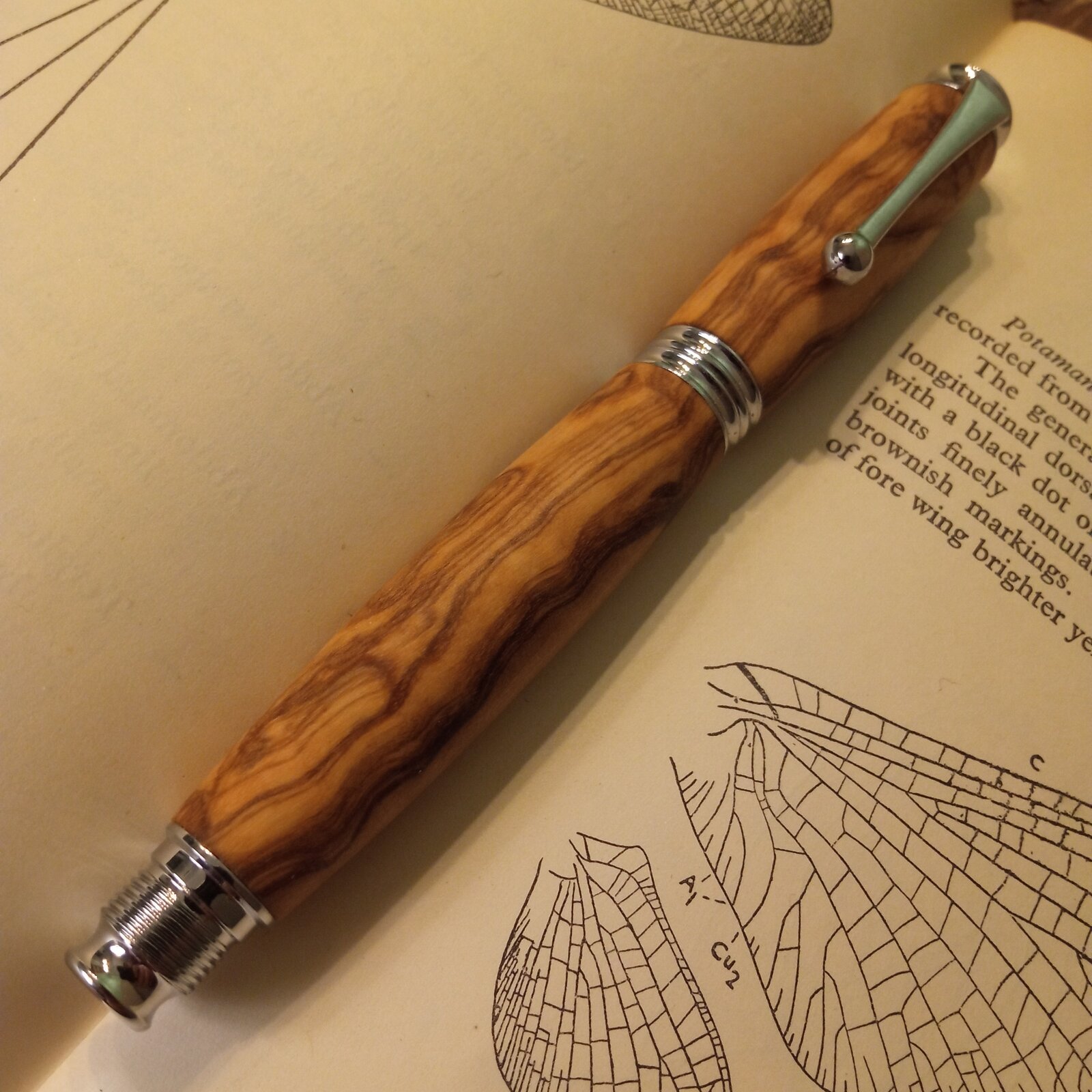

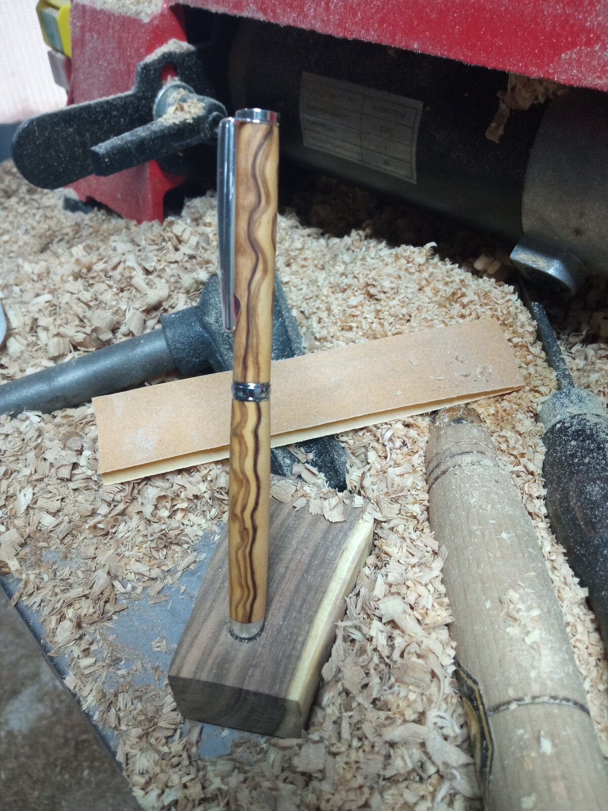

The centre of the board could be cut across the grain while the edges could be cut slightly diagonal. There is more waste like this but the grain is highlighted more like that. The part with the notch is a bit tricky but if you are willing to experiment with coloured epoxy or ca could make interesting blanks. Crosscut olivewood is definately interesting but noone is gonna recognise it as olive wood ( i dont know if it matters to you). Try to make "thick" pens so that the grain can be seen; no slimlines, i hope i helped, cheers.
The first one is made from slightly diagonal cross grain, the next two cross grain and the last one is almost 100% crosscut. I try to avoid 90° and straight (180°) cuts.

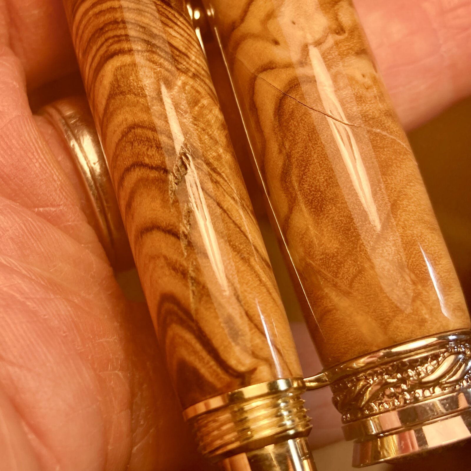

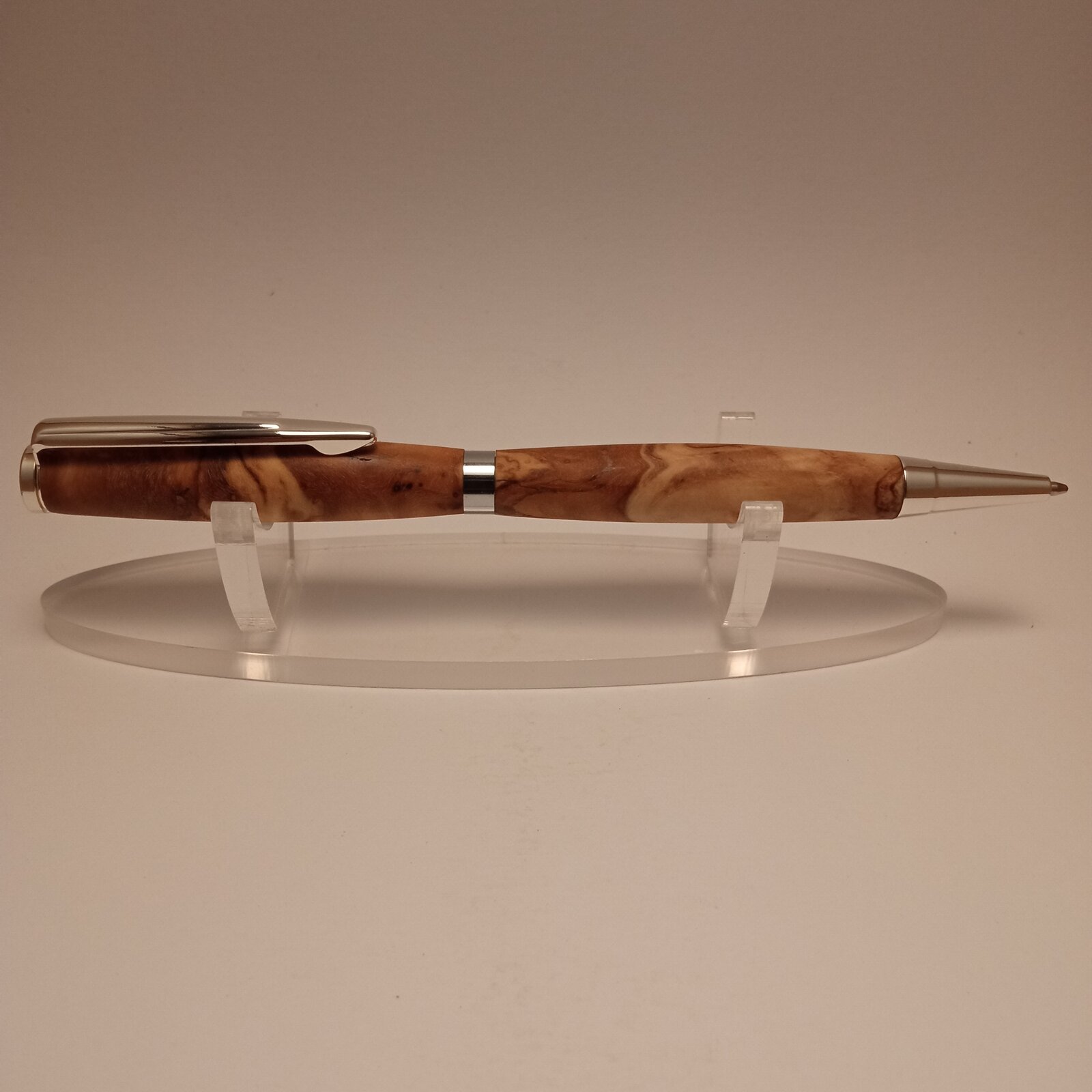

I don't want to pee in anyone's cheerios, but I've had terrible luck with these boards. I don't think they're properly dried, and they're rubbed with oil. The result is that the blanks crack themselves after cutting, or worse, after the pen is completed.
Of course, I bought mine at Home Goods instead of Trader Joe's, so your mileage may vary.
Bummer, that's too bad Todd. It was a pretty pen.
I just checked a few of the blanks I cut from my Trader Joe's board and am getting readings in the 7-10% range.

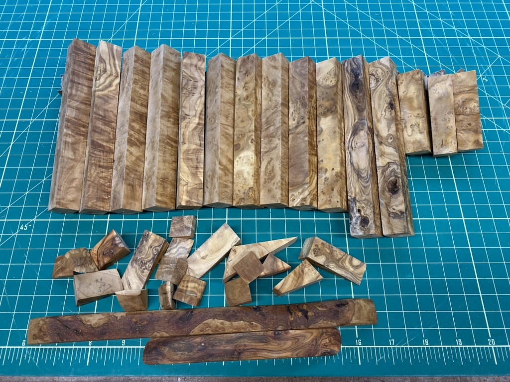

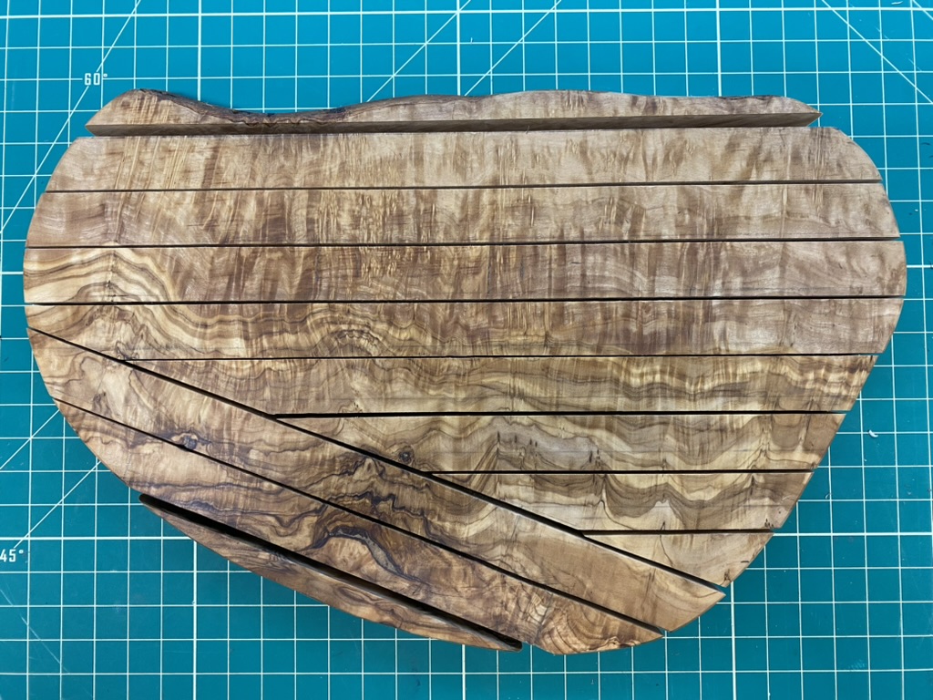

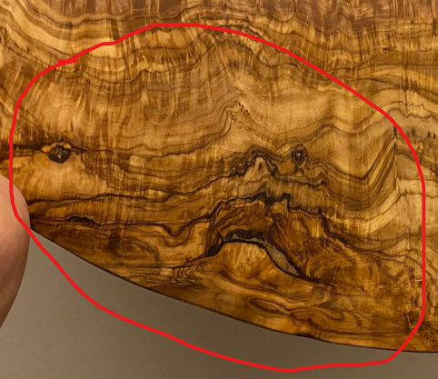

Here is how I sliced it up. I could have gotten a few more blanks out of it, but I really wanted to get two from that gnarly part in the bottom center. A little waste, but not too bad.
The two I was really working around will require some stabilization of a punky knot with CA, but I'm already working on that.

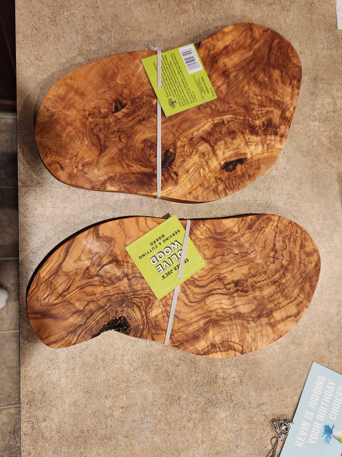

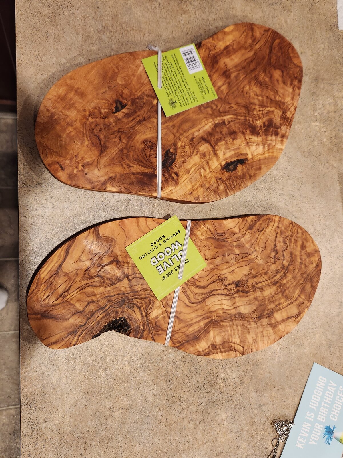

Got one each for me and another IAP member on Saturday! Hoping they turn into some good blanks
