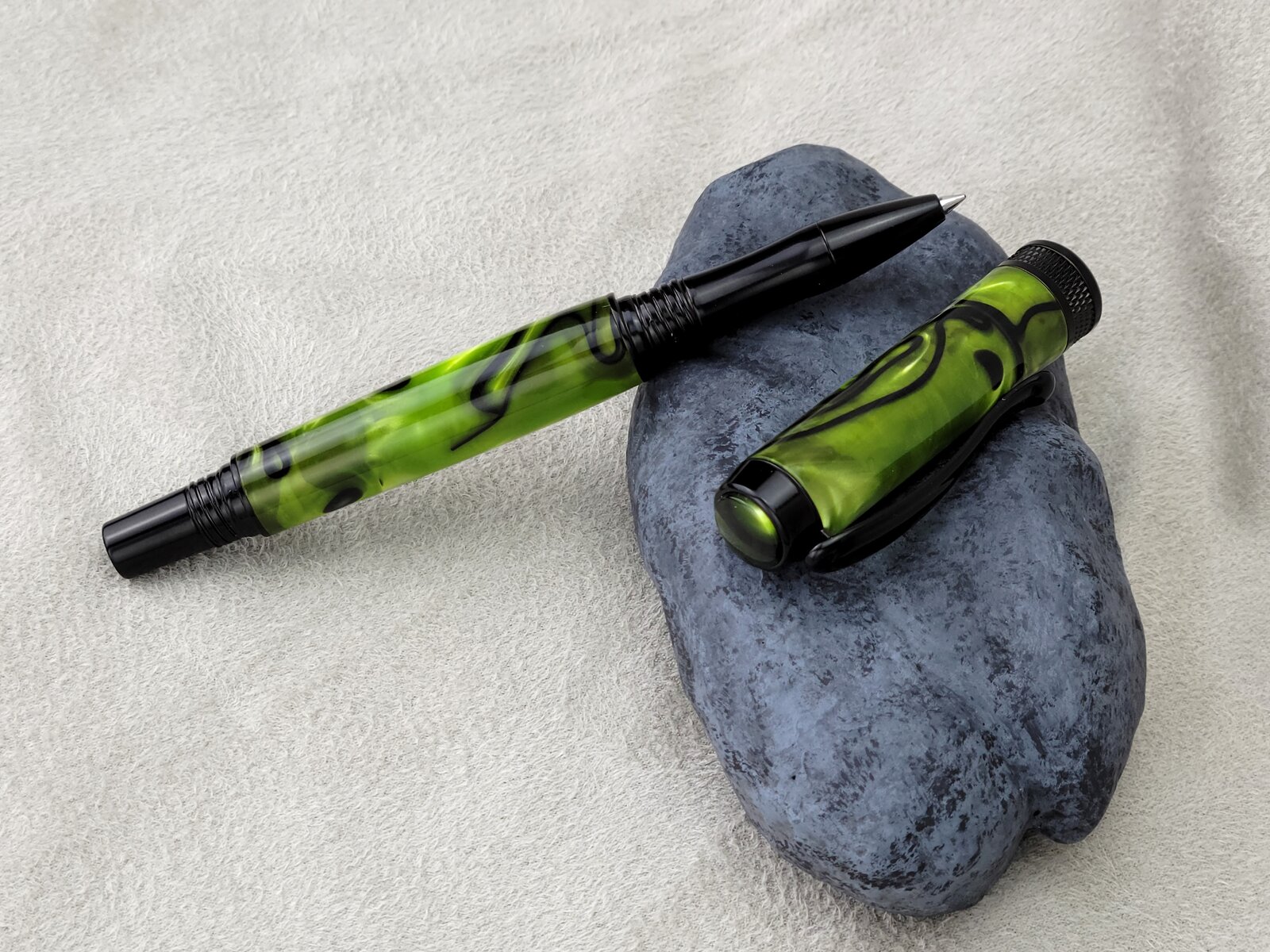

I love the way this pen came out. There are a couple spots on the blank that were a little more translucent than I would have liked, but it's still one of my favorite recent pens. The kit is a Diamond Knurl rollerball in black chrome. The blank is Toxic Green & Black Kirinite. Rather than paint, I just used Black Nickel tubes from EB (they come in packs of 5 sets for the Jr.s). The barrels were finished through the grits of Zona paper, then some Meguire's plastic polish. I'm not sure I see much difference with or without plastic polish, but maybe that's just my eyes. I'm putting the new "rock" to work in the pics, too.

so circling back on this pen. How do you make the finial top? I've hear some people call it a cabochon?
I epoxied the leftover blank to a scrap and turned it round. I then turned a small length of it down to proper size (I used calipers on the piece I knocked out to gauge that), domed it, and polished it. Lastly, I cut it with a thin parting tool down to where there is a little piece holding it on, then finish cutting that off with a utility knife. The little nub left will sit right in the hole that the other was "riveted" through. It's then glued on with epoxy.
