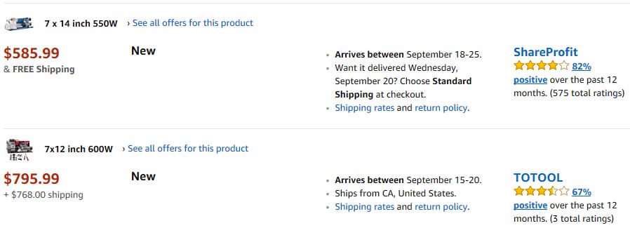

Nope, but did you notice the shipping cost???
This is what I'm seeing... The freight looks a touch steep.
http://www.penturners.org/forum/attachment.php?attachmentid=167708&stc=1&d=1505161103
Not sure how Amazon works, but my screen say Free Shipping right after the price, I've even added it to my cart and still show $0.00 for shipping. Location maybe?
I'm a prime member too - not sure if that matters.

I'm logged in as a Prime member and seeing shipping at almost as much as the lathe.
edit--now I see, the little brother has free shipping.
