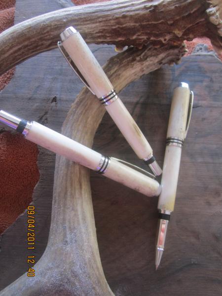

Hey again all,
Well I now have my first three pens in the box. They are all turned from antler. I was suprised at the amount of color variation even in the same horn. Makes it a bit hard to match the upper and lower tubes. I don't think I did too bad for a rank novice though. They are all smooth and have a high polish. I'll post photos next week. Thanks again for all your help.
Take care,
Dan

here's the photo of my first three pens. Not the best light in this photo.
Take care,
Dan

sbell111
Jan 16, 2008
3,465
Franklin, TN
Those are some pretty nice first pens. They put my first to shame.
That being said, my advice to you is to step away from the lathe and go buy a boat. It's cheaper.
