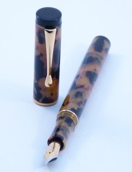

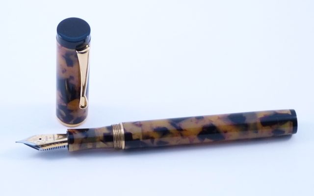

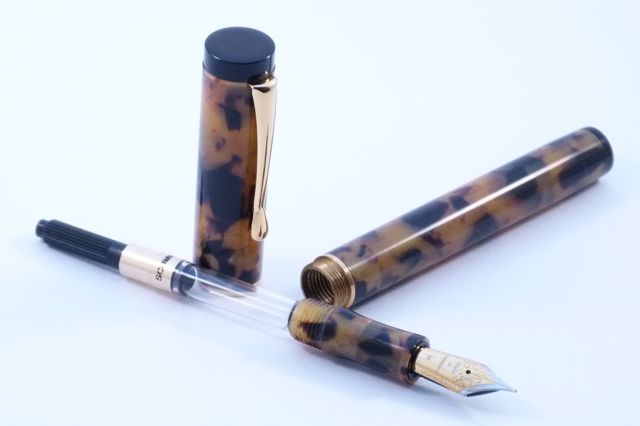

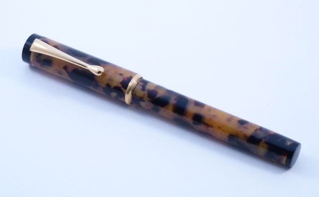

Tortoise resin from WoodTurningz, #6 medium MeisterNib, in a Parker/Bean style. :-) Simple black acrylic finials. I chose not to add additional trim rings - didn't seem to need them. Brass coupler is gold plated. (I seem unable to make any two pens the same. LOL)
Length, uncapped: 135 mm
Length capped: 145 mm
Barrel diameter: 12.9 mm
Cap diameter: 15.5 mm
Cap/barrel threads: 12m x .8 triple start
Section/barrel threads: 10m x 1.0
Finial threads (both): 10m x 1.0
Weight: 28 g
Thanks for looking in.
Roger

Great looking pen. Are you using an El Grande section/barrel threaded coupling or did you make it yourself? Is it glued in or are you using a tube. Thanks for sharing?
Tony
anthonyd
The threaded coupler was machined from brass with a fairly long sleeve that fits closely into the barrel, and the other in the cap. The sleeves are plated, then they're epoxied in.
Roger
Say, your good work reminds me that I need a source for Tortoise blanks. Any suggestions are welcome. Love your work.
Whoops, wait, I went back and re read your post. WoodTurningz. Got it.
Beautiful Pen Roger!! I think it looks great as is and agree with you not adding other accents. Excellent craftsmanship! Regards, Doc:smile:
