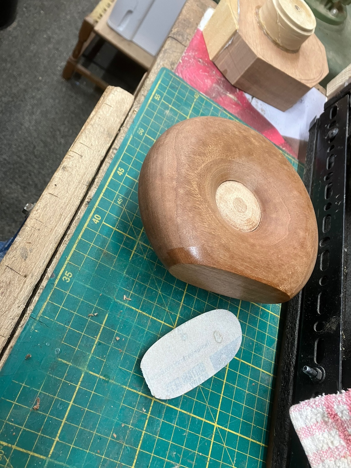

I've now modified the production method by using paper joint split turning technique . This allows faster turning and easier sanding of the pieces.89761F96-3BAF-4CB7-98A1-98616E96B699.jpeg These two have mdf laminated on one side . You curve one side externally then drill through the centre from that side . Once the hole is drilled then mark-up to leave a 10 mm parallel section in the centre . I then made a stepped mandrel with a tight fit on the 40 mm hole and long enough to reach the far side of the 10 mm parallel hole . You can then see where your curve must end internally . This makes it far easier to turn to.
You can then tap it off the mandrel , reverse it , checking again the mandrel just reaches then end of the 10 mm parallel section, and turn it. I found it helped to turn the mandrel face abutting the toroid until it reached the line.

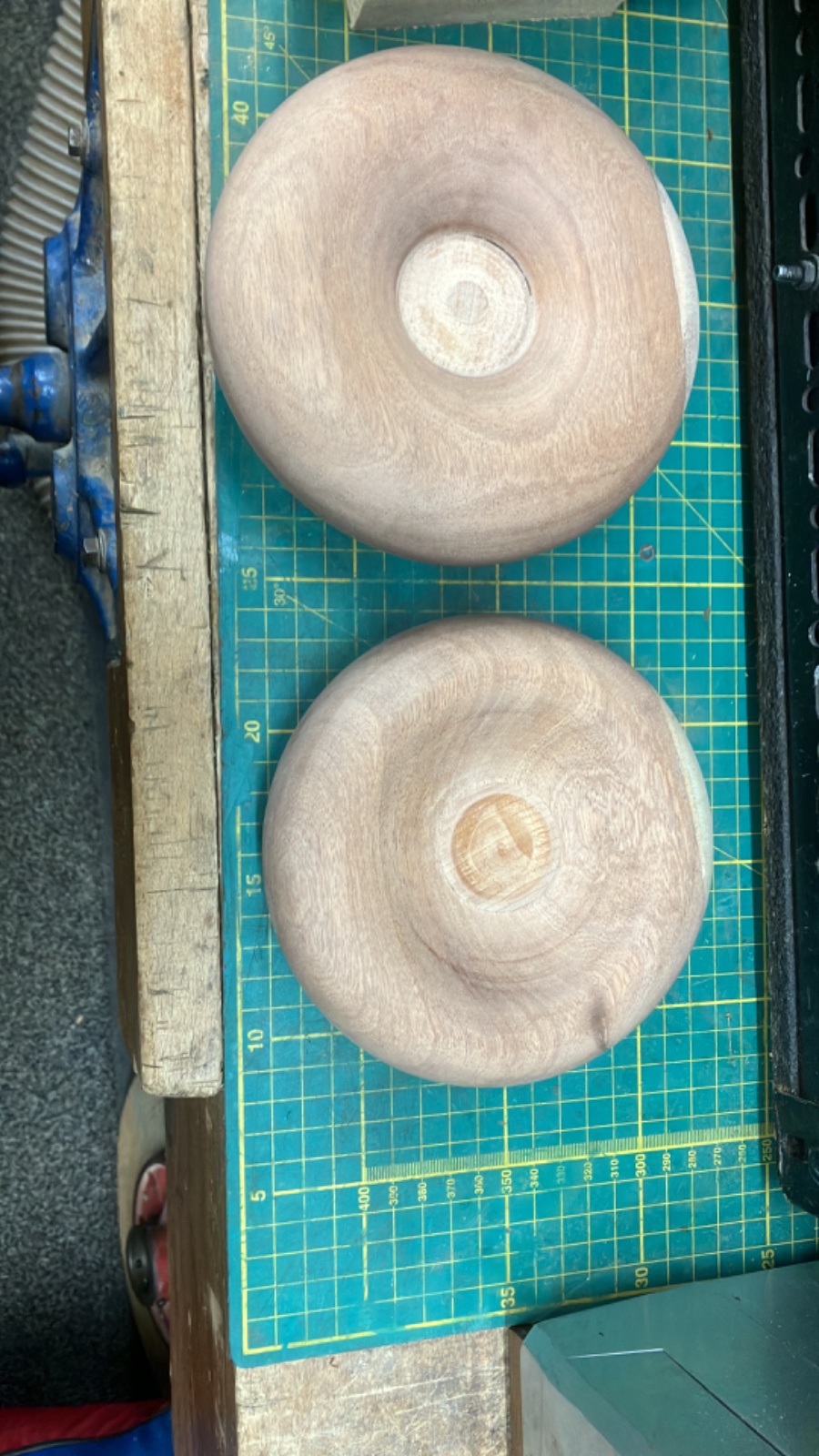

BBC46594-1018-4851-878D-017EF739180F.jpegYou then use a wide chisel and hold it firmly on the bench or in a soft jaw vice . Invoke which ever norse god you choose and tap it firmly and the paper joint splits as per photo , although please note the work face HAS been scraped and sanded to 180 grit before sealing it. Before I thought to take this photo.
They have been drilled though but got no photo of that. I can do if anyones interested?
i will then use a small drum sander through the centre and some abranet to round over the 10 mm parallel area once I tap out the mandrel.
