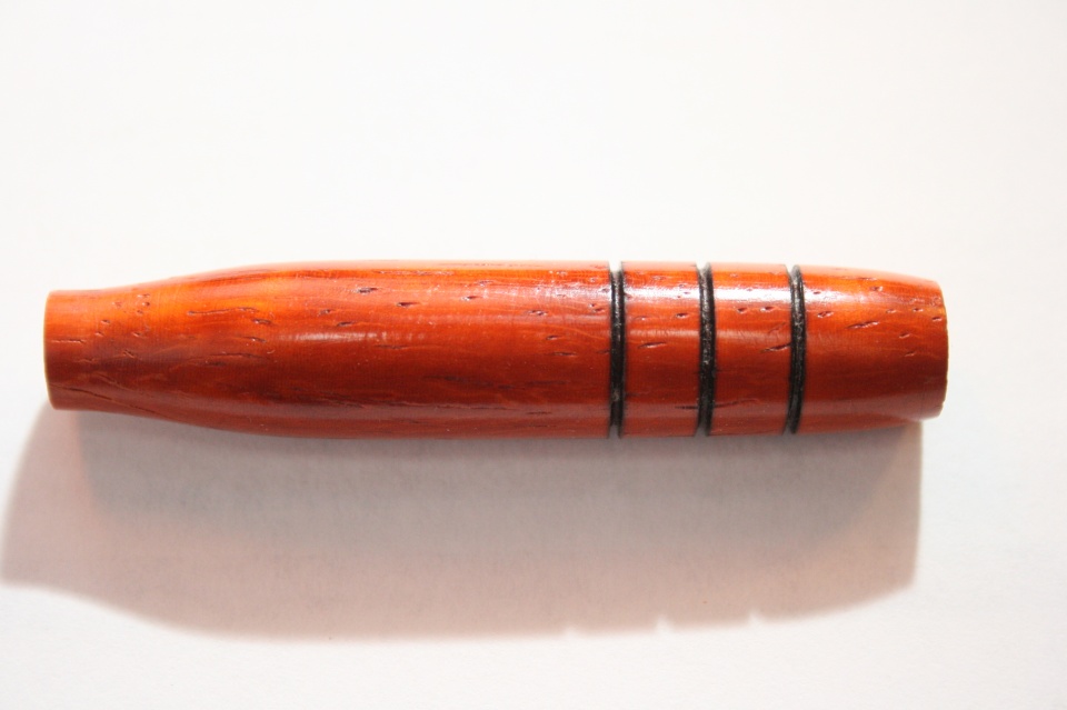

Hello everyone
I hope everyone had a nice thanksgiving. I got a chance to try my hand at wire burning this afternoon. KenV was nice enough to send me some wire he had, it arrived yesterday. I used two pieces of dowel rod as handles and using a scrap piece of paduck tuned it down to about pen slimline size and burned 3 lines. It was much easier then I though even with out cutting a grove. How I need to try it out on a few pens.

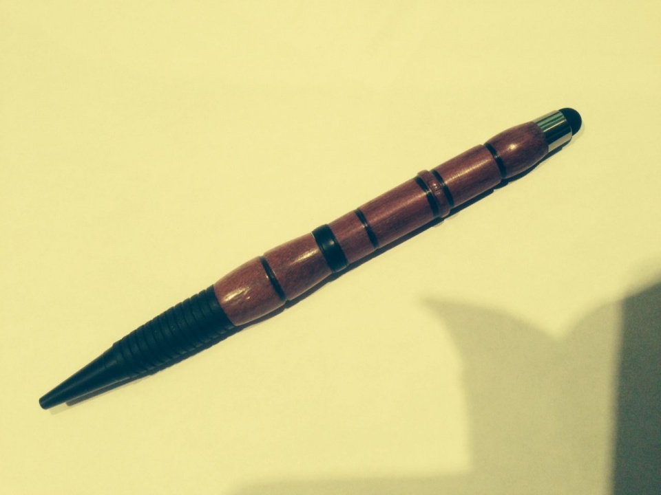

I use a tool to groove and then use Mitchell's abrasive cords. I might go through a couple of pieces but I won't injure my fingers.
