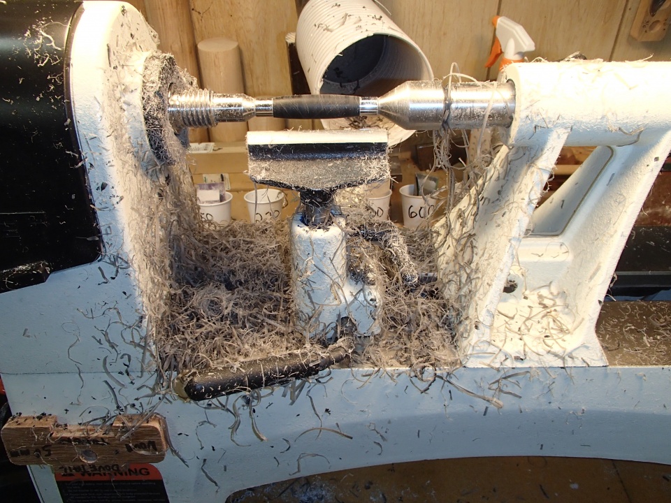

Lately I've been using 2 hss tools and leaving my carbide tools alone for the plastics. Most of my turning is with a Packard 1/2" roughing gouge. It gets it's edge freshed up on every blank with a 180 grit cbn wheel. Then I fine tune the shape with a negative rake scraper I made from a small 1/2" curved skew chisel. I got lucky with several inlace acrylester pen projects with this combo so I just stuck with it.
