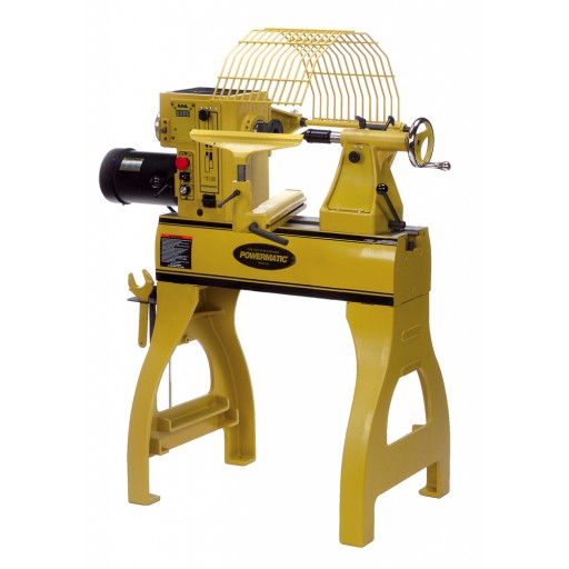

I apologize for not being clear. I was talking about a Powermatic P3520 lathe. My P2020 has the same profile, but a shorter bed. My lathe is pictured below.
I am looking for ideas for storing turning tools either under the bed of the lathe or on the ends with some sort of add-on rack.

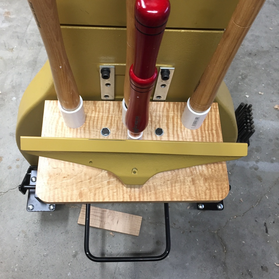

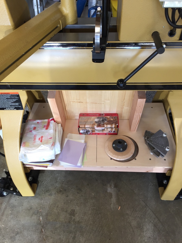

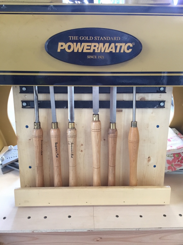

My tool storage solutions
Thank you all for the suggestions and photos. I have just completed getting my lathe tools stored on my Powermatic P2020.
As you can see in the attached pictures, I first did an outboard tool rack, which will hold my larger tools, one that is not ferrous (and therefore won't work on my rack that holds the tools with two magnetic bars), and the large tool rest that came with the Powermatic.
The second and third pictures show the way I made storage for my other turning tools, behind which there is a place for odds and ends.
I think this will fill my needs quite well.
Your thoughts and comments are most welcome.
