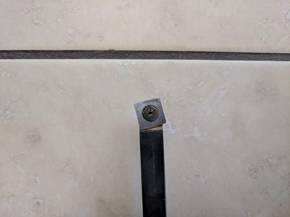

I did a lot of research into a versatile first tool: it had to work effectively, of course, but more importantly fuel the love for turning. Didn't want a tool I had to babysit, you know? :) I ultimately decided on a radius carbide tip with the blade secured at an angle. The rounded square shape is very forgiving by comparison to a straight edge, and the "corner" can be used for detail work that the round carbide cannot. Got this one from PSI because it fits well in my smaller hands, but any one will do. I've been very happy with it.

So I got her two carbide tools a round one and a square one with rounded edges. ( thanks for picture) and the mini glaser set. Thank you everyone for your input. I have a full set of turning tools but wanted her to have her own set for her smaller lathe.
