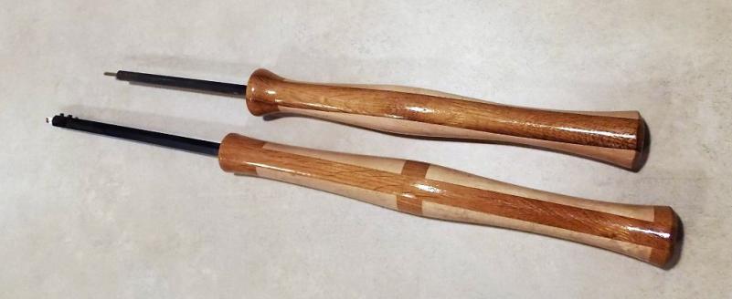

I'm partial to these! Possibly shorter than some turners would like, but they suit me just fine.
attachment.php
My only change if there ever is a next time would be a slight lump coming out from the hosel.

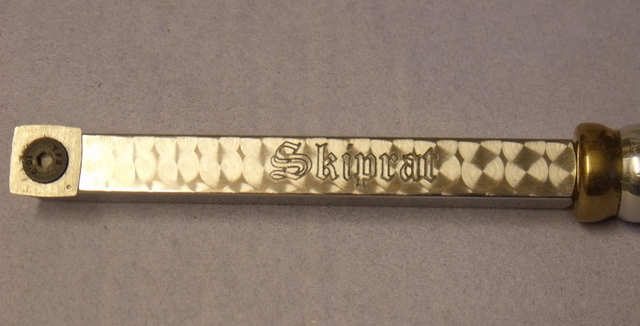

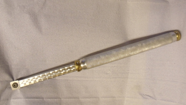

Eat your hearts out!!!! :biggrin::biggrin: Custom made, personalised, engine turned tool by Rick H ( at the request of some friends :wink:) and handle by moi. Solid knurled aluminium and with brass ends.

Are you sure about the origins? From the looks of it I could have swore that it was the mystical carbide cutter that was protruding from burl for years and years and during that time pen turners from all over would come and try to pull it out, but to no avail. You see only the true king of the pen turners could remove the tool from the burl.

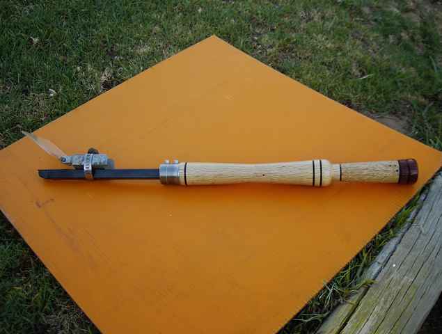

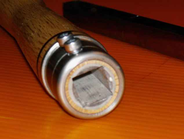

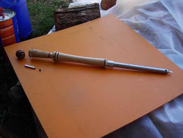

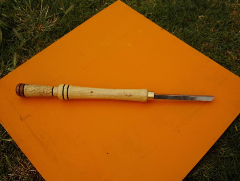

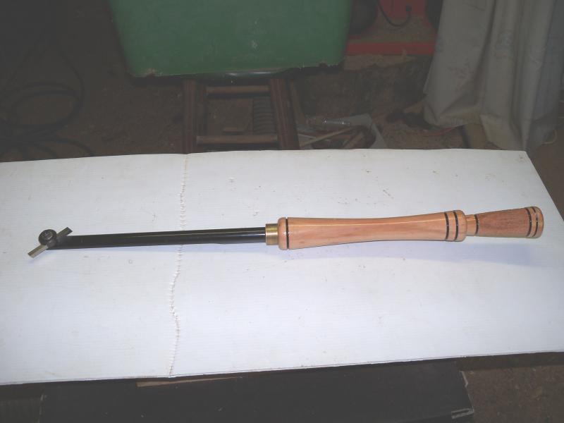

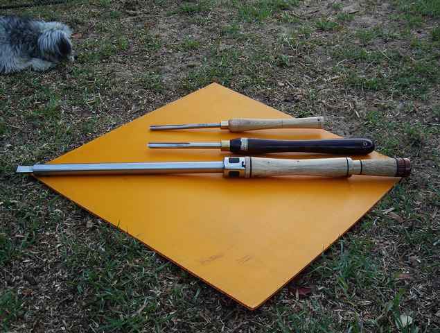

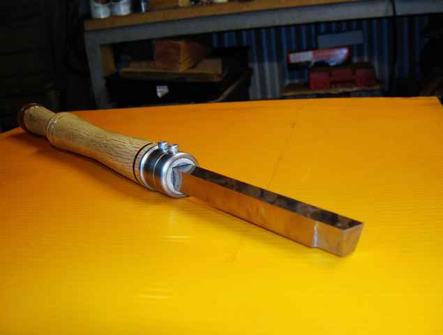

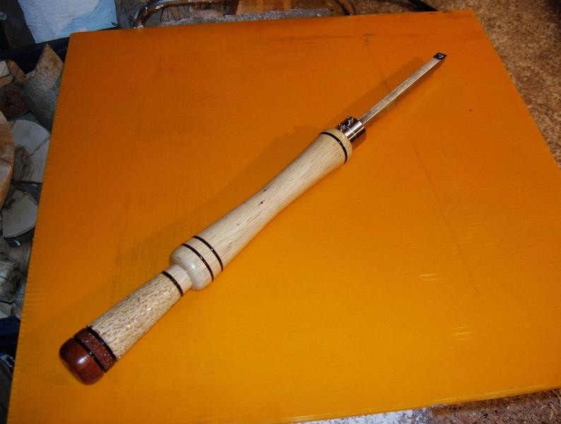

There are certainly a huge variety and shapes of tool handles, in my opinion, is no reason why one can't have pretty handles in their tools, they may be as functional as the ugly and plain handles but, they certainly look good on the board/rack...!
The design I use is not mine, there is the general shape however, I've added lots of modifications that do not compare, nor even close to the original shape inventor.
Most of mine have the tool shaft that can be inserted on either end (double cutting tips), have the surface touching the shaft, bedded with rifle bedding material, 2 wood types and a hollow handle to keep some spare cutters, screws and helen key, all in there, handy but not absolutely necessary, I admit...!

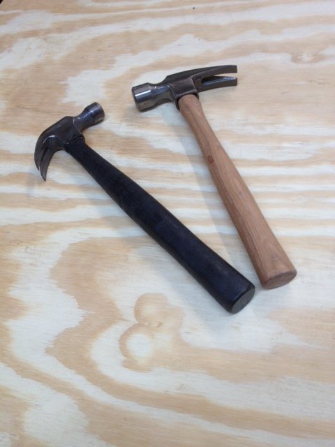

Since it is not possible to buy a replacement hammer handle at HD or Lowes I came up with these. Proud of them but they are not made for show:smile:

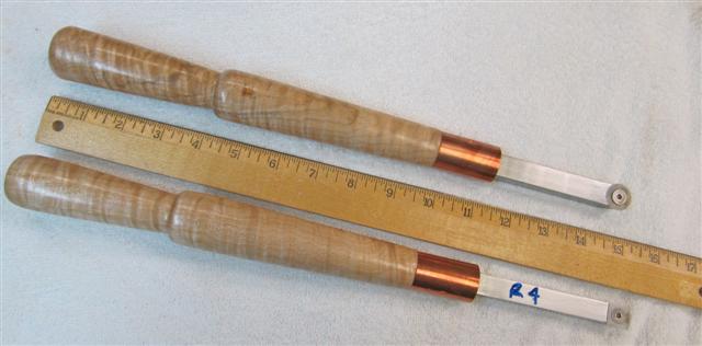

Her's a couple I made a couple of years ago, maple and red oak. There's a hole and slot in the bottom of the handle with a little magnet glued next to it to hold the hex wrench so I can find it when I need it.

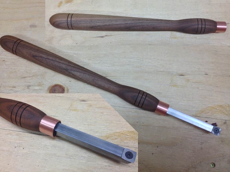

I made these two yesterday and today. The file handle is padauk 4 1/4" long.
The carbide tool handle is walnut 15" handle and 19" overall, 1 3/8" round at the large points.
I sanded the file handle to 240 and felt it was a little too smooth so the tool handle I sanded to 150. Both are finished with walnut oil and used copper pipe fittings as ferrules.
