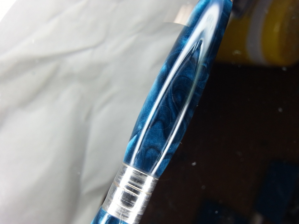

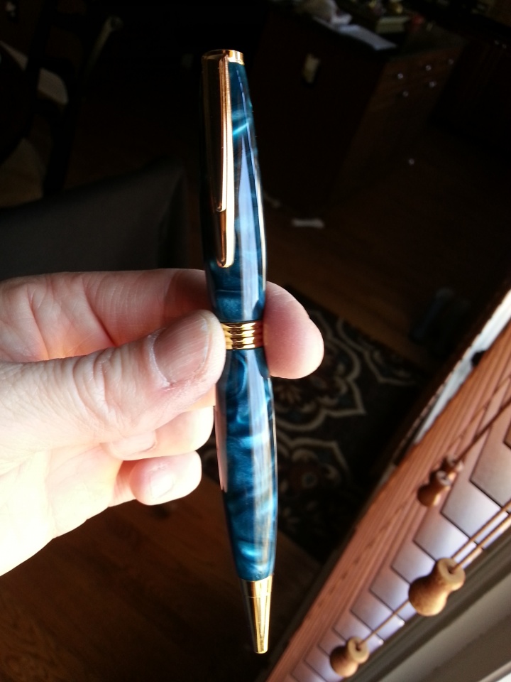

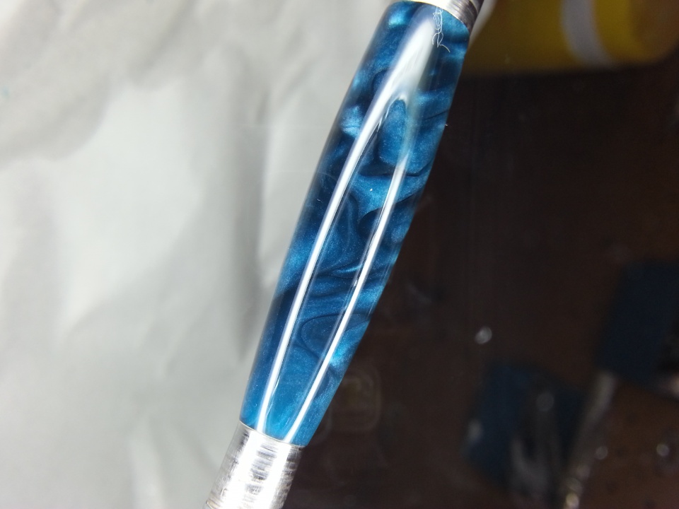

Well, I took he best advice (as least as how I was applied to apply the advice), from the kind folks of IAP and added my own experimentation. I produced a 99 to 100% scratch-free finish -even with solid black. I repeated this process 5 times and it worked flawlessly. It also uses less materials and no buffing. If you would like a copy of it, I would be happy to send to you in a Word document. I thought it was a fluke, but 5 times with solid black and dark red blanks is no fluke. Some of you will see your advice in "my" process. I am about to use make a pen now. The finish is remarkable. Remember, I have only used this on AA pen blanks. Thanks to all of you who have offered your advice.
Be blessed,
Tony
"Tony's" Acrylic pen finish
Here's everything including some pics. I do not touch it with any buffing wheel.
I photographed the finished pen not under magnification, but in bright light help at a angle to show any scratches. The ones on the mandrel are magnified.
I did this with two solid blacks and two solid reds too - but no pics (sent as gifts before I photographed them.
Let me know if it works-out for you.
And thank you all for your selfless input!

Thank you. It was more like "migraine" (LOL) than magic. The two separate two coats of the 105 really make the biggest difference.

Rejex is formulated to last a year on a car in a garage. I actually find almost as much brillance after the secong application of 205. Also rejex can be applied aftee every twelve to 24 hours. When I use on my car, I apply 3 coats. Each coat adds depth to the shine and durability. This is a good point though. How is this dealth with using diamond dust, blue rouge, etc? Lastly. Rejex doesn't remove scratches, do I guess you can do what you like after the 205. Your thoughts?
Well with buffing the shine is there because of the absence of scratches on the plastic. It would dull after heavy use.
The wax would fill the scratches making a smooth surface that is really brilliant. I have just been worried in the past about it wearing quicker and wearing off the pen after heavy use.
I guess I have never taken the time to test either method. It would require me to have enough patience to wait for a year for results. :)

Thank you Harry. As you probably know that Meguiars uses a numeric system to identify its professional line. What Meg tolds me is that the only difference between their pro line and non-pro line is the flammability of the product. Their pro line is designed for working in an auto body shop. Therefore what you are using and what I used may be the same thing in terms of scratch removal. What I like about their pro line is that it is easier to determine the "aggressiveness" of each product. I do start with the 205, but find myself going to the 105 (2 apps), the 205 (2 apps). Perhaps as I get better (I think I am at 30 pens), I won't need as aggressive products. I do like not having to use the BG buffy system (I only have one lathe). And not having to go beyond 4k on the MM. We will see. I am penned-out for today. I did sell my second pen which again is not why I am doing this. I didn't think I was going to find such nice people either! That has been a big plus. I also fly fish. I have found few willing to share their secrets with me. This has been a great experience. Take care!

The Meguiars 105 & 205 have oil, silicone wax in them to temporarily cover up scratches. To see how the pen will look after some use wipe it down with some rubbing alcohol. The ipa will remove the silicone/oils and show the actual finish. Hope this helps.
Thank you. I will test it out the next time I finish a pen, but before assembling.
Naturally, I couldn't wait to try to reveal the hidden scratches, so I applied 4 applications of IPA (just in case the Rejex was creating some type of physical or chemical barrier) using a paper towel to my son's solid dark red acrylic pen and removed the 105, 205 and Rejex (at least I think I removed it). I still could not find any scratches (doesn't mean they are not there, I just couldn't find them under magnified light). The 105 and 205 products claim to remove fin scratches, not fill them (Meguiar's could claim they cure warts....it's just a claim and I have no idea what they really do). I did pull and attach their MSDS sheets and look up each listed ingredient and quite frankly can't tell if it these are "fancy" names for wax and silicone - I definitely wouldn't pour it on my pancakes :-). Any way, whether it fills them, removes them or causes my eyes and mind to believe they are not there I am going to stick with it until my skills improve. They know me on a first name basis at M's, I will call them tomorrow. I am curious. Thanks again for the heads-up!

I think scratches are there in all our pens. It is how fine we make them that makes them disappear. Everyone has their own finishing method. Glad you found yours.
