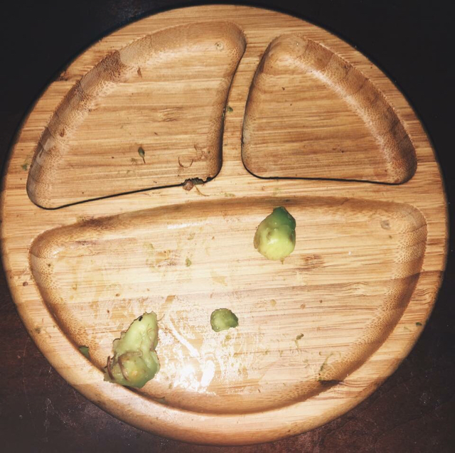

How will you make this?
Sent from my iPhone using Tapatalk
Something I did a few times years ago.
Turning the plate in the lathe is straight forward
Recesses can be done a couple ways
One way is hand carving (I did that once)
Afterthat I used a template and a router to cut the recesses. Sanded the bottom to remove any small router bit swirls.
Hmm I can cut identical blanks, one would be the plate and the other the template in which I would cut the holes to make the template
Yup -- I had a porter cable router with a follower insert that fastened into the base and used a bull nose bit to cut around the edge (radius edge at the bottom and than used a straight 1/2 inch bit to hog out the center. The very center of the big compartment was a bit tricky keeping the router balanced but made a template for just the center and it worked well.
I turned the plate and put a large foot on it.
Will try that
