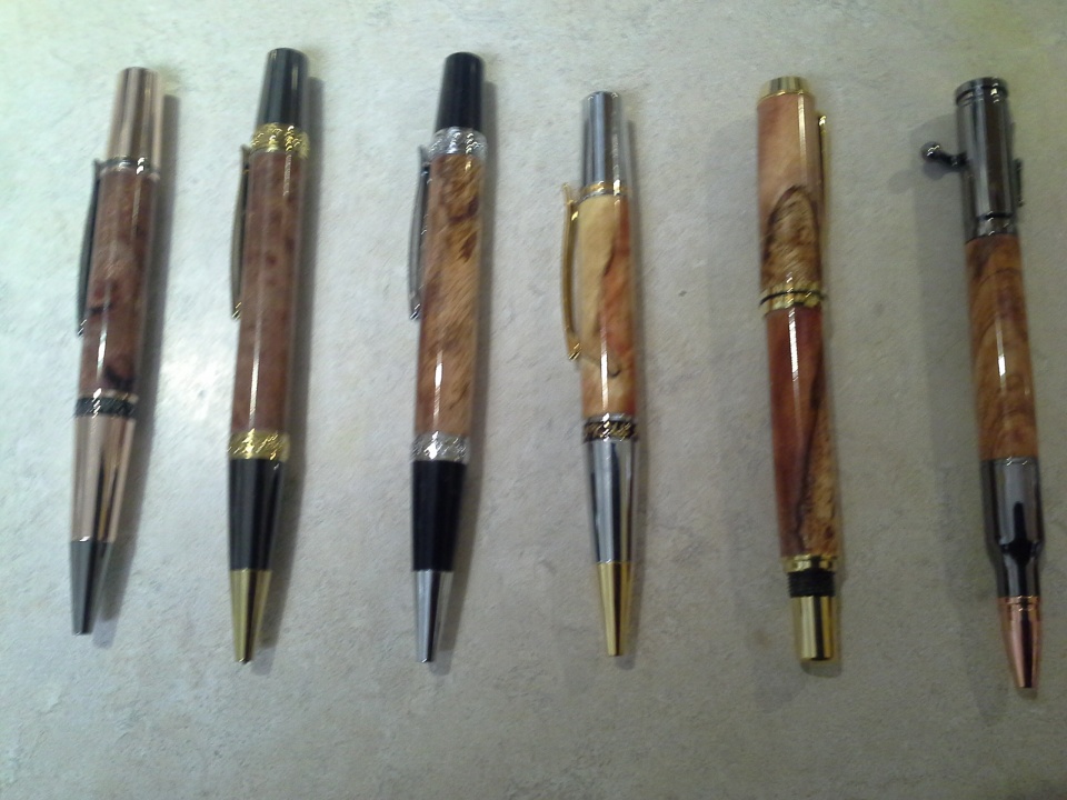

Bolt Action - Spalted cherry burl.
Navigator -Australian Cootamundra
Aero - Fire box elder
Le Roi Elegant lb -Australian Cootamundra
LE Roi Elegant lb - Redwood Burl
Aero - Amboyna burl
Thank you to several IAP members for blanks and to IAP for having so much information here. I have learned so much and I have a lot to learn.
C & C always welcome
Thank You
Andy

Andy, That is a Great Display of Pens,
The Blanks match the Pens Beautifuly,
The Fit and Finish looks Terrific,
What Finish did you use?
It is a shame that the photograph is not in Sharp Focus, it makes the detail of the pens "fuzzy"

G'day Andy,
I can see that you already have put to good use, some of the Cootamundra Wattle blanks you won on my last "question game"...!
Yes the pic looks a little blurry from thin end, not showing the pens right but, I can see what you've done and yes, they are all very good...!
I wonder if you could re-set the barrels position on that double barrel pen, I can see the "vein" being interrupted by not having it matched, being a "caped" pen they look better grain/veins matched with the pen closed, well that's my opinion, anyways...!:wink::biggrin:
Keep up the good work...!
Cheers
George

Hi Andy,
Excellent finish!! In step 6, you say that you seal the ends with CA. How so you apply it - just a wipe?
Would be great if you could post a shaper image!!
Thanks
Steve
Siric - I use thin CA, and just wipe the tip around. If I didn't say it, I lost a few pens because the end grain wicked up the water from the wet polishing.
Also, if I didn't say it, the Beall wood buff step is my way of getting rid of sanding lines. The blank comes off there quite highly polished. I have laid a few carpets in my day and seen what a small imperfection can do.

Really nice work Andy. Looks like you picked up the CA technique well. I agree with George. I think the Navigator is a triple start thread. Does it line up better on a different thread?
Are you uploading 800x600 on your pics? Don't know what else could cause the problem if your original is sharper.
Harry
I fixed the navigator. The barrel on the navigator is threaded on both ends. I thought had pressed the pen do things matched. After y'all pointed it out, I realized that I had switched end on the barrel when I put it all together.
Thank you for pointing it out, it looks much better fixed.
