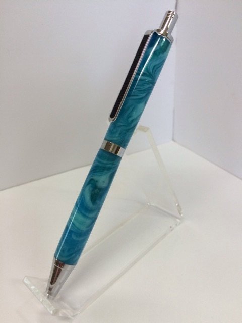

As a pen turner AND a pen seller, I often get into a situation where I think it good to offer a pen to someone at no charge. Lots of reasons. I'm sure this is no shock to you. But it seems that I only have my display case when I "need" to do this. It can be more expensive than I want it to be (I'm cheap). So I've been looking for a lower cost alternative.
I was hoping to find a click pen using a Parker-style refill and found the PSI Slimline Pro series and ordered some. Here's my second (LOML got #1).:smile:.
My observation: I am really pleased with this pen. It's an 8mm, 2 tube pen. Click style, pretty basic, but it's real affordable (the kit is under $5). Straight forward assembly, etc. The thing that impresses me even more is that it feels real good in my hand - and I'm fussy). Excellent length and balance. Not heavy, not too light. I'm thinking I may want to keep this guy as a (lower priced) staple in my inventory.
The only thing I would change is the clip. Don't like the black stripe. It'd be nicer all chrome, gold, etc.
My question: how about you? Have you done these? Was your experience good, too? If you sell, what is your price point? I'm in mid-Michigan and I'm thinking in the low $20's.

Oh, come on, Mal. Haven't you ever had someone do an "extra" for you and you wanted to do something a bit more than say "thanks"? Example: I was having trouble with my satellite dish. Called the company and they sent a tech out to see what what the issue was. He fixed it right away (in a pouring rain), was really nice about it, and even did a hook up on a different TV at no charge. Besides that, we are both Army vet's. So I gave him a pen. He was touched. That's what I'm talking about.
And the blank is from PSI. It's an acrylester blank called Healing Waters. Lots of folks here don't like that material (drilling can be a pia) but if you use real sharp tools, take light, light cuts and have extraordinary patience it can turn out really well. Glad you like it.

I've never turned that particular pen but I will tell you I don't sell any pen for an amount in the 20's. The last Comfort pen I sold was about 4 years ago and that was for $35. The components cost about the same as yours and the blank was wood.
Hope that helps.
From my experience the clicks on the Slimline Pros' that I did falied and I stopped making them (7 in all). 4 malfunctioned and wouldnt work anymore. Wall St ll clicks were a little better and the Stratus was most reliable (just dont drop it or you'll be gluing the plunger back on). For the price of that Slimline pro kit an off the shelf Parker click from Rite Aid was better quality and only cost $4.99. As for giving pens away as a thank you, surprise gift, or 'just because', I've done that plenty of times.

Ted, the PSI slim line pro is a nice little click pen and have sold several myself with out any problems or returns. The Compson is also a nice clicker as mentioned. The PSI Bot Action Tec-Pen is a nice reliable sort-of-click pen and seems to be a hit with my customers as well. I have also found that the PSI Chic-Line twist pen is a good seller, especially with the ladies. They like the light weight and the embossed cap seems to be a hit with them as well.

I like the slim line pro and have started modifying them as a single tube instead of 2 tubes. Bought 8 mm tubes and cut the blank to length adding enough for the center band(messed the first on up as I forgot about the band).

Ted - I agree with you on that black clip. :-(
I'm not into clicks, but I do make a couple of the aero click. Pick them up on a Csusa group buy. Makes a solid $40 pen.
If I want to make a giveaway pen, it's usually the executive. It's pretty darn inexpensive.
For me, a low cost pen absolutely must be a single tube pen. (Unless it's a friend / family member who wants something particular). Two tubes is double everything. Which leads to more $.

Ted, this is an interesting discussion and I appreciate your willingness to let us explain our experiences. The great thing is that no one is wrong - we all have different situations and experiences which gives good insight to potential issues. My experience is the Slimline Pro is ok but I prefer to only have a few around in case someone wants a smaller, lighter inexpensive pen ($35 for me). I have now done over 500 pens in the last 3 years and have not had any issues with the transmission. I have however redone 2 that were dropped and damaged. No big deal.

Ted, I do shows mostly in the Jackson to Kalamazoo area, I sell the slims for $25 to $30 depending on the blank cost. You might do just as well or better but YRMV
You can swap out the clips ya know.. they are the same bloody clip as a reg slim, you may have to open up the hole to seat on the finial but is nothing major. I like that small bit of black, if you have steady hand you can engrave it with logo.
