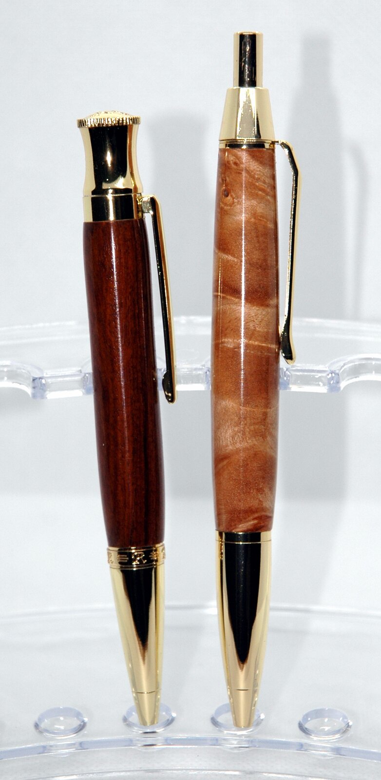

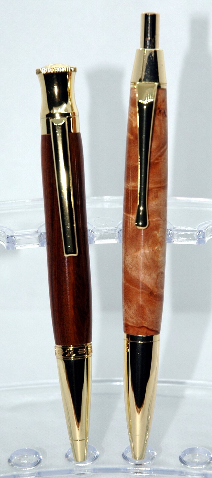

One Lignum Vitae and one Maple. The Lignum Virae cams from a sawn up Crown Green Bowl.
The finish Friction Polish and Microcrystalline was.
Please feel free to comment..

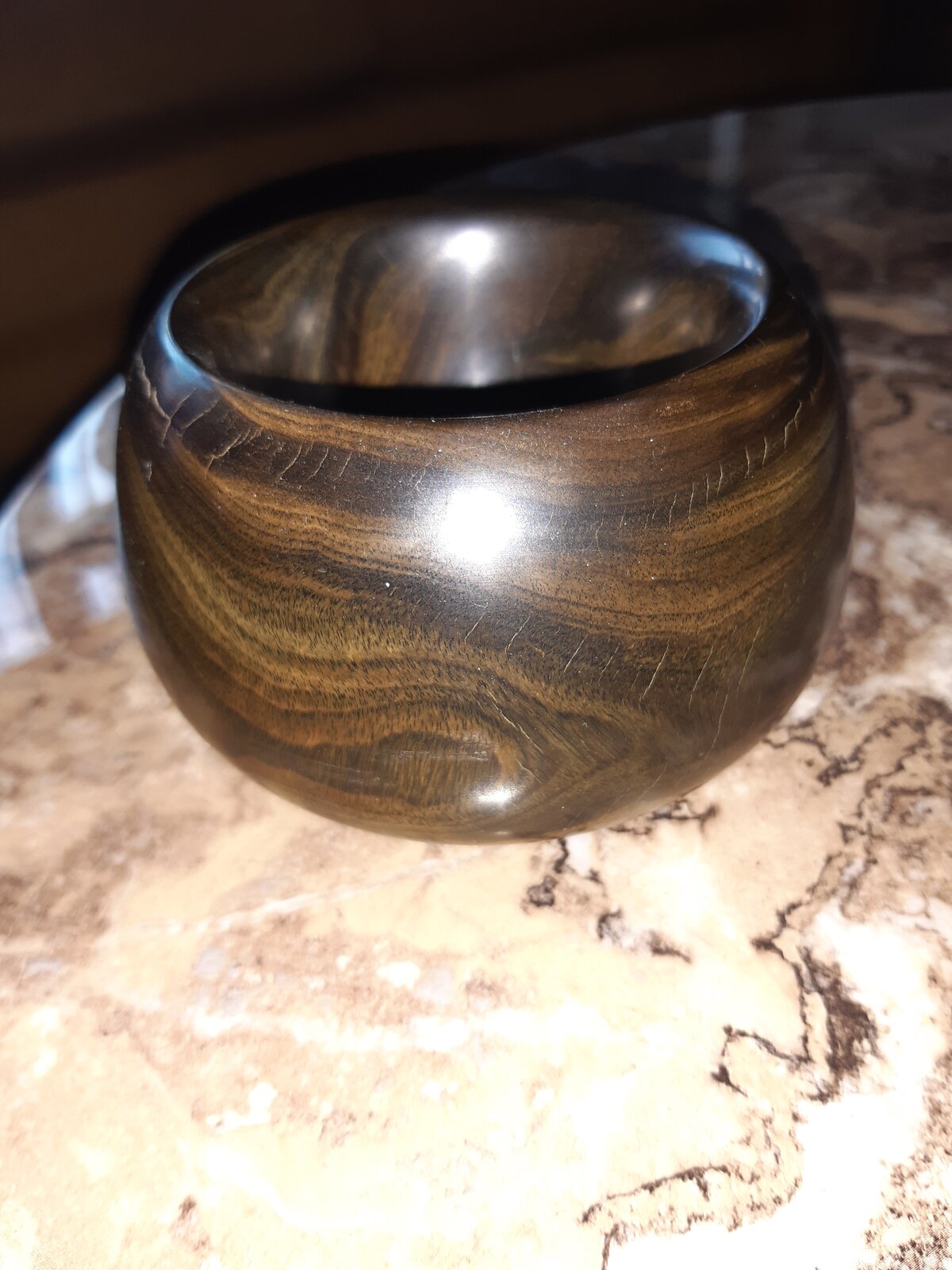

Alan I used my quite Small Bandsaw Basato 1 with a. 4 inch throat. So carefully cut it into sections a 6 tpi blade was all I had There's a lot of oil in this wood so blade clogging a bit of a problem lots of backing off required so cut slowly. A courser blade would be better.
Don't think the wood differs.
I have made small Bowls from bowls with great success ill post a photo.
Mike
