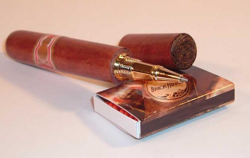

I finally figured out how to make the foot end look more like the raw tobacco. This changes the whole look. I think I'll go make more! :biggrin:

That looks great. Just got the ash end looking good. Any pointers or suggestions in how you do it? Inquiring minds would love to know!
Nice. What kind of wood did you use for the body of the cigar? What finish did you use? Thanks for sharing.

I think the wood is a redwood burl and I use CA on all of these.
The finish is done much the same and a pen that gets a high gloss but they are buffed to a matte finish at the end.

Basically it is an insert, as noted by Dan. I used strips of brown paper and stuck wood shavings to both sides with contact cement.
Roll it up and by gosh it looks like the tobacco end.
You will have to experiment on your own and figure out the details.:biggrin:
