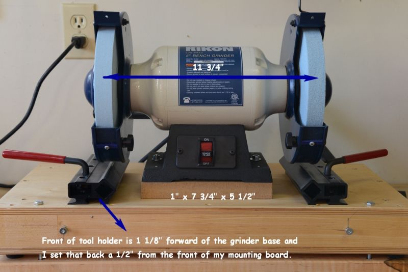

Remove the feet no matter. The crucial measurement is the centre of the grinder wheel s/b 6" - 6½" from the base. If it's lower than that build up with some plywood etc. I had to provide 1" to bring mine up to that measurement.
This is a pic (not my grinder etc. but identical to mine) of the wolverine in it's proper position!
